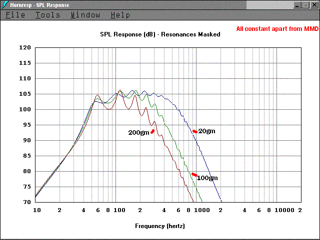

Attached : different moving mass. See ripple in band.

Mike's example shows what happens when horn and driver are not working properly together, allthough a 8" driver
with moving mass of 200g is not something one would realisticly use as a midhorn driver.

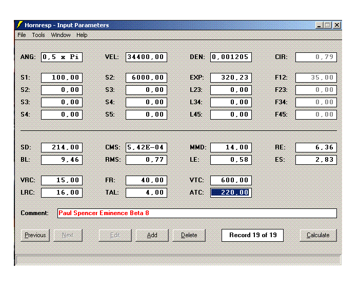

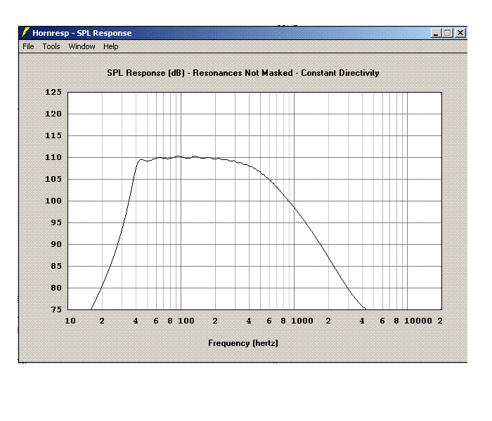

The biggest problem I'm having is IMO "compression ratio!" The designs seem to call for a very small throat, ie 10% of SD, which is a compression ratio of 10 right? As far as I'm aware, this is too high! Make it closer to SD and the response is no longer flat! :smash:
How high can I go in compression ratio?
What are the problems if I go too high?
Huh?
SD on the Beta 8 is 214 and the throat in the example is 100. That's not what I would call high compression ratio.
cheers 😉
Jan, I was referring more to the results I get from the "Hypex designer" feature. I tend to find better simulated results also from a high compression ratio. I'm trying to find out what my limits are here ...
even the example you gave has a compresssion ratio greater than 2 which I thought was considered a safe limit, unless I got it wrong.
