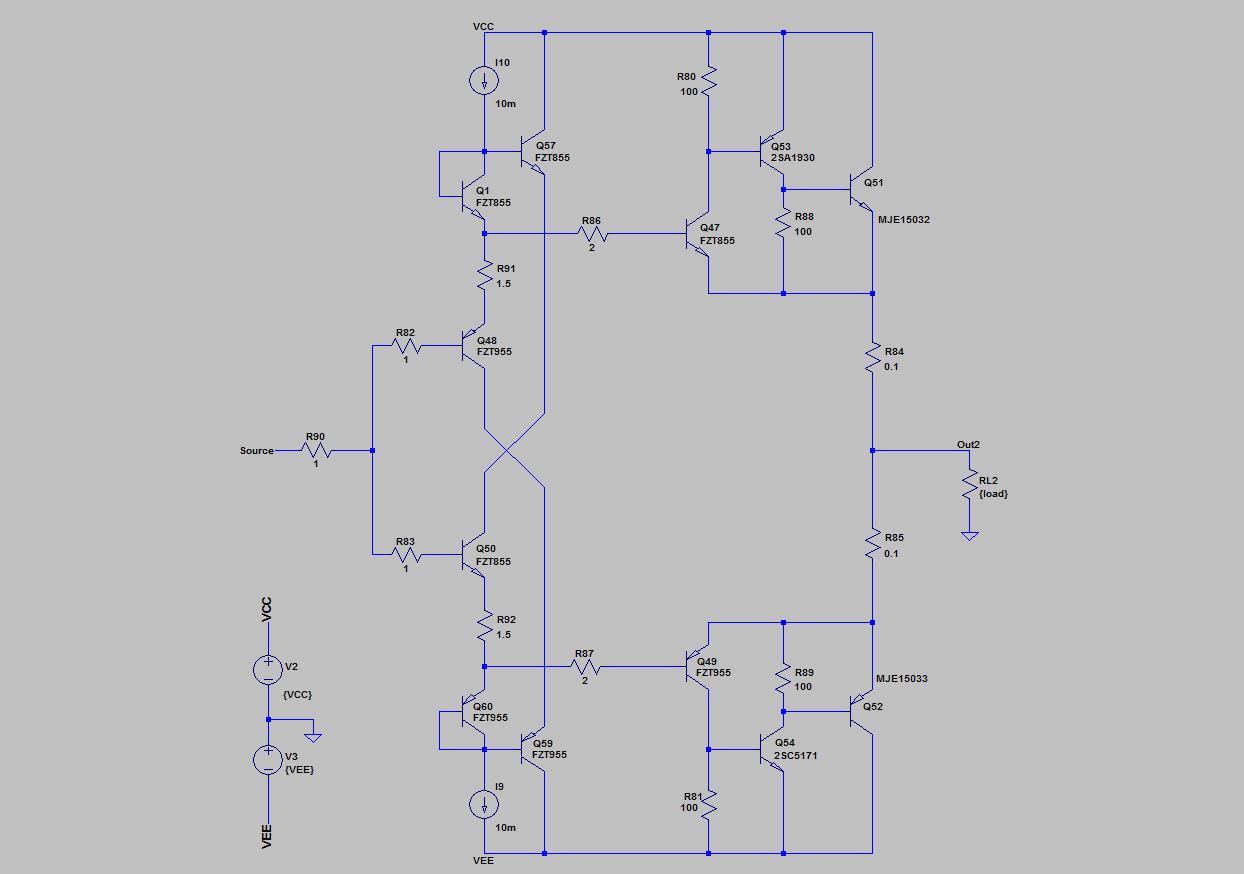

Just noticed a subtle, but possibly evil drawing error in figure 57. The output of U2 should connect to Q13 base, not Q14 base. Q14 base should be grounded. Otherwise the polarity of the common-mode control loop is wrong and very large VAS currents will be enforced.
My apologies for this, I hope it did not so far, and will not in the future, cause any accidents. I uploaded a new PDF with a comment added; corrected schematic maybe later.

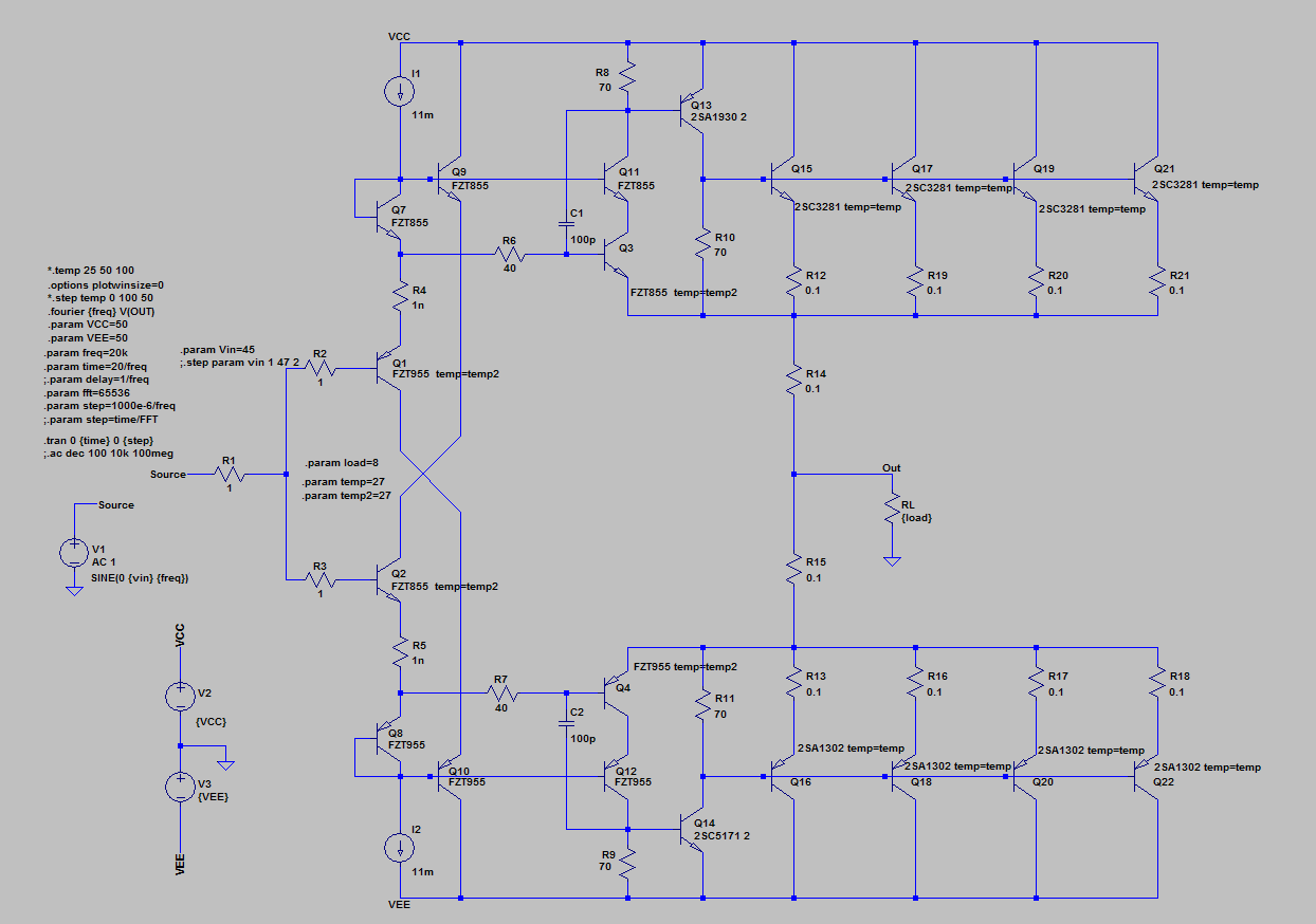

I have not built this one yest as I am still playing with it. My latest version is below. This buffer simulates 0.003 THD at 20kHz and full power. Not bad on paper anyway.

Remember, this is an open loop output stage only, not an entire amplifier. And it may not need any temperature compensation.
