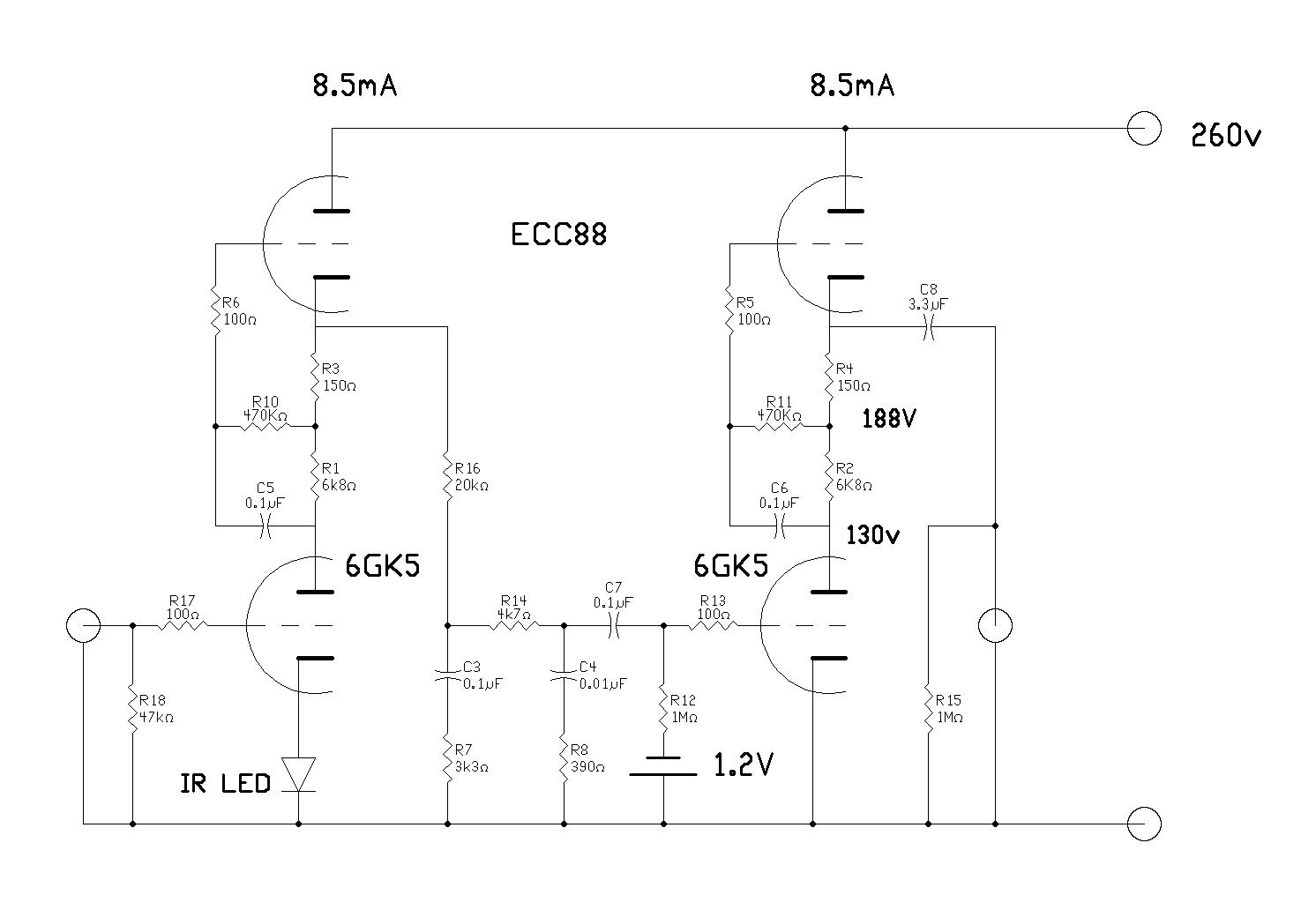

Hi, I am building a valve phono amp, any comments on this phono stage? Cheers Steve.
V velvetsunrise Member Joined 2005 2010-01-09 2:54 pm #1 2010-01-09 2:54 pm #1 Hi, I am building a valve phono amp, any comments on this phono stage? Cheers Steve. Attachments 02 6Gk5 Ecc88 Mu Phono.JPG 86.2 KB · Views: 177 Last edited: 2010-01-09 3:07 pm ••• More options Share merlin el mago Member Joined 2009 Paid Member 2010-01-09 4:37 pm #2 2010-01-09 4:37 pm #2 Hi Steve, Will better if you move your post to Tubes / Valves. Surely you will get an answerr there. ••• More options Share Show hidden low quality content Status This old topic is closed. If you want to reopen this topic, contact a moderator using the "Report Post" button.
