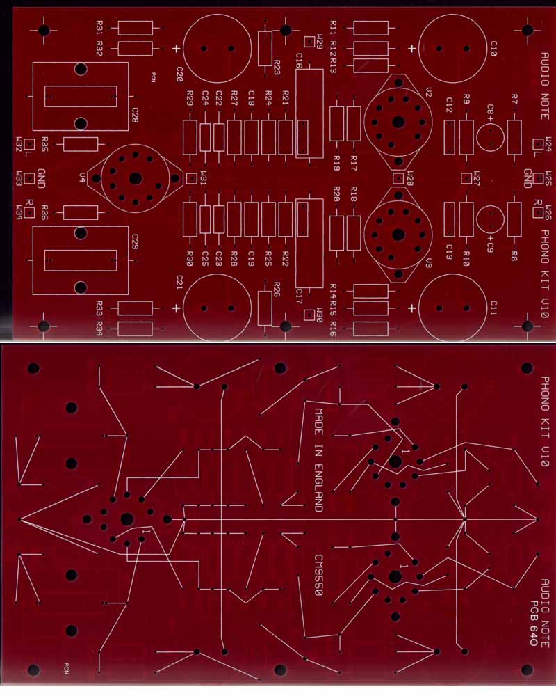

I agree.
I have two p2p amps from AudioNote (kits) and they are P2P.
The only reason that people use PCB's is to make possible a more complex circuit.

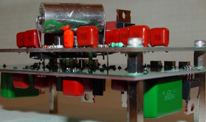

I use both machine (pick&place, wave solder etc.) and hand assembly techniques. Both are good at different things. The machine is fast and consistent. But it is neither versatile nor flexible, and places severe limitations on how you can design the physical construction of your circuits.
Hand work is slower, and sometimes the wrong part may be installed, or with reversed polarity. With good solder, good soldering equipment and a skilled assembler, the quality of solder joints is not an issue. The major advantage of hand work, however, is that you can do things that a machine simply can't.
For surface mount, I use pick&place and cream solder in an infrared oven. For simple, regular stuff, I use wave soldering. But for all difficult work (custom footprints, special lead bending patterns, point-to-point assembly, layering components on top of each other...), I use hand work. These are all things that I would have to give up in my products if I were to limit myself to machine assembly.
For example, here is an amplifier module from one of my 4.0 preamps. This is the product that Michael Fremer reviewed in Stereophile, and Roy Gregory reviewed in HiFi+. (I won't post any photos of the 3.0 because you can see it on our website). The top board holds the amplifier circuits and the bottom board houses the voltage regulators.
The two boards were designed as a single set and plug into each other. The "pins" are the component leads on both boards, and in some cases the components themselves (vertically oriented resistors, diodes, etc). The requisite leads are kept long and uncut during component installation and soldering, and are plugged into matching receiver pads on the opposing board during assembly.
You cannot do this with machine assembly techniques.
