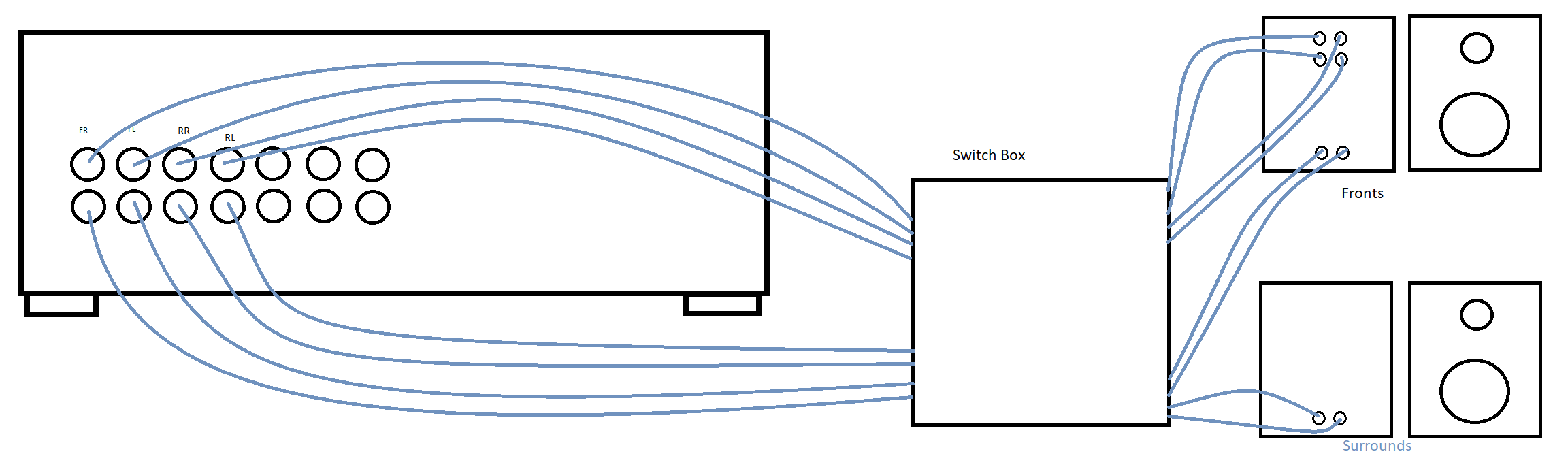

I'm currently designing my first 2 way speakers. I was torn between active and passive so I decided why not both since I love music and a surround setup for movies.
For the music setup front 2 channel:
I will be using 4 amplifier channels for the 2 mids and 2 tweeters via PC REW Jriver setup. This is strictly for the fronts.
Also I was wondering if I could create a switch box type setup for the AVR output jacks since I have one AVR and not enough amplifier channels for a surround setup with passive crossovers as well as a dedicated music (active) setup. Initially there was a switch system inside the speaker but I realized I won't need that with the switch box.
My question is, is this safe? It won't blow up on me right? Any feedback and criticism will be appreciated. I don't really know my electrics tbh.
