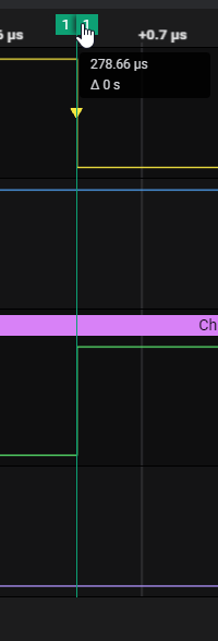

Below is a screenshot from a capture that I did of the MU100's digital audio stream:

I am attempting to mod a Yamaha MU80 to produce S/PDIF digital output. I have previously modded a Yamaha MU100 by using an AK4103A DIT. This was fairly simple; the digital audio stream going to the DAC (NEC UPD63200) on the MU100 is a 18-bit right-aligned PCM stream with a single data line, which the ak4103a supports, and I didn’t need any extra circuitry besides a few capacitors.
- 18-bit right aligned PCM stream
- MSB first
- Sample rate is 44100Hz
- bit clock is 64fs (64*44.1KHz = ~2.822MHz)
- word clock is 2*44.1KHz
- 32 bit cycles per word transition
- Word high is left channel, word low is right channel

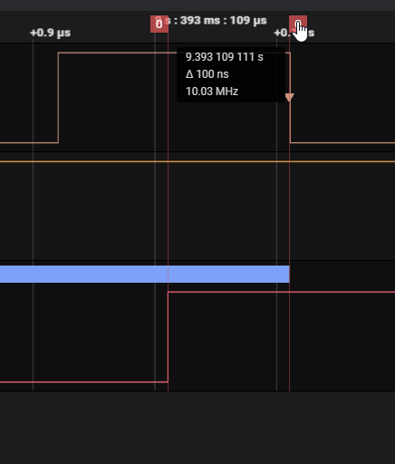

Here is the typical pulse width of the data line before the clock falling edge on the MU100; it transitions up and down between 80-100ns before the falling edge.
Here's the pulse width before the clock falling edge for the MU80, most of them are short enough that my logic analyzer can't capture it @ 50Ms/s. The longest I see is 20ns, so about 0-20ns
so not only would I have to adjust the clock about half a pulse width so that it isn't seriously affected by the propagation delay, the added impedance of the wires going to the DIT board and the DIT board itself could seriously interfere with the operation of the DAC. Can anyone offer me advice on how to tackle either of those? The impedance problem might be solved via terminating resistors, but I’m not sure how to dial those values in.
Maybe adjust alignment by reclocking with fast flip flops? Impedance matching with series resistors is what we see in many schematics of commercial products.

I went and looked at the DAC (UPD63200) datasheet again; it turns out that I had misread it (which was easy to do, since it’s very poorly translated from Japanese), and it’s the RISING edge that’s the clock state, not the falling. This means that this scheme with 4x74AHCT164s in series is fine and the propagation delay won’t affect it at all; I have about 120ns of wiggle room because the data transitions on the clock falling edge. Thanks for the advice, jpk73!

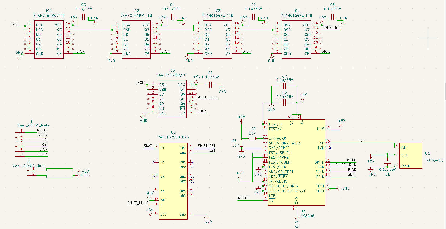

I went ahead and made the schematics for the board. I decided to use a DIT that was easier to find than the AK4103A so that I could just have this SMT assembled by JLCPCB: the CS8406A. It only supports 16-bit and 24-bit right-aligned PCM when in stand-alone mode, so I decided to use another 74AHCT164 to shift the word clock right 6 cycles to convert the 18-bit words to 24-bit words. I am using a 74FST3257 multiplexer that has minimal propagation delay to mux the LSI and shifted RSI together, with the shifted word clock as the selector.
The major concern that I have about this design is that I'm using the bit clock in 6 separate places; do you think it would be wise to put a clock buffer on here?
I am no expert in clock distribution, but in my logic circuits I could feed multiple ICs from one signal if series resistors (22R-47R) were placed near the source. And also check the datasheet of the source IC to see if it can drive the inputs of the receiving ICs...
