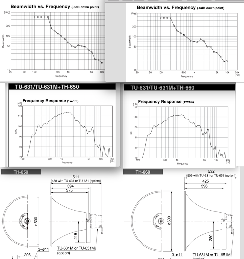

Regarding the "meter long exponential horn", see the response (and directivity!) of the TOA horn/drivers below.
The TH-650 mouth is a half meter wide, it's folded (re-entrant, reflex) horn length is about 3x394mm, 1.182 meters, about 46 inches. It's sensitivity 1w/1m is about 91 dB at 200 Hz. Note the 1.275 meter TH-660 does only 1 dB more down at 200 Hz.
I couldn't find any meaningful specifications for the DU-100, at best, it might equal that of the TU-631 driver, but could be much (like -3 to -12dB) less.
A (cheap) 6" speaker in a little box would sound far better down that low, and would be around 95dB 1w/1m...
Smith (DSH) horns would work OK, but 500 Hz would be about the bottom for them.
Art

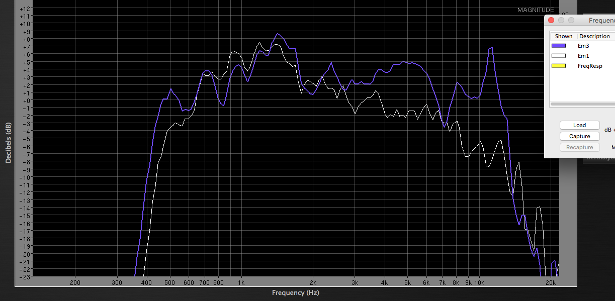

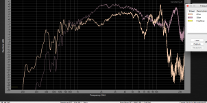

A "narrow 1kHz horn" does not give enough information for me relate to your "experience", or what you are missing. Response to 1kHz and pattern control to 1kHz are two different considerations.
As a guess, the Pyle PDS521 is probably as peaky as the Eminence PSD2002. If you did not EQ out the peaks, your horn experience would not be very "cool" 😎
As an example, see the response of a Eminence PSD2002 (16ohm) compared to a BMS 4550 (16ohm) on the same 13x13 degree Maltese conical horn.
Below 1KHz, the response "ripple" from the long horn is evident, but response varies by 9dB at 300 Hz.
Above 1000Hz, 6dB variations at 2kHz, 7kHz, 11kHz, then the PSD2002 takes a bow, while the BMS 4550 continues to "zing" up at 18kHz.
Without EQ, listening to those two drivers would be quite "different experiences"😉
The PSD2002 went through a diaphragm redesign over 20 years ago.
On a "90x40" horn (of bastard design..), the two are compared.
"Em1" is the older, but smoother "Series 1" diaphragm, which could be equalized with one filter, while the newer, "brighter, extended response" version would need about 7 parametric filters to tame it's response.
Since you plan to use DSP, are going three way, have the Alpha 8s in boxes, (and a bunch of poly cone "subs"?) just tune up what you have, then tell us what the experience is missing.

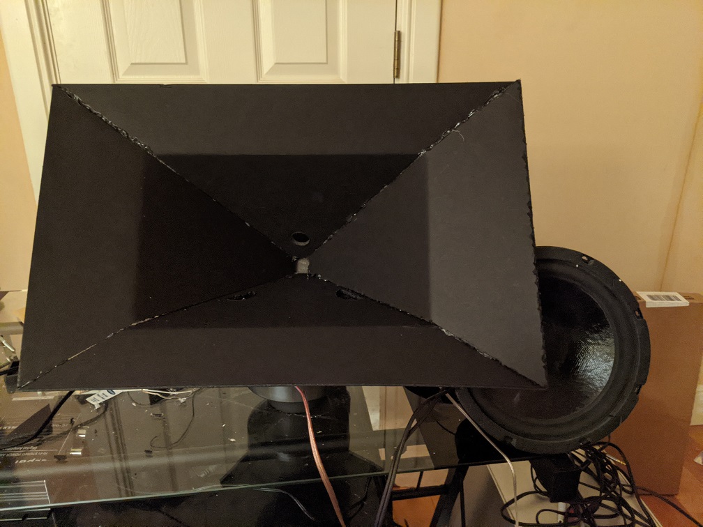

While I wait for the opportunity to go and get some plywood for the 'real deal', I went out on a whim and had a go at putting together a non-serious design using the Pyle, the Miyako and the Eminence drivers as a 3-way.
I focused on the compression drivers, attaching them to a 500Hz horn. See the attached picture.
Here's a list of things I noticed once I'd got the DSP together:
  • The Pyle driver was definitely more sensitive than the Miyako, which wasn't much of a surprise
  • The Miyako had a wider range than expected, though I found it performed best between 250Hz and 2kHz (it appeared to roll off aggressively after 3kHz in this configuration)
  • I had to turn the Miyako down a little
  • After listening to the Yamaha compression drivers, the Pyles were definitely 'brittle' in their sound by comparison
  • Regardless of whether I used the Eminence or one of the Polycone woofers, it was pretty easy to get a Bass driver to work with them, even without an enclosure for it
  • I 'bifurcated' the Miyako's output by creating a channel leading from the centre of the panel to the sides which opened to half of the exit cross-sectional area on either side (hopefully it can be seen on the bottom panel of the horn). No science (just inspired by the paraline thread, though what I did bears little resemblance)...I just wanted to see what it sounded like. It worked better than I expected, but I wasn't expecting much!
I might build a second one to see how they work in a stereo configuration, as I remember the foam core 2-way horns I made ages ago benefited from being a pair. It was fun to experiment and play around in the physical realm 🙂
