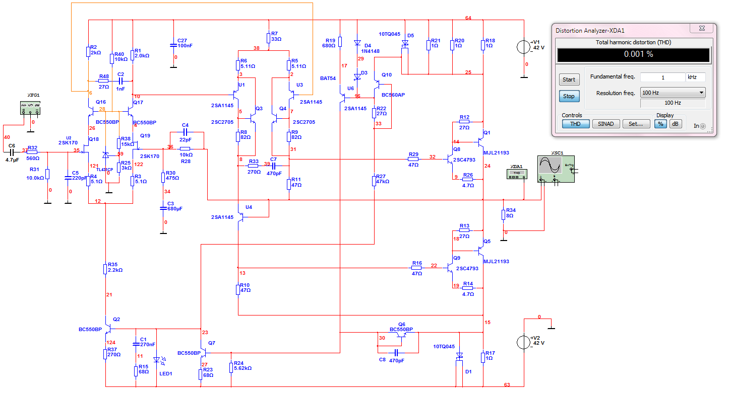

Would the inverted JFET Circlophone be related to this type of topology? It's not class D but does have a sliding bias to always keep outputs switched on for class A operation without a a lot of wasted heat.
http://www.diyaudio.com/forums/solid-state/189599-my-little-cheap-circlophone-34.html

Actually I m thinking of can we use class D stage as voltage follower and parallel to class A circuit output?

What the OP is talking of is a series topology.
The Vanderkooy example and Devialet are both parallel topologies but differing otherwise.
Devialet is not using feedforward error correction but a linear amp that is supported by a class D current source. One can find a lot of information on amps like that on the web when searching for Switch Mode Assisted Linear Amplifier (SMALA).
15 years ago I did lots of simulations with a topology that had some similarities. The current source was a delta sigma topology of low order. In the case of a first order loop the integrator simply consisted of the inductor alone. The simulation results were very good. It would have allowed good efficiency, high slew rates and low THD - in theory. But that doesn't say anything about how well it would work in practice.
