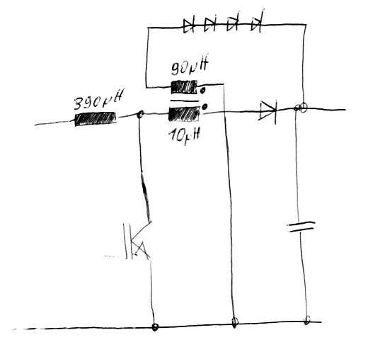

In order to understand your snubber correctly:
Is the attached schematic showing your snubber in principle?

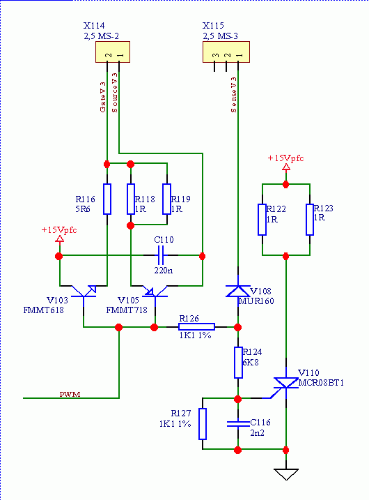

originally posted by Eva
buffered gate drive in order to avoid blowing the control IC everytime I blow an IGBT
maybe you will find attached scematic useful. It is a simple desaturation protection circuit which works fine in my PFC. I have not lost a single Mosfet in the last 5 years.
Best regards,
Jaka Racman

...hm, this could also be a magnetic snubber, Eva.
...but in contradiction to your explanation this one would not store energy when the switch is turned on...
Your comments made me curious!
Here the parasitic winding capacitance of the 390uH choke will
help to reduce the inductive overshoot. Or do you have further
snubbering for your IGBT?
I guess the snubber which estimated first will not only add the reflected output voltage (450V : 3 = additional 150V ) to the IGBT, but also some inductive peak due to the leakage inductance of the magnetic snubber....
...bye & good night 2 all
Markus

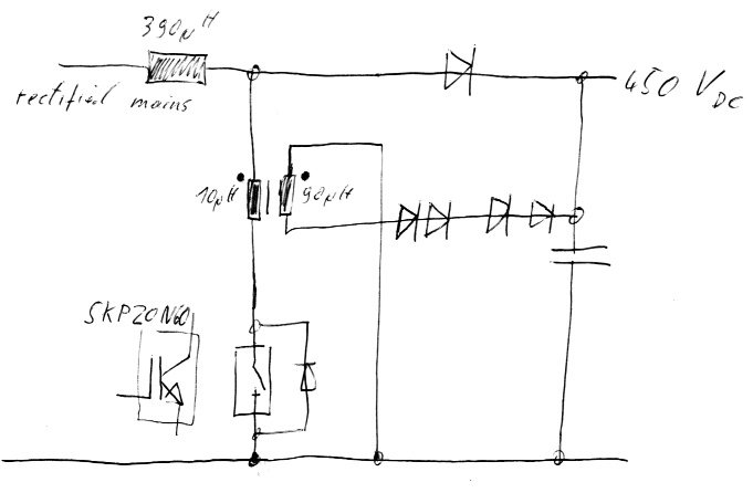

Chocoholic :
Looking at the layout of the PCB my snubber topology is easily figured out. The primary is connected between the diodes and the storage capacitors
So I made a big mistake when explaining the energy storage behavior of my magnetic snubber [I explained the first version I tried, that looked like your first schematic]
For the current version :
- During off period the inductor is fully energized and at turn-on it starts de-energizing as the switch current rises and diode current falls. The current across the inductor drops to zero and starts rising in the opposite direction during diode reverse recovery time. Finally the diode stops conducting and the reverse-current energy stored in the inductor is dumped back to the storage capacitors [three times slower than it was stored]
- At turn-off the coupled inductor works as an autotransformer, it keeps the Vce of the IGBT below 600V while the primary inductor is energized and until the required current is reached [this also happens three times slower, at 15A/us]. Both the parasitistic capacitance of the boost inductor and an additional RC network placed in paralell with the inductor help to reduce the likelihood of avalanche. The leakage inductance may still cause the IGBT to enter avalanche mode but during a very small period of time <20ns
This schematic shows the switching section of my PFC :
Note that I made another mistake in the previous explanations since I'm actually using SKP10N60 IGBTs [rated 20A at 25ºC]
Edit :
I've discovered one more mistake : Initially the coupled inductor had 10uH primary inductance but I forgot that I then tried 5uH without significant performance degradation and I decided to adopt that new value [so diode current downslope is actually 90A/us]
Excuse me for the mistakes, this project has been inactive for the past eight months and I'm quite lazy taking notes about what I do
Hi Eva!
That's great. Thanks a lot for your schematic !
Working principle matches basically to my second snubber picture.
But your arrangement is more fortunate regarding isolation requirements in the magnetic. I really like your snubber!

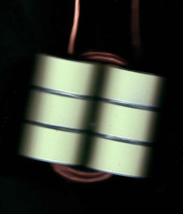

OK, I have an idea for the choke.
Combining several torroids (MPP or cool_mu) and make a double
aperture core. The attached pic shows such design.
Of course this is not the final PFC choke. I will have to take care for the isolation and get propper cores....
I am thinking about 6 pieces of MPP cores from magnetics, or similar.
http://www.mag-inc.com/powder/powder_cores.asp
6 pieces of core number 55930 will end up in a small
PFC core of about 54mm x 27mm x 34mm and nearly all the
winding would be place inside that core.....
And these MMP cores have a much lower permeability than
ferrite and allow an ungapped design for energy storage.
No gaps, less leakage fields.
BTW: From geomtrie such double aperture designs give quite a good coupling. I think putting together several ungapped E- ferrites ( should also be possible with U- ferrites)
to such an double aperture design, could be interesting for the push pull transformer!
Bye
Markus
