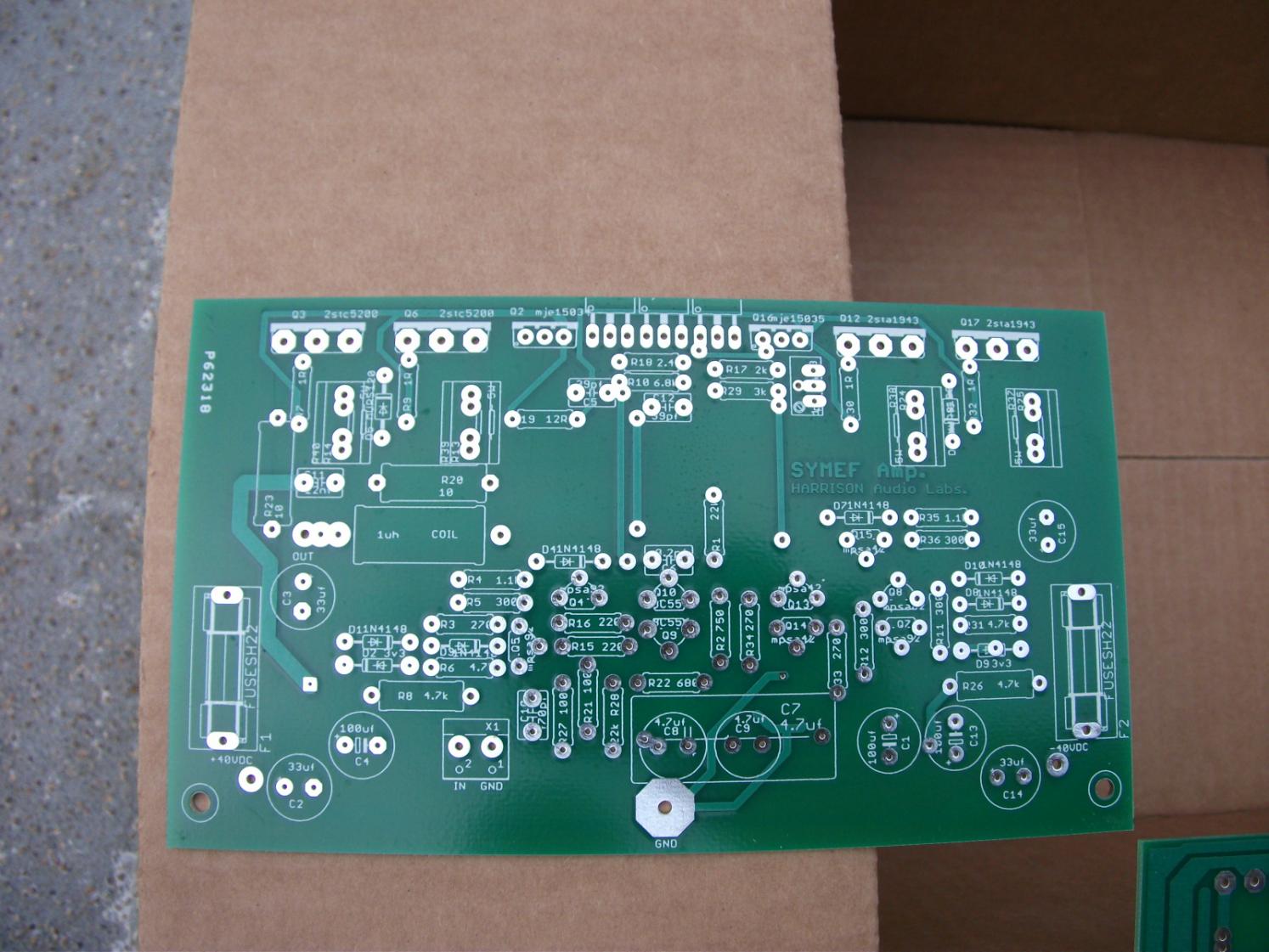

By the way, what you want to achieve? One audio amplifier with low THD or... ?
First, you should improve VAS amplifier diagram. Then, the output triple tends to be more prone to local parasitic oscillations than the darlington. You can eliminate this disadvantage, but not entirely, by mounting in the bases and collectors of the transistors Q1 and Q11 of 10 ... 15 ohm resistors. Then, the input is not properly optimized because the resistors R17, R29, R3 and R4 voltage falls too much. Typical aims to sweep more than 25mV. In this case, an optimal value for these resistors should be 20 ... 24 Ohm. Then, the most efficient way to eliminate noise input circuit may be done but after a few tests on prototype. In this respect, constructive way PCB has an important role.
