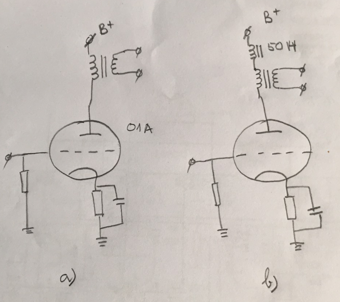

I have a question regarding a combination of choke and line output transformer loading for preamp tube and I'd appreciate your answers.
I'd like to use a line output transformer for loading of my 01A tube preamp. The output transformer has only around 90H of primary inductance which I believe is a little short for loading 01A tube at low frequency.
Is it possible that I'd use an additional 50H choke (audio choke) in serie with the primary of the line output transformer, according to my understanding:
If I take the output at the anode of the 01A tube (via a capacitor), it should be Ok since in this case the primary of the line output transformer will act like a choke in serie with 50H choke (the secondary will be left un used), so total inductance of the two will be 140H and the low frequency will be improved albeit with high output impedance.
If I take the output at the secondary of the output transformer, I believe the output will be lower than before since there will be a voltage divider between the choke and the primary of the line ouput transformer, that's acceptable for me but my main concern is would the low frequency at the ouput of the line output transformer improved or not?

To make my idea clearly understood, I attached the schematic below.
1/ Case a:
This is what i'm using at the moment. According the inductive reactance calculator:
Inductive Reactance Calculator • 66pacific.com
90H of the primary of the line out trans is equivalent to 11,310 ohms @20hz which is more or less the same as the plate resistance of the 01A tube, that's why the low frequency response of the preamp is not so great
2/ Case b:
If I connect a 50H choke in serie with the line out trans primary then the total henry of the two will be 140H and is equivalent to 17,593 ohms @20hz
- If I take the output at the plate of the 01A tube (via a capacitor) instead of the secondary of the output transformer (the secondary of the output transformer will be left unconnected) the the tube will be loaded by an equivalent choke of 140H and the frequency response of the output will be better (abeit with higher output impedance, which is not so great for preamp)
- How about If I take the output at the secondary of the output transformer? I know that the output voltage will be much lower than in case a due to voltage divider between the choke and the output transformer primary and that's acceptable for me but how about the low frequency response of the output? is it better than case a or not?
Thank you!

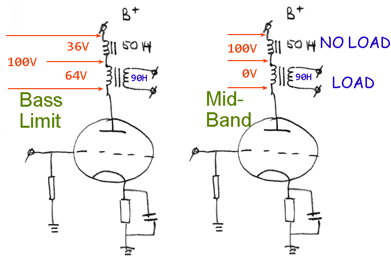

A 90H transformer and a 50H choke:
At the low bass limit the '01's signal is split as 36/64. If you only take signal from the transformer, the choke is robbing some of your signal.
Midband, load on the transformer, the choke robs ALL your signal. It is, as it appears, a "high-cut" working from about the botton of the audio band. Exactly like a series choke on a woofer.

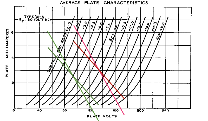

Plotting the load line for the two data sheet operating points with Xl at 20Hz. gives not much slope change between the two inductances but small differences sometimes make worthwhile impressions . . . . .
If you've got the choke there your idea is worth a try, no?

Thank you PRR for a clear explanation!
