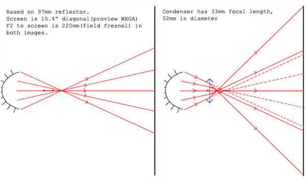

lamp & reflector
That lamp should work very well in the elliptical reflector you referenced. (It would be a bit better if the color temp was in the 5000 - 6000 K range, but 4000 will still work.)
The challenge will be to find a fresnel that matches the diverging cone of light that will come from the second focal point of the reflector. You should try making a full scale drawing, since you have the reflector dimensions. The extremes of the light cone are rays that bounce from the reflector very near the edge, and then go through the second focal point. If you extend those upper and lower edge rays out so they are 15" apart vertically, that will show you the distance for a 15" diagonal fresnel. Then you can measure the distance from the fresnel back to the second focal point. That will be the ideal focal length for the condensor fresnel.
I tried this drawing exercise for both the Edmund's elliptical reflectors, and it looked like they were not very good matches to available fresnels for a 15" LCD. You may be able to make up for a mismatch with the second fresnel, but an elliptical reflector design has fewer distances you can adjust, than a spherical reflector design with a pre-condensor lens.

Re: lamp & reflector
How about use an aspherical condensor lens right at or before the f2? It would enlarge the light cone after the f2, right? Since you have the ray trace software, could you try some condensors from this company:
http://highlight-opt.com/doce/pro3.htm
the openning of the 97mm reflector is 89mm, the f2 is 96mm from the opening plane.
reflector & aspherical lens
Sorry, I don't know how to model an aspherical lens in the free downloadable version of OSLO that I have. But when I said "drawing exercise", I meant drawing with a pencil on paper.
I made a two dimensional full-scale drawing of the reflector, condensor fresnel, and LCD, just to see what focal length fresnel I would need. I projected rays from the edges of the reflector through F2, and then out to the point they were 15" apart. That is where they should intersect the condensor fresnel. Then I measured the distance from the center of the condensor fresnel to F2. Anybody can do this!
without a condensor lens, the light cone covers about 7.8" area at 220mm from F2. This is perfect to screens that are 7" and under. In order to cover whold 15.4" LCD I am going to use, a condensor lens before F2 is needed. The condensor lens I modeled in the picture is :
Code No.``E.F.L. Diameter ø ` C.T ` E.T Aspheric R2 Material Remark
HL-AS-008 33mm 52 mm `` 32.56 ` 2.5 `` AS `` 0 ` B270
of course it is a very thick lens (32.56mm at the center), in real life its behavior wont be exactly as shown in the picture, but you get the idea.
