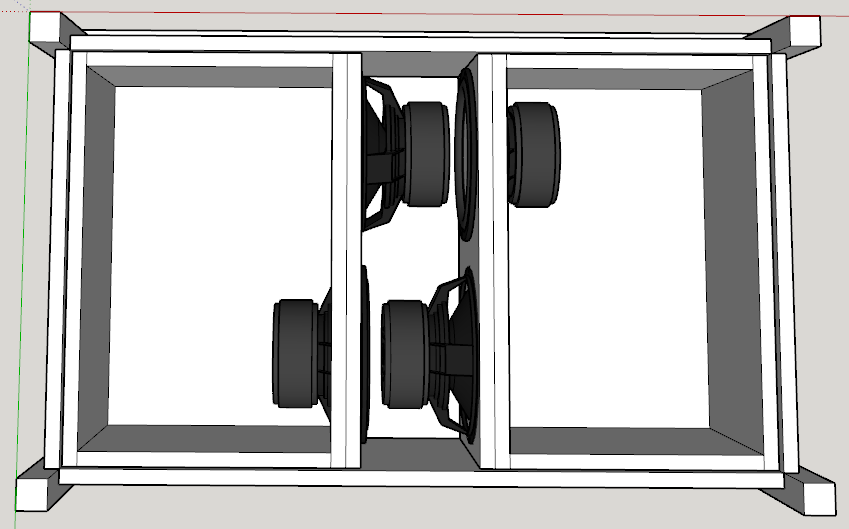

Exterior dimensions are 1200 long, 700 wide by 450 high. Ideally i'd like to keep this as small as possible, but need to still fit the four subs.
In the attached image, all walls are 25mm thick, the exterior walls being something like bamboo ply, and the interior ones being MDF.
My hope is that push-pull can help cancel out vibrations so coffee doesn't walk across my table.
My questions are:
How do I work out the aperture of the opening venting the subs to the room (the middle section)?
How do I work out how long the table legs should be, ie: how much space will be under the coffee table allowing the woofers to vent to the room?
What is the optimal way to wire these for push-pull?

If the two end enclosures are sealed and the middle section opens to the floor, and your dual voice coil drivers are individually wired in series for 8 Ohm each, I think this scheme will give you an 8 Ohm nominal load at the terminal and have everything in synch:
I think that will work very well for a single powerful amp, but not as well as building 4 separate sealed boxes (each of half the volume of one of your end enclosures) and spacing them around the room with smaller amps.

It will work either way with no performance difference. It will look neater as a piece of furniture with the sides installed as per first pic.
Not so sure on that.
Hornresp can simulate the effects, but firing 4x drivers through a narrow slot will head towards a 4th order bandpass. The picture with the open sides will behave much closer to just sealed boxes.

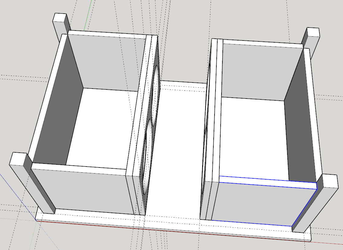

Don't suppose someone would be so kind and simulate it?
I've attached dimensions here.
There's a 75mm gap between the bottom of the table and the floor.
Hopefully this is enough information?
Also, planning to use bamboo ply so the stripes down the middle will be a "feature" 🙂
Much appreciated.

I've actually built PP manifolds and they measure just like the equivalent sealed/ported enclosure without manifold until the manifold depth becomes significant. Not an issue for a sub but may be for a midbass.Not so sure on that.

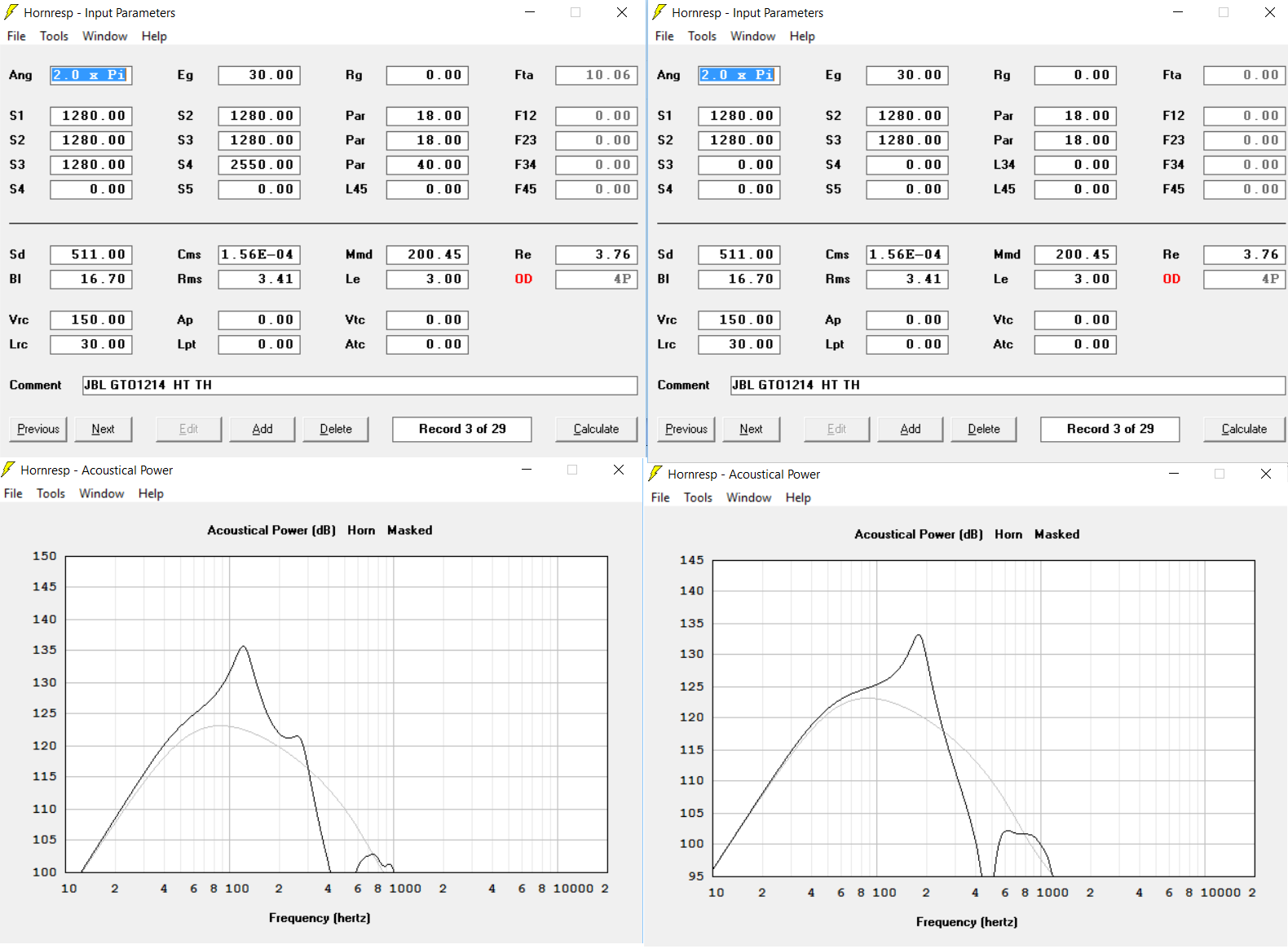

Here's some sims.
On the left, firing out of the bottom of the table, on the right, firing out the sides. Dimensions are approximate, and I've used different drivers. In both, the grey trace is a sealed box.
Note that with the left-hand simulation, the distance from the edge of the table to the drivers varies over a wide range. I guessed at an average. The variable distance will likely mean the peak is quite spread out when built.
Chris

Thanks Chris,
Grey is sealed and black trace is that semi-bandpass arrangement?
Won't be using it over about ~80hz so will need a sharp filter if that's the case.
That's correct, yes.
As I said, though, the one on the left (firing out around the bottom of the table) will have a variable distance from the edge of the table to the drivers, so the peak will be flatter and more spread out. YMMV.
Either way, I'd recommend measurement and EQ.

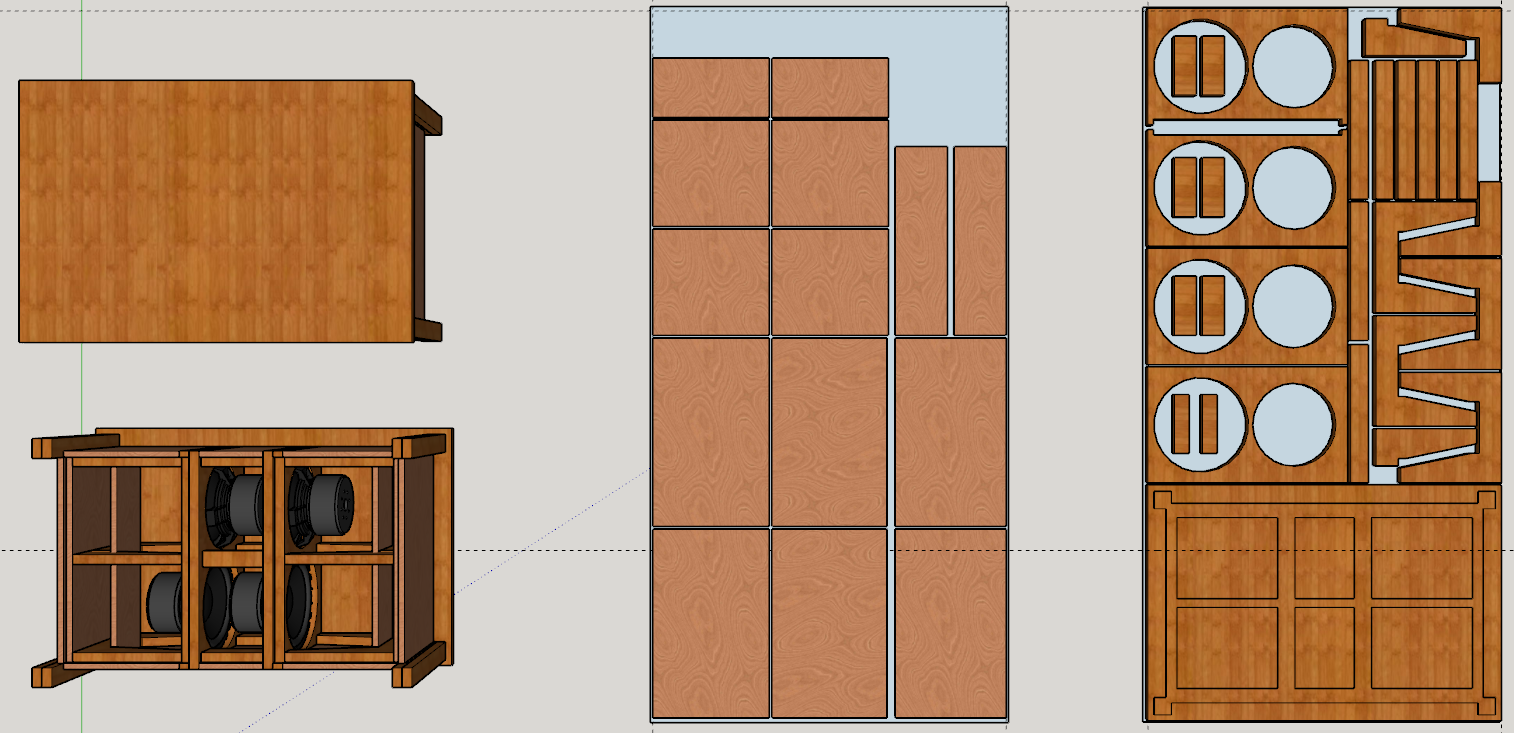

Final design completed, i can just squeeze this onto 2 sheets hopefully.
One sheet of 30mm, one sheet of 19mm.
Using Bamboo ply so the edge grain will be a "feature".
Since the 30mm sheet will need to be CNC'd i figure why not have an inlay CNC'd so that all pieces "slot" into the underside of the table top.
