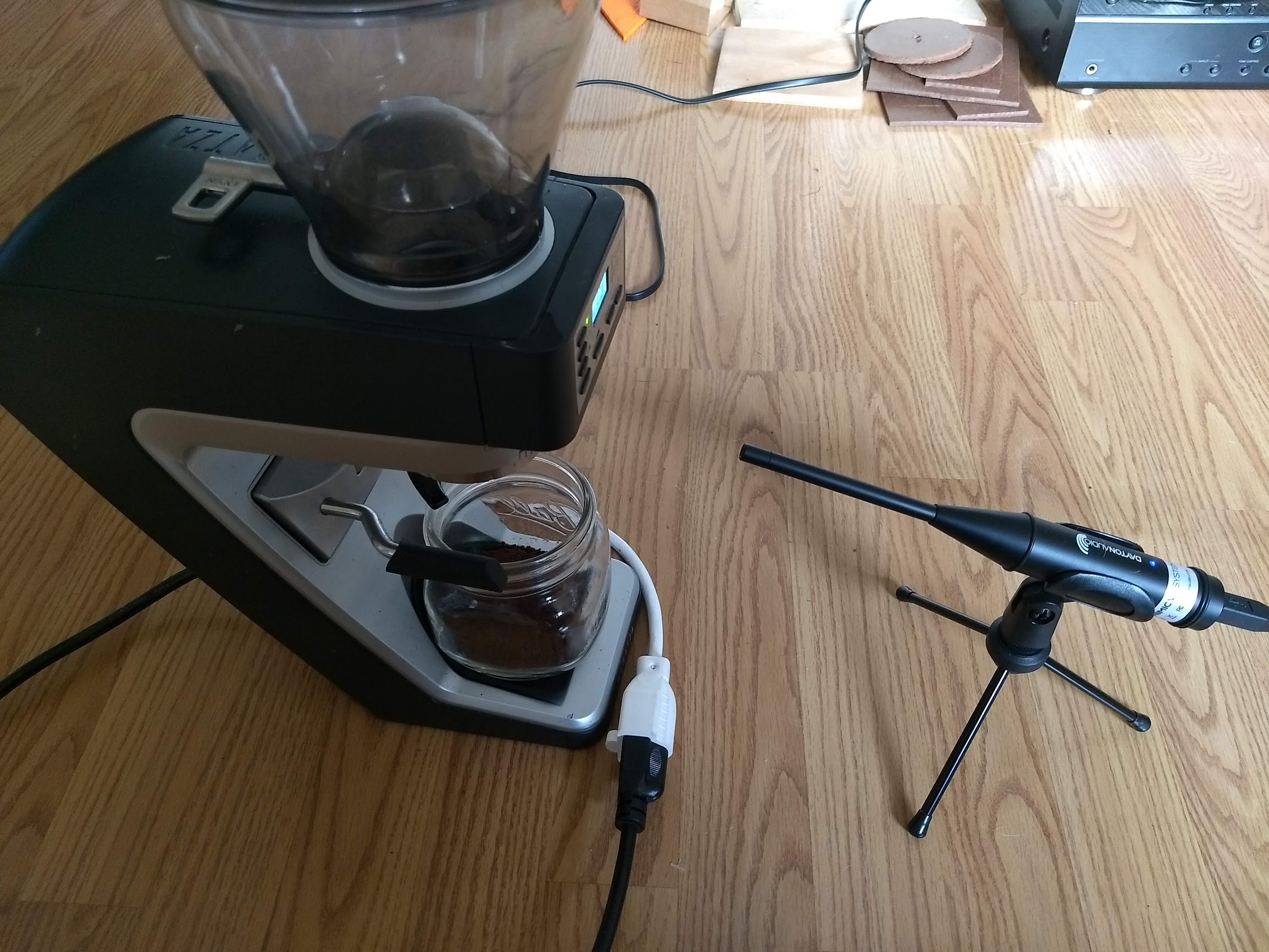

I love my coffee grinder but it's extremely noisy. It's a Baratza Sette 270. I have other coffee grinders that are much more quiet -- pleasant sounding, actually -- but they are designed for commercial use so not good for single dose passthrough. The nice sounding grinders use steel enclosures.

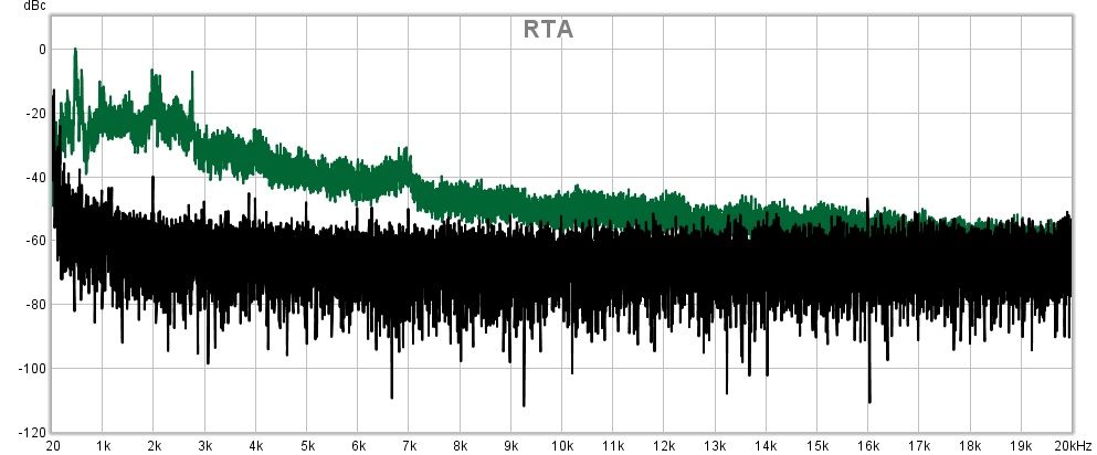

Because I think the grinder is worth it, I want to build a noise reduction enclosure. I'm not sure how I'm going to approach this yet so I started by trying to measure it with REW.
If anyone has ideas on how to approach a noise reduction enclosure I am all ears.
Now that I think about it, I should probably measure the nice sounding grinder so see why that one is ok. I'll do that later and post the results.

I used to grind coffee with a Krups grinder - much smaller. I would wrap a kitchen towel around it.
Noise reduction is all about air tight enclosures with walls that absorb pressure waves and do not re-radiate.
A quick and dirty way is to find a suitable airtight container like a 5 gal plastic paint bucket. Line is with Noico foil faced autosound butyl. Use hot melt glue to line the inside with melamine foam pads, or use the fancy foam rubber sound absorbing foam with peel off adhesive. Put window weather strip gasket on bottom rim for airtight seal. Put a 10lb bar bell weight on top (to keep airtight pressue on rim) and place bucket over the grinder. You need a small divet/cutout for the power cord make sure it has a gasket. Or install an extension cord throigh the wall and seal with glue for airtight seal and plug grinder into the internal extension cord receptacle. That should work but is kind a of a pain to store when not in use. It could serve a stool I suppose if decorated on the outside. Leave in kitchen for step stool for reaching high shelves or for kids to sit on. If you wanted to get fancy, build a 3/4in thick Baltic Birch ply "grinder cabinet" lined with same stuff and have a door on hinges with gasket and a latch. :)
