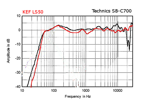

The preference for a slight downward slope would arguably be a deal breaker with either speaker. I really wanted to like the KEF but never warmed to its balance. The Technics may be a better compromise for me; much flatter through the crucial vocal mids and from what I can tell smoother off axis. My biggest concern is the Technics' cabinet alignment, why manufacturers tune for 'chestiness' will always be a mystery. Graph splice of Stereophile's results below.
Still want to hear them though...

It would be close to maximally flat in real life. Atkinsons's measurements are known to start peaking from about 300Hz purely due to his quasi-anechoic measurement method where he splices nearfield measurements from 300Hz down. It assumes 2pi radiation in a 4pi environment, which causes peaking up to 3-6dB higher than the actual SPL. The Technics starts peaking right from 300Hz down so it has to be that. If it was chesty the peak would be even more exaggerated.
IMO he could easily rectify that (Bagby wrote a paper on exactly that topic) but he values consistency with past measurements.

You are apparently correct, at least from what I hear in my living room. These speakers go impressively deep for their size without a hint of chestiness. Technics did due diligence with the port design. Internally it faces a padded partition, perhaps explaining why no upper harmonics are audible behind the cabinet, just deep bass. It scales very well with level, sounds like a significantly larger speaker and are imaging demons. Because of my line of work my preference tends more towards studio monitor flat but off axis I don't hear excessive high end. Not bright but never mistaken for forgiving.
