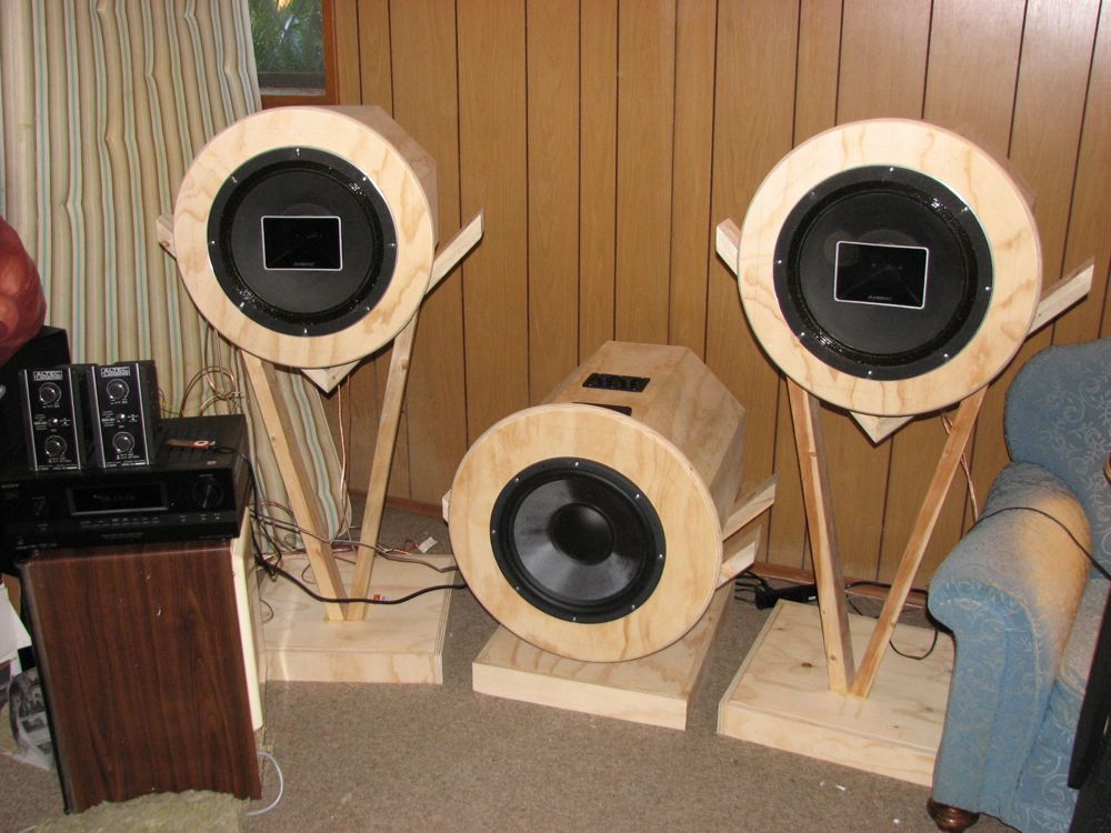

Based just on the spec it looks nice. I like how extended the components are; lots of overlap. I'd like to try a driver like this one day, to hear:
a) a non metallic diaphragm on a HF horn
b) a smaller coax than my current 15"
Someday I will own my own home and have a wood shop again and be able to try all sorts of fun things.
I'm apartment dwelling now (no work area), but I have a bush block to dally on, and am about to join a maker space (essentially a communal workshop) to access oodles of gear. If you Google ["Maker Space" + CITYNAME] you might find something similar near you.

This has some similarity to my setup - my 15" coaxials are in near-cubes with lots of rounding on the corners. I note they use 10w / 350w amps, implying a huge amount of LF boost.
I use a lot less power and eq than that, cos I have a box with two more 15" instead of a stand. Stands seem like a waste of space to me.
for 12cx, I've got Eminence in 54, 80 and 109oz ferrite magnets - some Beyma 12cx with APT50-like tweeters. P-Audio 10cx and 15cx.
80oz magnet Eminence are the most sensitive of my 12cx - Beyma 12cx woofer, the most extended on the top. Seems like an allpass on the woofer helped lock the tweeter to the woofer
You seem to slam drivers pretty hard, so I'd have thought excursion capability would be more important than sensitivity
How much difference does this make? I haven't experimented with delay on mine, partly cos I didn't know how to get it right - it took me an embarrassingly long time to work out how REW does impulse plots.
