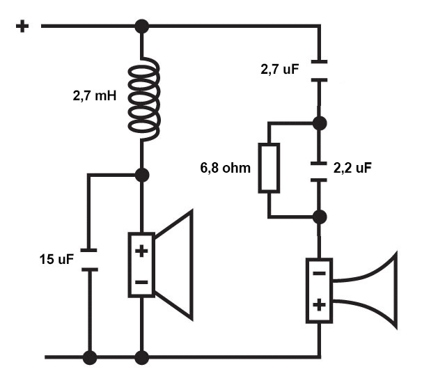

Eminence Beta-12CX and APT:50 (same woofer)vs PRV D290
You could try this crossover, at least the woofer is done.
Try the PRV make adjustments, etc.
