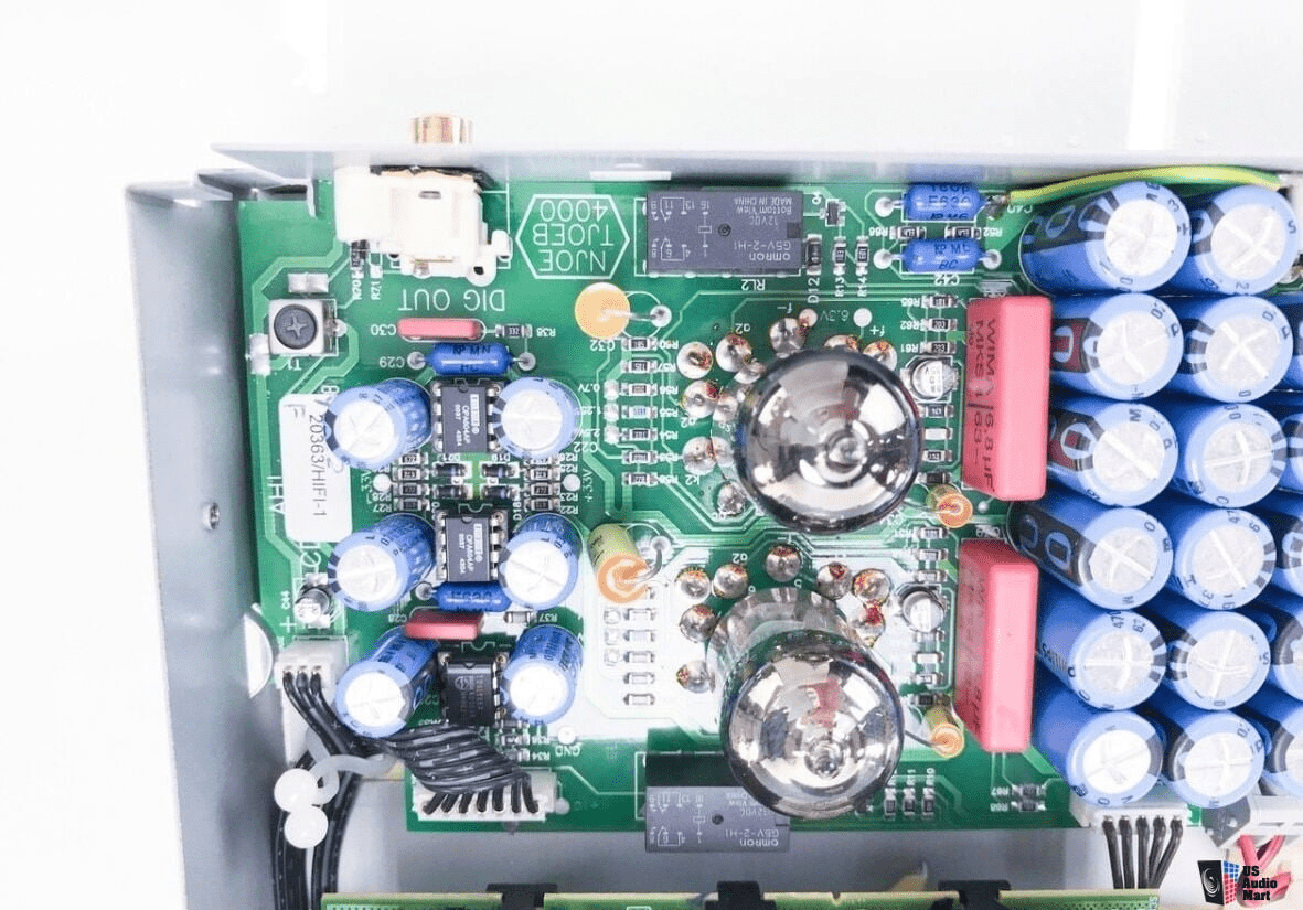

I have a Njoe Tjoeb modded Marantz cd4000, Always used either through headphone output or RCA out to amplifier.
Just bought a Hifiman ef499 and wanting to use digital output via coaxial cable.
I have plugged cable in both ends, selected Coax on the ef499, but no sound.
Checked ef499 with digital input from phone and PC and they work fine.
Is there a switch I need to set on the cd4000 to activate digital output?

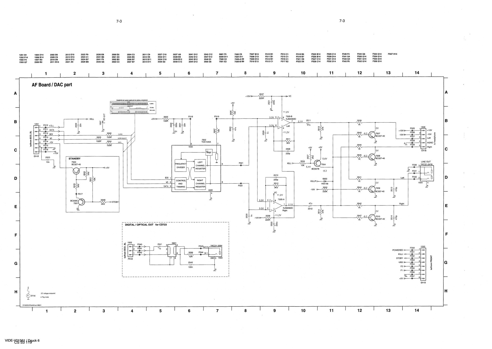

A service manual with schematics is available at: https://www.manualslib.com/manual/2256356/Marantz-Cd4000-N1b.html
Don't know what "Njoe Tjoeb modded" entails though. Is the SPDIF output part of that? Or was it a feature of the original unit? If its part of a mod, then do you have a schematic for the mod? If not, can you reverse engineer one?
Also, do you have an oscilloscope?
Thank you for your replies @huggygood and the schematics.
Any idea what T1 sets. It appears to be a potentiometer in line with the digital output?
Pot on digital output might adjust signal level, transformer ringing, and or coax cable impedance matching.
