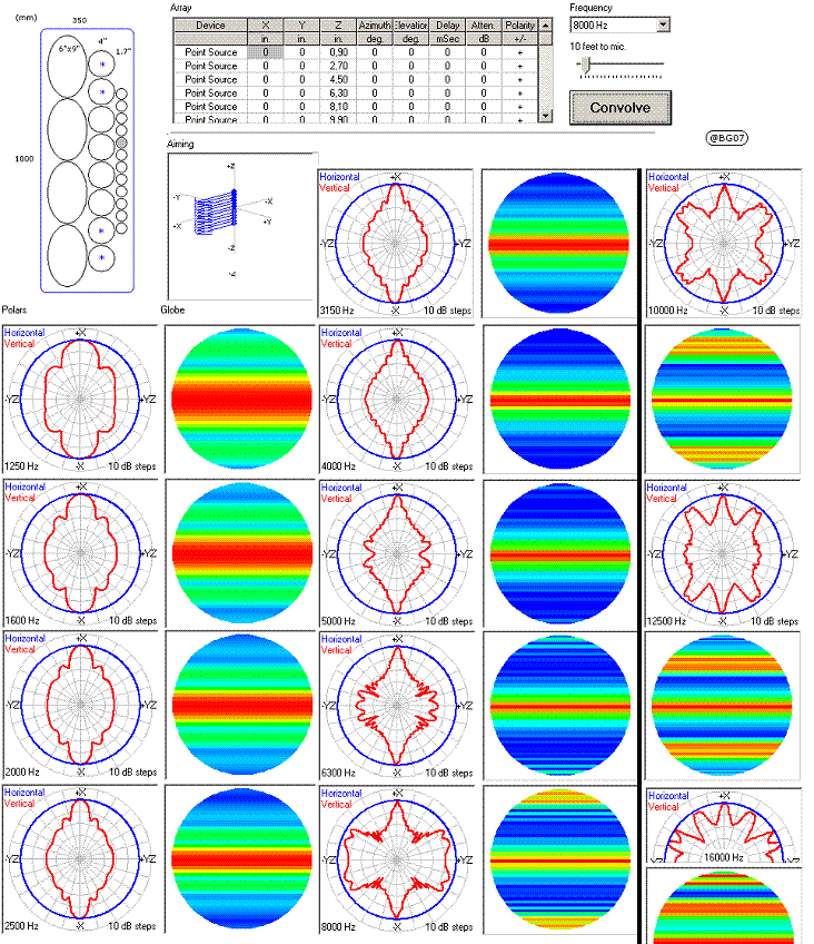

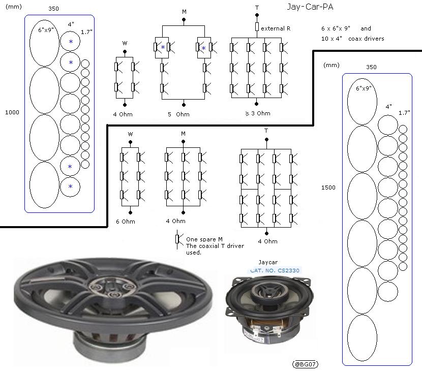

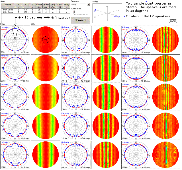

...I dont want like some super duper high end speaker but want to turn them into a party music pumping machines...
Nice idea, could work as intended….I took this concept and played with it…..See picture.
The 6”x9” divers could also work well in a compact stand-box placed below a 2-way array.
Notice the removed coax-tweeters and new placement that really is necessary for good performance.

as you can see in the picture that bjorno posted, there are silver 6x9s
my plan is to stack them side ways as close as possible going vertical so the minimum height would be 8 x 15cms = 120 cm + ports and walls and grills spaces approx 140cm per speaker

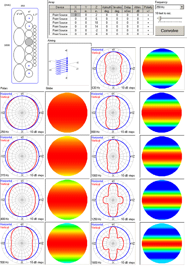

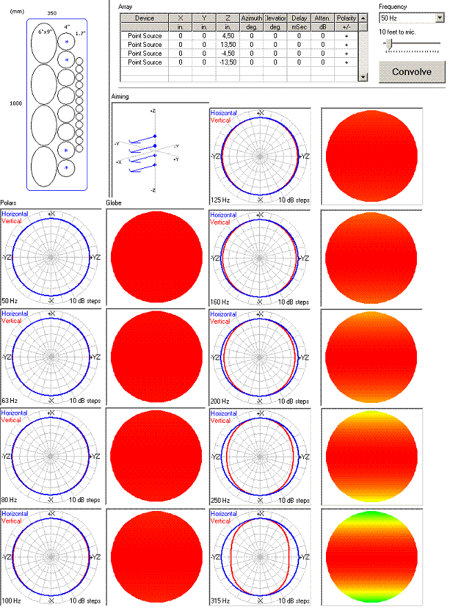

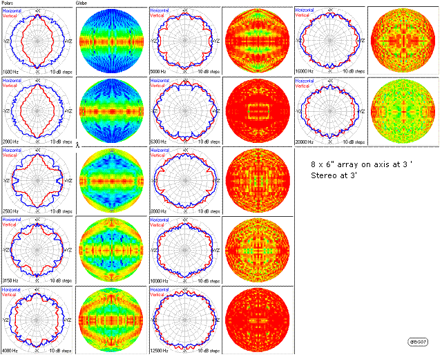

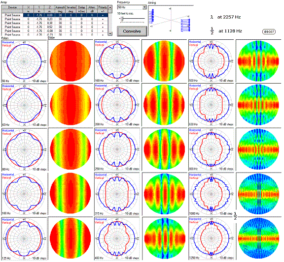

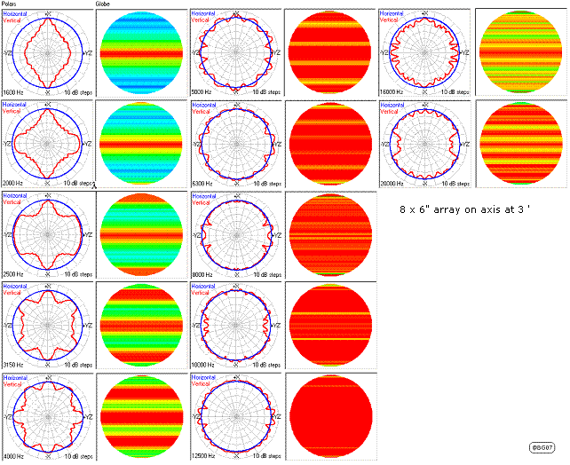

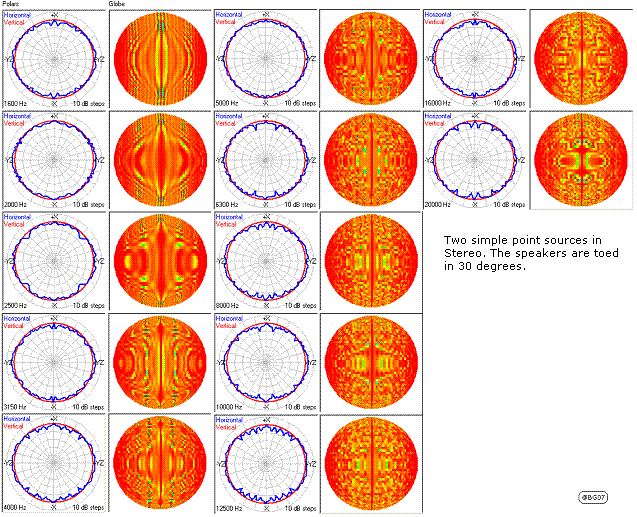

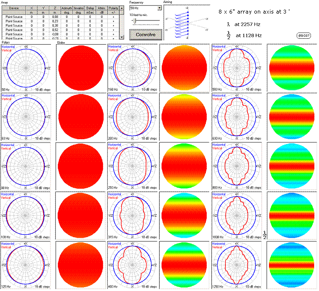

From experience and knowledge from you guys I want to simply know what effects this plan will have---- or will there be so much cancellation it will be pointless...
Here you have an opportunity to make a decision on your own if you should stay with the 6”x9” coax drivers in a simple row.
Take a look at all the submitted plots but do not expect your drivers have comparable levels outside the plotted +- 15 degrees response without taken into account the actual driver off axis response levels that always must be considered instead of the shown point sources omni dispersion.
First shown is the combing effect for single driver speakers that never can be circumvented even for prefect FR flat speakers. One conclusion is that for a given stereo set-up there is a best sweet spot, where only one unique always-rippled or non-flat speaker minimum phase FR curve that provides flat FR response to the ears.
Also noticed from the plots: If using the coax drivers in a single array column, then at about 0.9 x Lambda (valid for a typical 8-array) the vertical directivity drops down 5.5 dB causing more sound energy to be perpendicular directed instead (indoors to the floor and ceiling) to the audience destroying the sense of scene size and at an octave above the beaming is in near full bloom.
Array designs with crossovers at these frequencies trying to defeat these anomalies are doomed to still produce low audio qualities (phantom location, image split and tone coloration) even if using high order filters they also give array speakers a bad reputation when compared to more common speaker designs.
If I had the opportunity to test those coax drivers in an array I would use a Low-Pass filter crossing over the 6x9” drivers at lambda/8 to 3”-4” drivers, for the need of wide ‘Party’ dispersion and if the tweeters normally are crossed over at higher frequency when compared to the 3-4” drivers, I would try to use into a simple wave guide too.
The last three plots are reflecting my first proposed far field 3-way 1 m array and possible work bandwidths.
