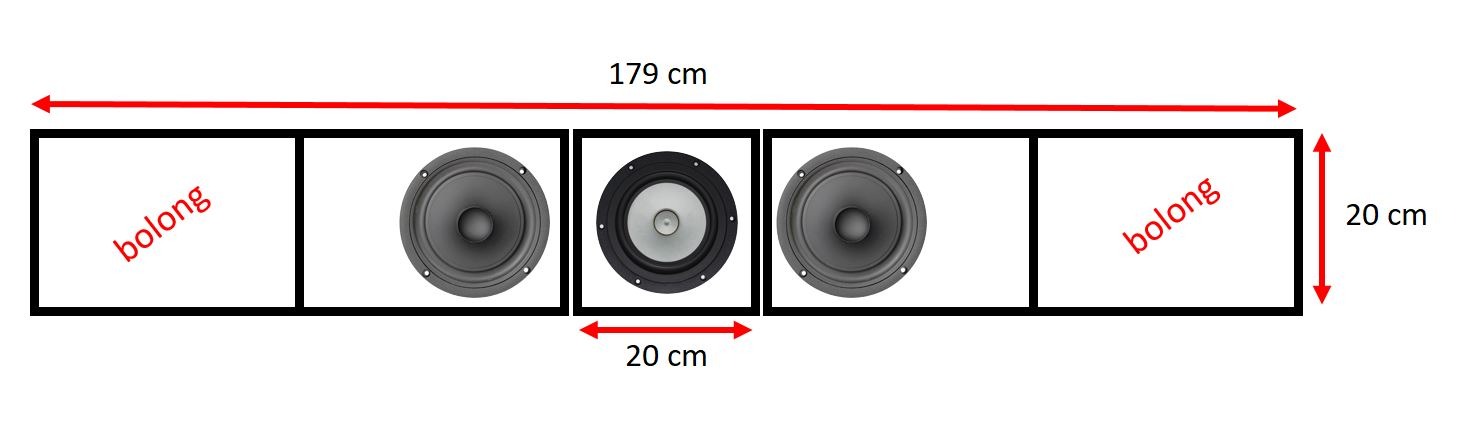

coaxial for MTM center speaker with 2x SB17NRX
I'd like to build MTM center channel speaker with my existing 2x SB17NRX, cross low enough maybe around 350Hz to avoid issues with horizontal dispersion. so the option will be using 5" or 6" coaxial driver
candidates so far :
  • sb16pfc25-4-coax
  • celestion tfx0512
  • faital pro 6hx150
in my short research, it seems using pro driver coaxial have benefit to provide more headroom instead of SB coaxial. i exclude using fullrange driver (i have 1 pair of alpair 10p unused) or maybe other 5" / 6" like fostex or lii audio which has lower headroom
any input will be appreciated, because i rarely find center speaker project with coaxial, majority using midrange + tweeter combination, where low height box is also my consideration. 20cm height is the maximum that i will use because it will be placed under TV
thanks

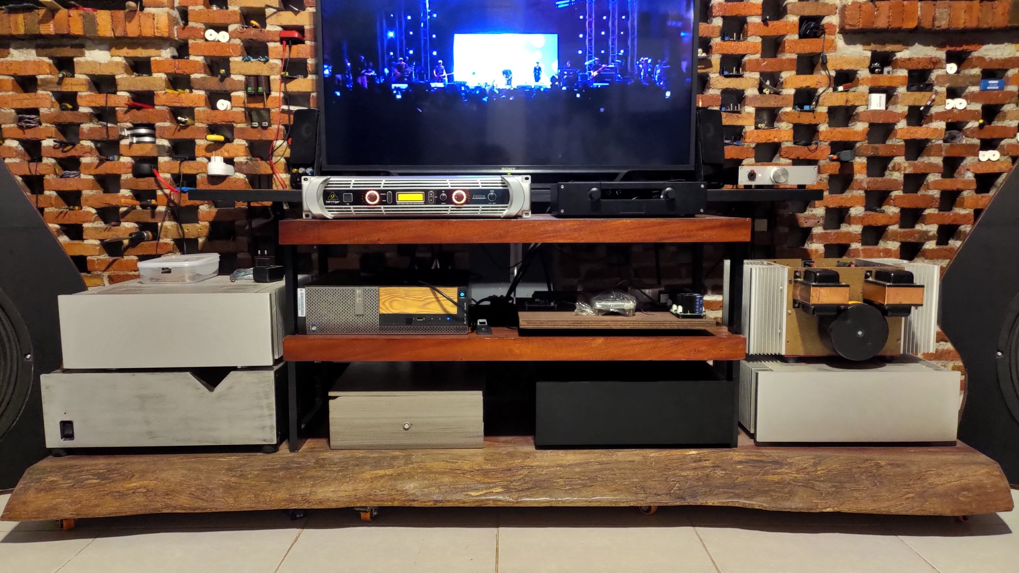

btw i don't have any AVR yet, still long way to buy it because there still several audio project waiting. i really need to raise tv position because i want to put my tube dac on top of my rack (black chassis on lower rack which collect heat alot) which block tv view

Sorry Irealized being off topic! 🙂 Input for horizotal MTM:
there is going to be issues with horizontal polars, because the coax will radiate to sides and diffract from the woofers there. How severe? probably doesnt matter. The woofers could be at the ends of the enclosure instead on the front to reduce some enclosure resonance perhaps, and put crossover low enough so they are within roughly 1/4wl apart to keep the system omni. Unless there is reason to do something else for easy passive crossover.
MTM seems to make about an octave worth of narrow directivity, which might be usable to reduce problematic ceiling/floor relections, but for horizontal arrangement I don't know why would one want to have it without as narrow polars above as well (waveguide). There is no point with MTm setup woth coaxial either, since the coaxial has wide directivity since the woofer part is direct radiating. Narrowing response again below this would be counter productive. Basically, the woofers could and should be somewhere else than disturbing the horizontal response of the coaxial.

I just ordered the cabinet to my friend, estimated around 13L volume for each SB17NRX. center square box is separated, so I can replace it later with any 5" or 6" fullrange or coax.
it will be passive xo which i have to try but trying to make it simple. btw because this is center channel which mainly for dialog, i don't think too much sophisticated requirement is needed

Just discussed with my friend who will build this box, he mentioned that SB16pfc coaxial is not recomended. beside Alpair, i think faital pro is the next candidate. hopefully it can match with 2 NRX so i can use Alpair later for stereo usage
