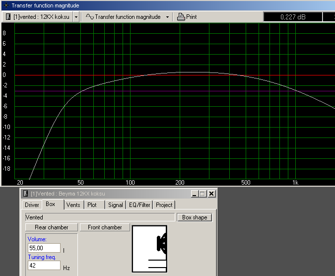

I think Beyma 12KX has very good parameters for traditional BR enclosure.
Resonant Frequency (fs) 45 Hz
Impedance (Re) 5.6 ohms
Coil Inductance (Le) 1.0 mH
Mechanical Q (Qms) 10.4
Electrical Factor (Qes) .38
Total Q (Qts) .37
Comp. Equivelant Vol. (Vas) 2.47 ft3 / 70 Liters
Voice Coil Overhang (Xmax) 3.5 mm
Surface Area of Cone (Sd)m2 0.055m2
Reference Efficiency 2.9%
Displacement Volume (Vd) 200 cm3
WinISD gives nice bass responce for that driver.
I think room pressurising is quite important with rock music. Try this kind of stuff with big Tannoy and then with OB. Does bass drum feel different?
