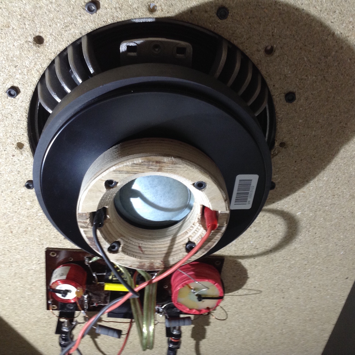

@mordikai, I think overexcursion is not a problem. The back chamber is there to protect the dome/diaphragm from touch
and air pressure when in box with other speakers (and its own cone).
Most dometweeters are unprotected.
@Rudios, yes that are Oberton 8CXs, LF8Ω/HF16Ω. Oberton changed the design of their coaxials to my dissappointment.
They glued a thick Kartoffelsack/dustcap on the front to hide the bad aligned horn/coilformer/cone.
The coilformer was 3-4mm protruding and I had to Dremel that down to make it as smpooth as possible.
The tlhp catalog shows an old model but on Oberton's page you see the new.
@adason, I didn't hear or measure inceased distotion. Maybe because it's already quite high.
But the listening experience is much more pleasant.
Cheers
Attila
