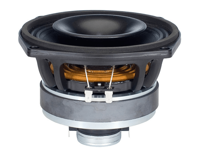

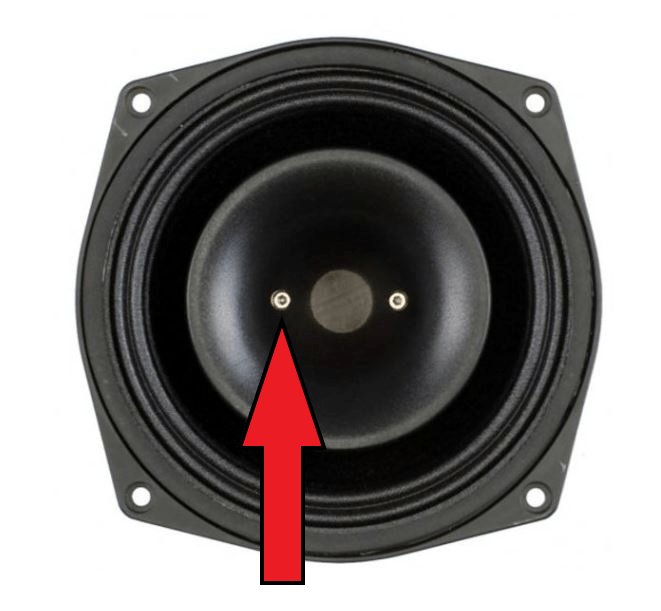

Hi, does anyone know if you can remove the horn from the B&C 6FHX51 by removing the screws? Or if there are any other coaxial drivers where you can remove both the compression driver and the horn. Thanks
https://www.bcspeakers.com/en/products/coaxial/6-5/8/6fhx51

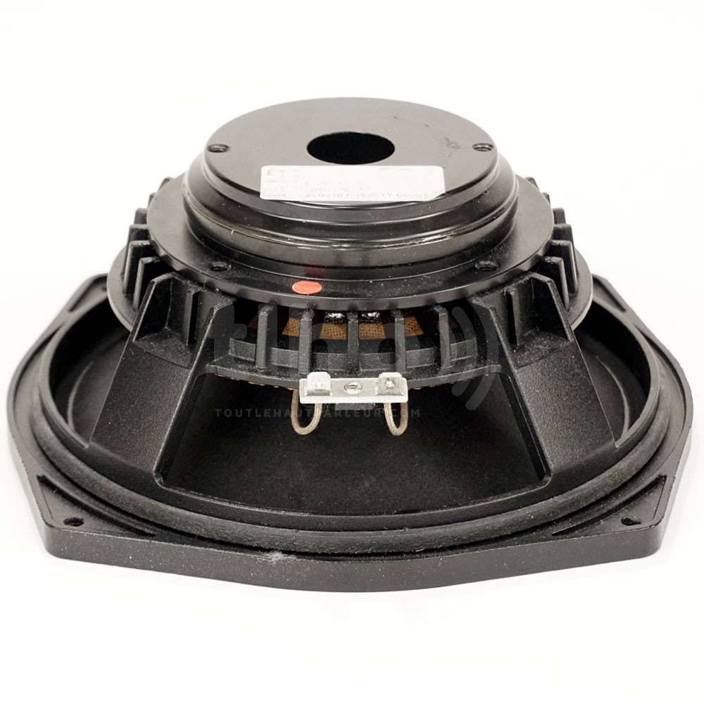

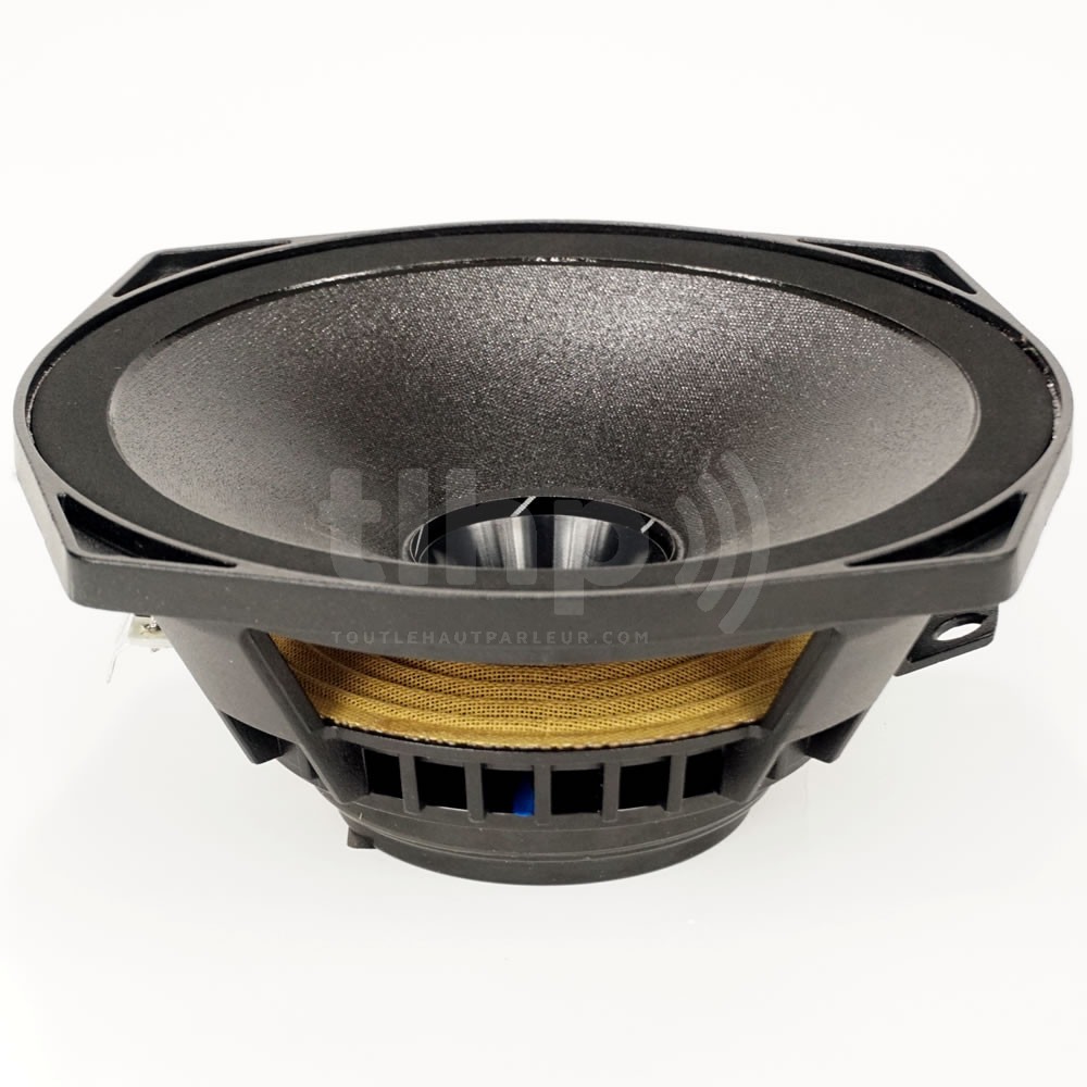

It looks like PHL has high quality coaxial woofers with a short horn, optional compression driver entry, and a special foam surround intended for HiFi. However, I'd be concerned about the foam surround durability if the coaxial is modified into a multiple entry horn. For a regular coaxial home use it looks like one of the better options. They make it tempting to forgo a MEH modification.
https://en.toutlehautparleur.com/sp...16-ohm-8-inch-without-compression-driver.html
