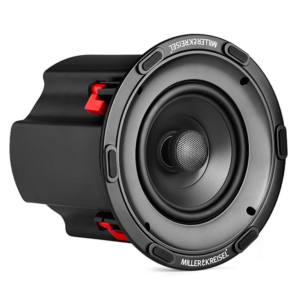

I've noticed that some coaxial 2 way speakers have very good performance and come with a proprietary metal back can which is very deep. These back cans come with some sort of polyester fibre fill in them. It looks like the stuff they use in pillows and cushions. I'm sure this is possible to get at an upholstery shop.
Hoping some experienced speaker building enthusiasts can help me. I want to build wooden boxes for these coaxial speakers with the objective of reducing their depth but preserving their sound signature. Hence, I have some questions:-
  1. Do I calculate the volumetric area of the back can and preserve that volumetric specification when calculating the box size?
  2. Is the volumetric specification important or is it ok for me to exceed the volumetric specification a bit as long as all the speaker boxes are built the same?
  3. How do apply the polyester fill and hold it to the back? - I'm thinking of incorporating a wire mesh to hold the fibre to the back surface.
  4. I would just incorporate speaker wire terminals at the back of the box, air-tight them with silicon. Is that a good approach?
  5. I'd love to achieve a final depth of between 4" to 6". I presume this is enough to accommodate for the woofer driver excursion.
My objective is to use them for home theatre. Building a box that is wider and higher but has less depth will allow me to wall mount the speakers.
Attached is an example of a coaxial speaker and metal back can.
Any input and help will be appreciated. I'm sure fellow members have tried this.

The can is optional, the "sound signature" (the frequency response) depends on the enclosure size.
The IC95 speaker is only 87dB 1w/1m (4 0hm, 2.83v 90dB), it will max out at ~109 dB one meter (at a bit over it's 150 watt rating), 103dB at 2 meters, pretty light for "home theatre".
The the cone size with surround is ~5.5", it would probably exceed Xmax ~106 dB 1meter at 100 Hz, under 100dB ~70 Hz (94dB at 2meters).

Making the enclosure larger will allow the cone more excursion with less power.
The IC95 co-ax is based on the 6.5-inch mid-woofer used in the MPS1620P, which uses a 12.6" x 8.3" x 11.6" (external dimensions) box that can be operated sealed or ported.

The woofer excursion is limited by it's (tiny) surround, not by box depth.
The IC95 speaker and crossover is designed for flush ceiling or wall mount, so a wide, flatish box would work best.
The swiveling tweeter is a cute feature to point at the listening position when the woofer isn't.
