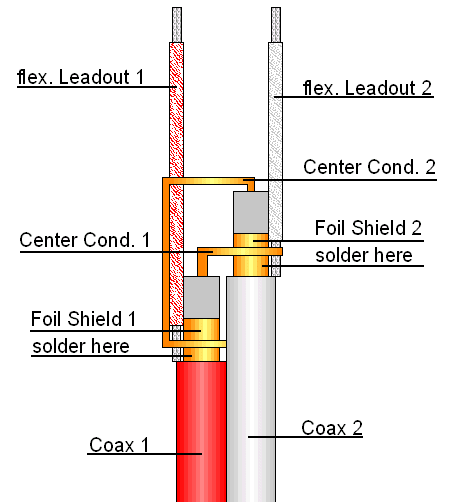

From Sanders' description (but having not seen his ESL speaker cables in person) I had assumed they were of the 'Ubyte-2' type, as attached pic?
Is this how you built yours, Charlie?
No, my cables are not the dual coax configuration shown in your illustration. I've seen this illustration before and I think it was some guy named John Hirsch (?) that came up with that idea.
I am not certain Sanders uses a single coax cable, but as I recall, the description if his white paper mentioned a return conductor spiral-wrapped around a center conductor, with a dielectric separating the two; which sounded to me like a single coax cable. Also, the review I read for the Sanders cable said only that it was Mogami 3082 cable (no mention of it being a dual coax cable), so I figured Sanders' cable would be a single Mogami 3082 coax cable, and that's what I built.

John, what do those cables look like? A single cable, or two side by side?
A single Mogami 3082 would make ~14AWG cables, while two would be ~11AWG, which sounds a bit more substantial.
I have two - one for the ESL and one for bass. The one for bass was thicker and two cables, while the esl was a single (me thinks). I will take a pic later and post.

I'm now using the Mogami single coax cables on the woofers and these DIY cross-connected dual Belden coax cables on the ESL panels.
