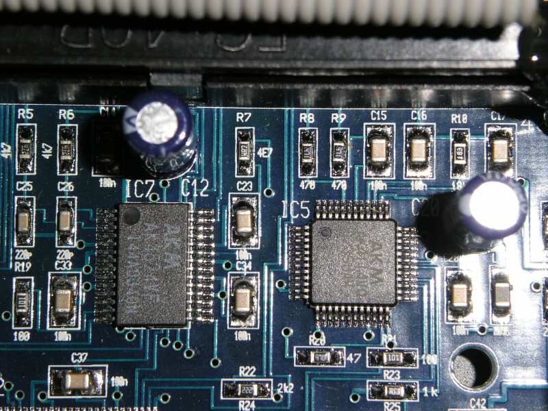

I think it would be possible to tap into the ak4114 RX0/RX1 input for the coax in. Refer to page 22 on ak4114 datasheet for the optical receiver input (with 470R) which is same as the optical circuit in deq2496.
It looks it I can solder a coax wire on input side of the 470R resistor (connected to the RX1 pin of ak4114) and put a 75R across the coax wire and put a BNC at the wire end and I am done.

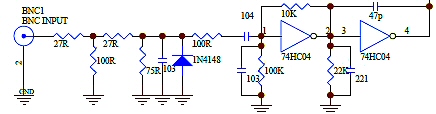

It would be great if someone confirm this and can be replaced by
BNC-> (75ohm across) -> digital tranny -> 0.1uf-> AK4114 RX0 or RX1

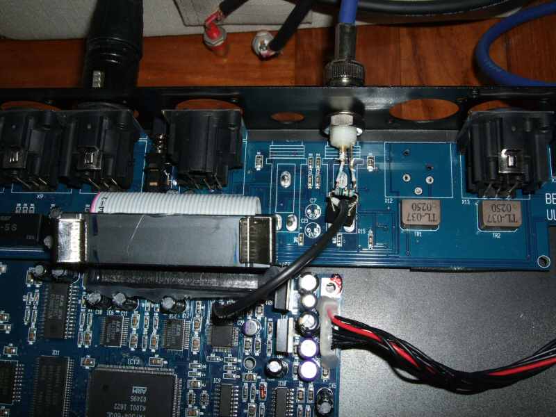

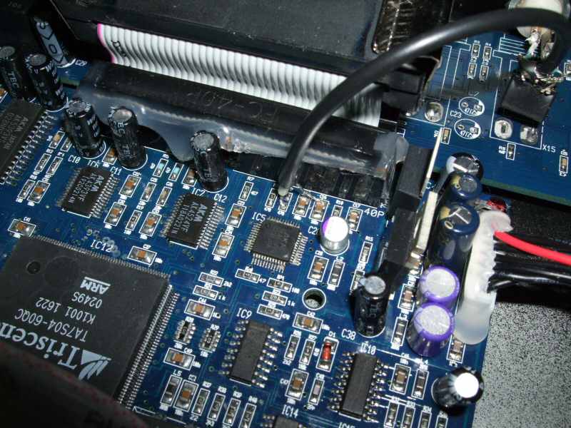

It works. It is very simple. I solder a coax cable with signal to C15 and ground is C16, add a 75ohm and bnc or rca and I am done.
I believe the R9 (470ohm) will need to be remove too for correct 75ohm.
My 2nd deq2496 is making sound now using coax input (I kill the 1st one a while back).

The 470ohm is removed.

The aux out is removed for the bnc connector. A C&D DA101 tranny added.
