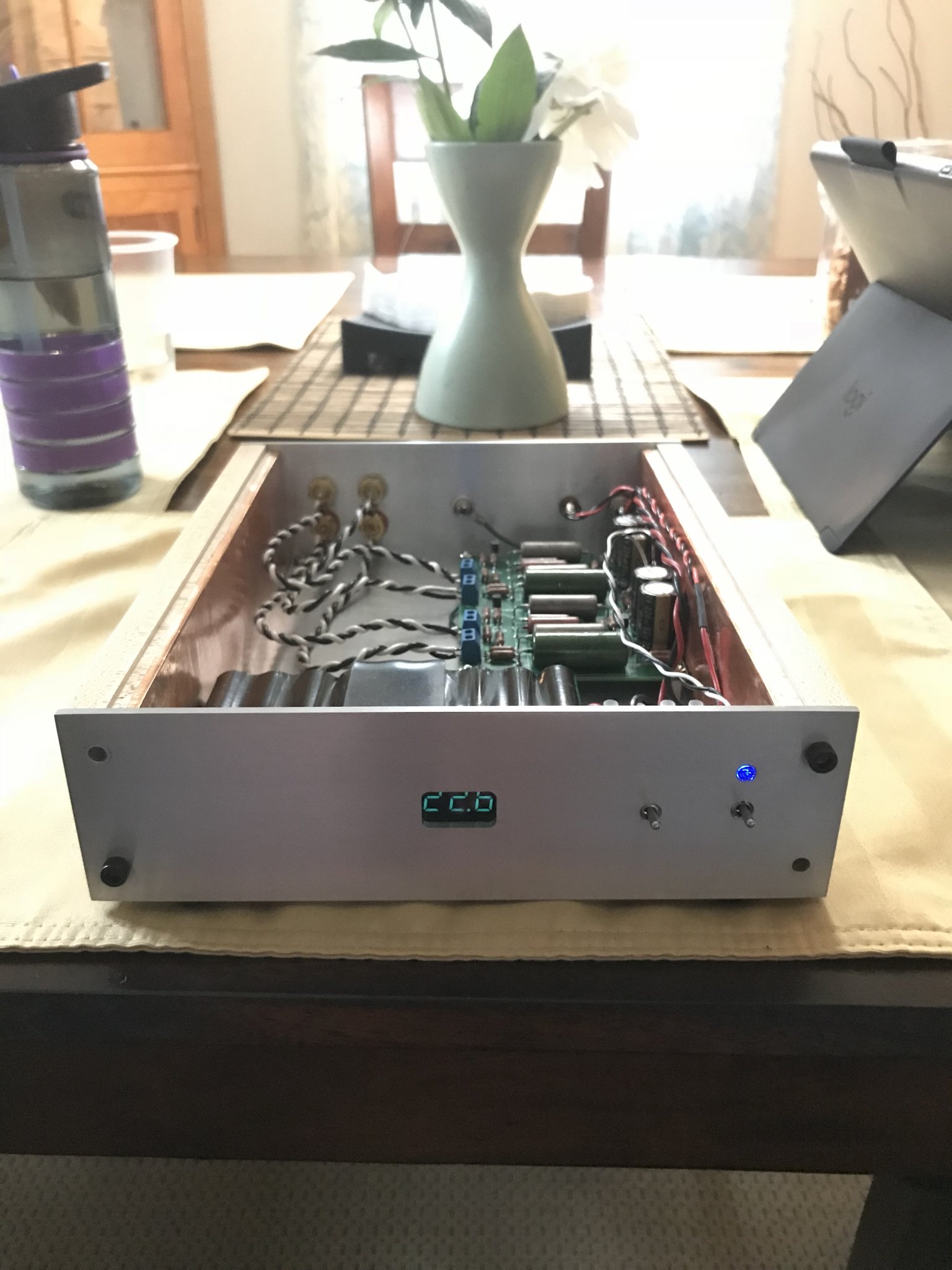

I’ve done a lot of fabrication for different audio projects over the years in wood, aluminum, brass, copper etc.
I always preferred a minimalist approach for a protective finish on my projects.
I used to buy what they they marketed as “Butcher’s Wax”. Last time I went looking for it I found the same type of product marketed by Rustoleum.
Rub on a thin layer with a damp cloth. Let it dry for a little while and then buff it to a shine of your liking….or don’t
It has done an excellent job of protecting surfaces that can oxidize over time.
I did a phono amp project almost ten years ago where I lined the inside of the wooden “cheeks” of the cabinet with copper foil.
The copper is still free from any oxidation and has its original shine.
