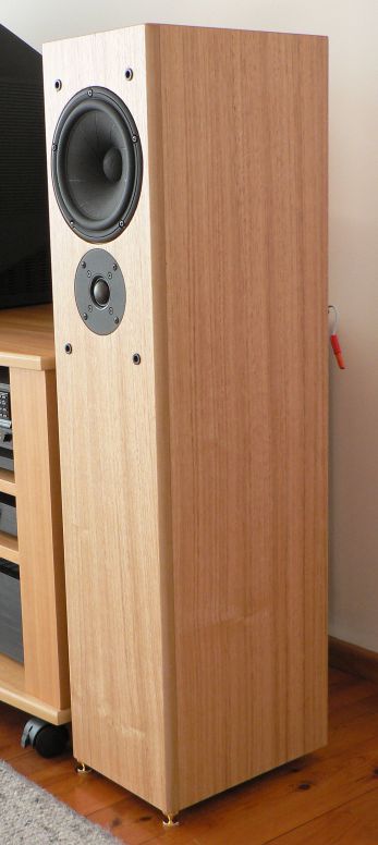

rabbitz , thanks again for the photo - that is the one I saw in the other thread we conversed in -{"2-way with 8531G Revelator"}- and was refering to here-above .
I would like to try a curved baffle - sides at least - to reduce the diffraction effects' result of crossing the tweeter over fairly low as it will radiate 180 degrees there . I'd like to curve the edges of the top also , but to do both with large radius will be difficult - I'm still thinking about it .
