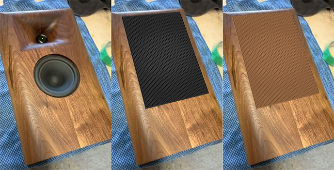

Grill options (though I think it's a shame to cover up the waveguide!)

Cool renderings - I missed the edit! I agree, that waveguide is too pretty and sculpted to cover it. It could be interesting to do a simple round fabric cover for the woofer and leave the tweeter bare too.If Troy/Joseph machines the enclosure panels for you, the rest should be as simple as any other basic DIY kit. The only other 'tricky' part, depending on your experience, might be the crossover assembly. Does he offer pre-built crossovers too?
