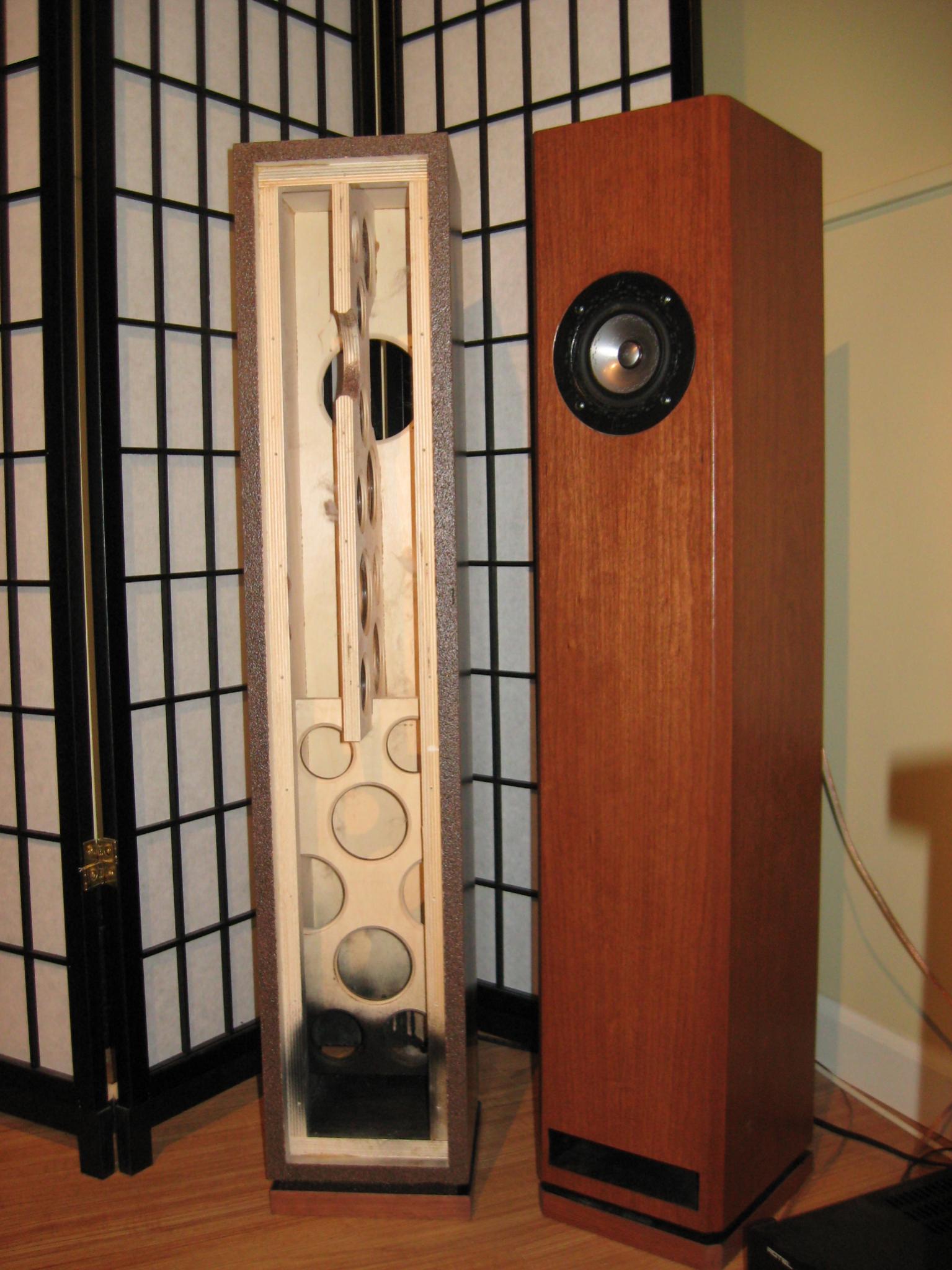

The pensil port is rather high and preferred to be directly on top of the bottom panel so as not to create further turbulence down there......
Great work, by the way, on both baffles.

Is the internal width of the enclosure too wide? Or did you keep the same vent area while reducing its width? Just checking. Also agreeing with JoeyGS's comment.
I would err on having more structural rigidity for the moving driver. Remember those gaps between the tabs are going to be blocked anyway by the gasket and driver frame. A small 5mm chamfer would suffice for airflow behind the driver without impinging on the fixing points - the CNC routing should be more than careful enough.
IMHO, Baltic birch is the best loudspeaker material - Corian is a dead material for dead sound (and the cutting costs could be massive - particularly with quickly blunting the bits)
One of my main principles is reducing the fore-aft reactive movement of the cabinet in response to the driver. The brace reduces panel movement from air compression - but I try to reduce panel movement from air expansion by routing channels 9mm in from the front back edges of the top and back edge of the base - rebates routed in the front and back will allow those panels to slot into the top and bottom and structurally resist outward air pressure. It does however preclude the removable feature of the back panel, stuffing would need to be adjusted by clamping on/off the side before gluing. So, overall from a product standpoint you may prefer your approach.
No - use D-Nuts not T-Nuts. It's either the M8 or M6 ones that are shallow enough to only need drill about 2/3 of the way into 18mm material. Maybe similar to the Hafele inserts you mention. Search for D-Nuts on ebay to see what I mean.

@ Andrew, the bracing for the Pensil sits in a groove in the back panel, for added strength and location.

The port is the right dimensions, but is somehow too high.
I think the wood is just about enough to grip the driver. Perhaps a extra piece should be added to the files that would locate over driver cutout, just worried that an extra 18mm even with chamfers may affect performance. The grooves should help construction, as there is only one way it can go together and will nest nicely with lots of glue area.

Understood that a removable back is required to optimise the stuffing. Personally I'd optimise (holding in place with clamps) and then glue it.The P10p kit is designed to have a removable back. I have found some really nice Hafele expanding brass inserts that would take threaded bolts rather than scews, so the backs can be taken on and off as much as you like to adjust stuffing. The picture from the side was just to illustrate how it looks in Xray mode.
I don't think we can do the T nuts, unless they go all the way through (as its machining the rebate for the baffle from the inside face), and may be more of a pain to fill them if not needed. Perhaps a sexy outrigger stand could be designed and sold as an add on.

If the intention would be to veneer (or apply any other facing to) the front panel, might it be an idea to reduce the depth of the driver rebate so that the front of the driver frame remains flush.

Vent should be right at the bottom... created by making the baffle short enuff to form the vent.

We'll lower the port on the next one. Cabinet is wider than normal to allow for the bracings displacement. but the port is the size depicted on the drawing. Just in the wrong place somehow!
Annoyingly the engineer put in the driver dimensions with the cover ring, so the rebate is about 2mm too low as well. I will alter it to allow for the .6mm veneer, so it will either be perfectly flush when veneered or a fraction proud if bare ply. Ill shim this one up and get it painted to hide the ugly ply.
