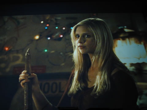

Hey looie are those pics of the lcd or screen? can you take some pics of your setup lights on etc and of the projected surface with something in the pic to be size representative? thanks and great job.😀

all of the pics are of the screen, not much point i can see of showing pics of the LCD.

Video Freak said:Hey looie are those pics of the lcd or screen? can you take some pics of your setup lights on etc and of the projected surface with something in the pic to be size representative? thanks and great job.😀

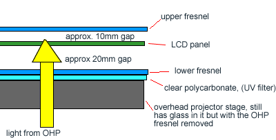

This is a cross section of my setup.
VvvvvV,
yes.. actually, i did all sorts of tests with the lens configuration and this was the best for me. i was following that other thread with the debate about split lenses. i would recommend testing different configs to everyone as this seems to be more of an art form than exact science 🙂
my observations were..
1. when putting the LCD (raised about 20mm above the OHP stage because of the PCB) without removing original OHP fresnel. the LCD got hot because all the light was focused on it and only about 3/4 of the LCD was lit.
2. putting the fresnel unsplit directly behind the LCD was awkward for my particular setup. but some rough testing showed that it still heated up the LCD and i still had some of the edges of the LCD unlit.
3. After I removed the OHP fresnel and set it up as above. I immediately got full screen and the LCD was not as hot. There is a bit more blurring towards the edges but to so much that it was annoying. The picture was brighter too. However, you could see some rings from the fresnel. after i put a 10mm between the top fresnel and LCD, the rings where gone but it will reduce your brightness level somewhat. i ended up just using clothes pegs to make the distance. Also, the color temperature adjustment on the OHP just happens to allow me to get the right focal length on the bottom fresnel. (all it does is move the lamp up and down)

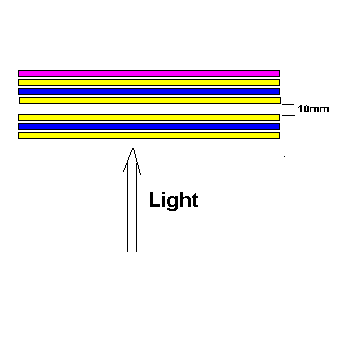

Hi Looie,
Good to see your setup is working so well.
I don't want to start the split vs non split fresnel debate in this thread, however I did find the image to be significantly sharper when both fresnels were placed before the LCD.
I know you had trouble trying to get the whole LCD Shown on your screen because of the PCB. Did you try flipping the LCD so that the light enters from what originally was the front of the screen?
My setup is as follows,
yellow = 6mm Low e glass (very transparent)
blue = fresnel
pink = LCD
this setup allows me to place the LCD very close to the top fresnel and I hardly lose any of my screen area. The amount of glass I have between the LCD and the light also stops the LCD from heating up.
blue = fresnel
pink = LCD

what is 6mm Low e glass and where can you get it? the polycarbonate works very well but i wonder if glass will be better at stopping the heat.

Low e glass is made to absorb as little light as possible, much less than regular glass.
I got mine from Pilkington glass (they have stores nation wide), You can get 3mm sheets if you want, they only had 6mm in stock when I went to see them.

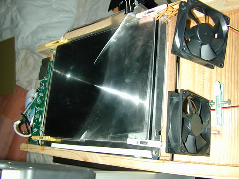

CMV 1515
Hi Looie, Brainchild
me and a few other guys from Germany bought that CMV 1515 display you were using for your projector. We saw your great results and now the 1515 is almost the reference for 15" projectors here, as these screens really rock.
Unfortunately no one has finished his projector here as we are just in the process of disassembling the displays.
Basicly we are very happy about the displays and with the results so far.
I were just wondering whether you solved the problem of that short ribbon cable in the right corner of the bottom of your tfts already and if might know a supplier, who sells lager ones.
Kind Regards
Kind Regards
Hi AirPlus, I'm using my CMV in an enclosure which doesn't necessitate lenghtening the cable. LOOie came up with some arrangement for his OHP route.
