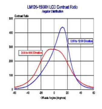

Too bad we don't have the datasheets for the CMV1515 panel to see what the optimal viewing angle is. (Btw, is it possible to build a DIY light intensity meter? What kind of sensor is used on them?)
I am still 100% sure that the (cone shaped) light from the collector lens (through LCD to pj lens) which hits the LCD at different angles at different point of LCD will cause hot spotting and uneven colors. Or is the CMV1515 panel so different to others that it's contrast doesn't depend on which angle the light hits the LCD? Seriously?
Without measuring the light intensity (at different points and angles) it's just a guess, but on the other hand CMV1515 *does have* specs for vieving angles, which means the angle within the CR is >= 10:1.
The viewing angle in case of a 15" LCD ( width = 300 mm ) with 13" FL (330 mm) collector (=field) fresnel behind it, at the horizontal edges of the LCD, is inv tan(150/330) = 24.4 degrees.
In attached image (for M150XN05 used with MaxiBright backlight) you can see the graph of CR vs. viewing angle. In +/- 24.4 degrees range horizontally (the red graph) the CR is alway better than 150:1, max. is about 280:1 at normal angle of zero degrees), but in vertical direction (blue graph) where the angle is +/- inv tan(110/330) = +/- 18.4 degrees varies a lot from 125:1 to 380:1. The best sport is at about 12 degrees where the CR is closing 450:1. In my pj the tilt is now about 10 degrees (just testing it, practically I have to lift the other edge 47 mm for 12 degrees tilt) so the CR is about 430:1 which is excellent 🙂. So with this panel you can get even CR only by using collimated light source (one fresnel with the point source light in FL of it, for an example).
I haven't seen the CMV1515 but I gues it isn't far away from the BenQ TFT. If you have the monitor and watch some DVD with it (direct view as monitor, not in pj) you can vary your viewing angle to see what is the best viewing angle for it, where the black is blackest and light has most intensity (usually these two black level and intensity have different graphs) and let your eyes tell it.
