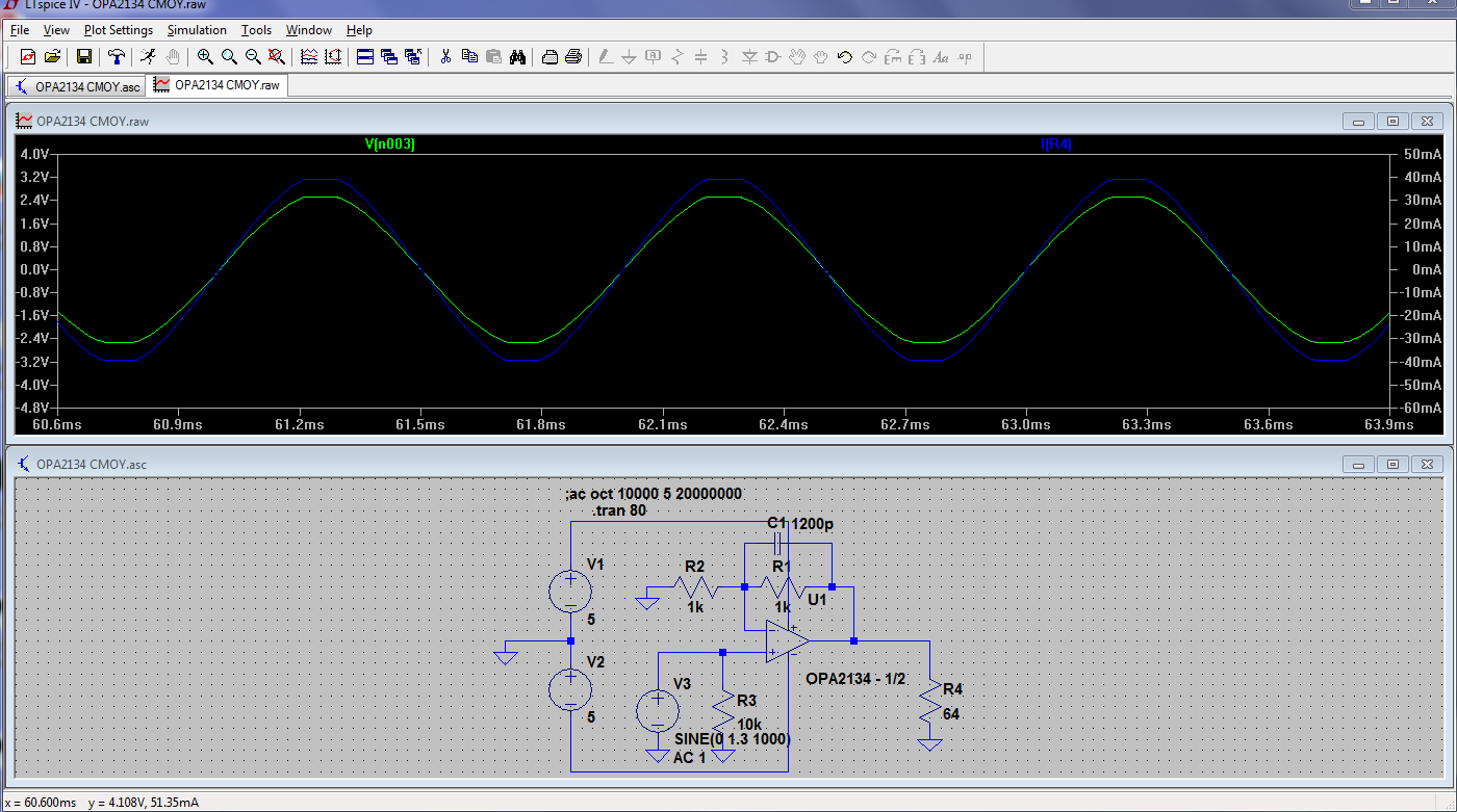

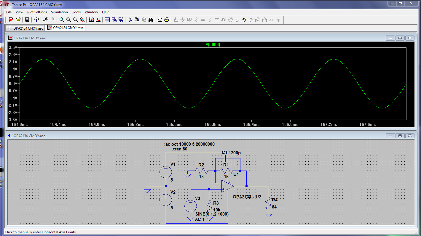

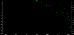

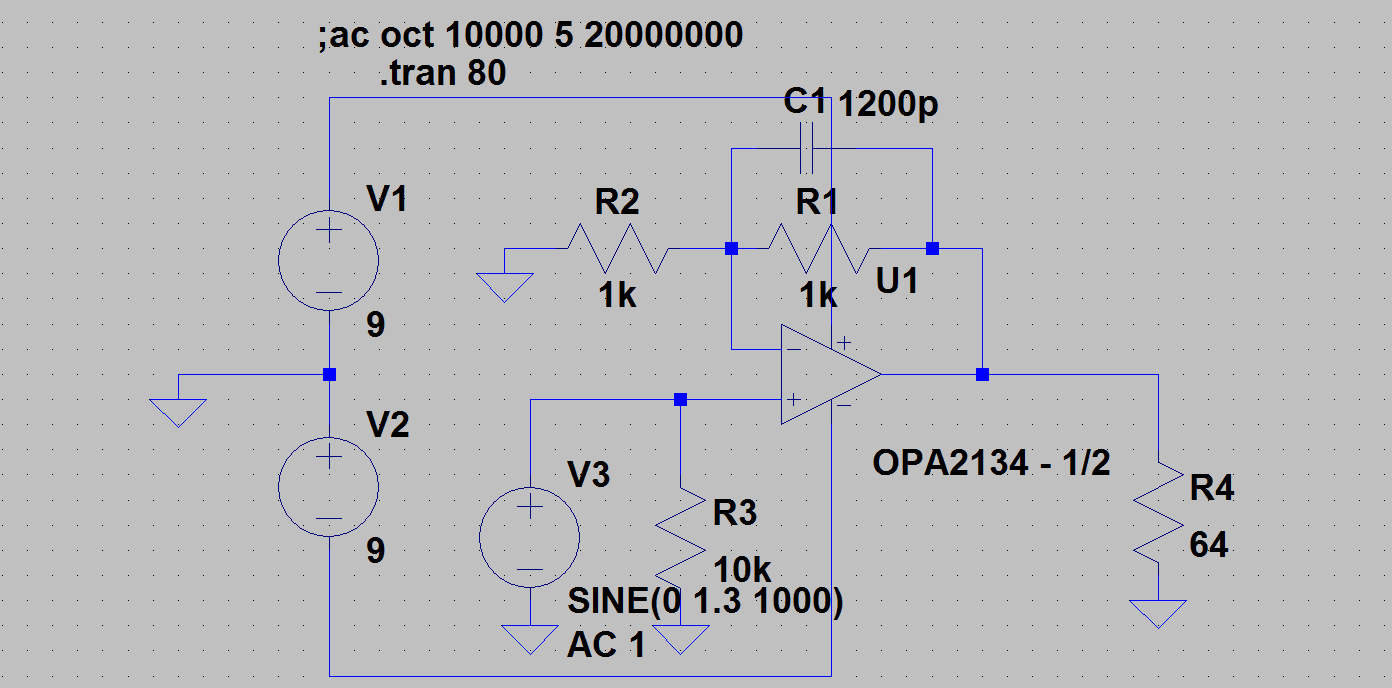

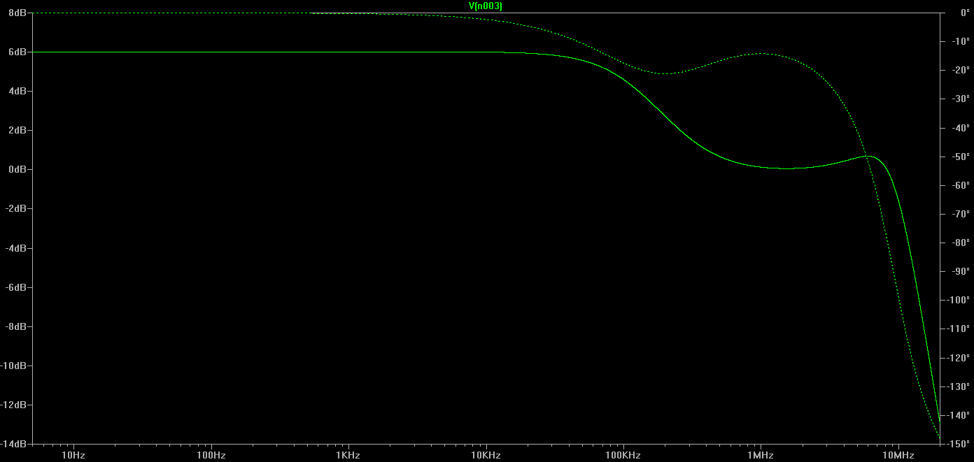

Below are a couple of LT Spice plots with the OPA2134 Spice math model.
The first is the AC plot, showing that with 1200pF the gain starts to drop at 10KHz, but just very slightly. 1200pF should be OK and so is silver mica. If you have a smaller value kicking around though, like 1000pF or 820pF, that would move the start of the gain drop out past 20KHz.
Interestingly enough +/-5Vdc supplies don't seem to make any difference with that chip vs. the +/-9Vdc, at least as far as the Spice model is concerned. The actual non-simulation results will probably be different. 🙂 I would have expected clipping against the power rails to start a few 100mV sooner with the lower +/-5vdc rails. But the Spice plots for both +/-9Vdc and +/-5Vdc Show the start of clipping at 1.3Vpeak (=0.91Vrms), which is half way rotation on a 10K volume pot with the 2Vrms input.
One suggestion would be to put a 10K resistor in series with your input. That will form a 50/50 voltage divider with a 10K pot and drop your 2Vrms input down to 1Vrms. That will insure that you never drive the stage into clipping past 1.2Vpeak (=0.84Vrms).
The first plot below is the AC plot with the solid line being the gain and the dotted the phase. Next is the transient plot with +/-5Vdc power supplies and a 1.2Vpeak input, just before clipping. The final plot is +/-5Vdc suppies and 1.3Vpeak, into clipping. The transient plots with +/-9Vdc rails were exactly the same, oddly enough, with 1.3Vpeak still being the onset of clipping.
The reason the amp starts clipping is the current output capability of the op-amp gets exceeded. In the 1.3Vpeak plot I've also plotted the current through the load, which is the blue trace and right-hand scale. You can see that at the 2.5Vpeak (=1.77Vrms) output level (2.5V/1.3Vpk = approx gain of 2 = 6dB) the peak current is 40mA, just all the chip can handle. Even then the chip might be past its power dissipation limits for that DIP8 package. You would have to do some math on that - or just put a finger on it and make sure its not overheating. But with the high sensitivity of your headphones you should not need to crank it up to anything near 0.9Vrms.
