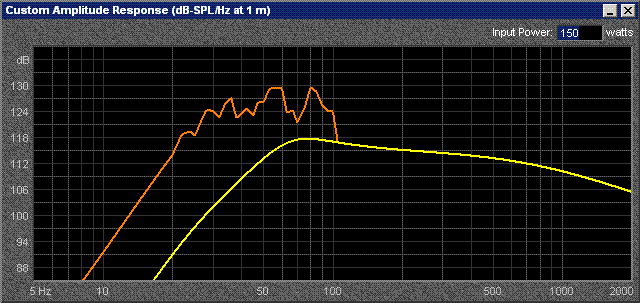

will the graph response inside the car be the same as outside the car??
Out of curiosity, what does it matter what the 'graph response' is outside the car? That seems to me like asking if a speaker's frequency response will be flat in another room... or a reflection of your TV screen in the hallway mirror will have a good colour balance.
rollin24's said:will the graph response inside the car be the same as outside the car??
Yellow plot is "outside" the car, orange is inside with cabin gain added, cabin gain data is derived from actual in car measurements of a large sedan with the subs located in the boot.
