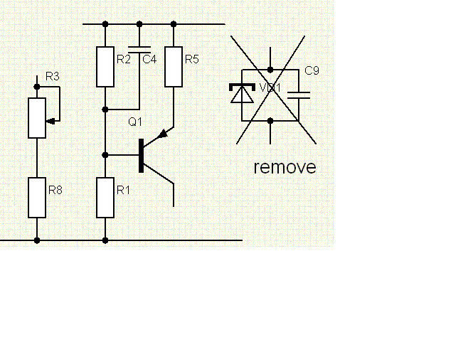

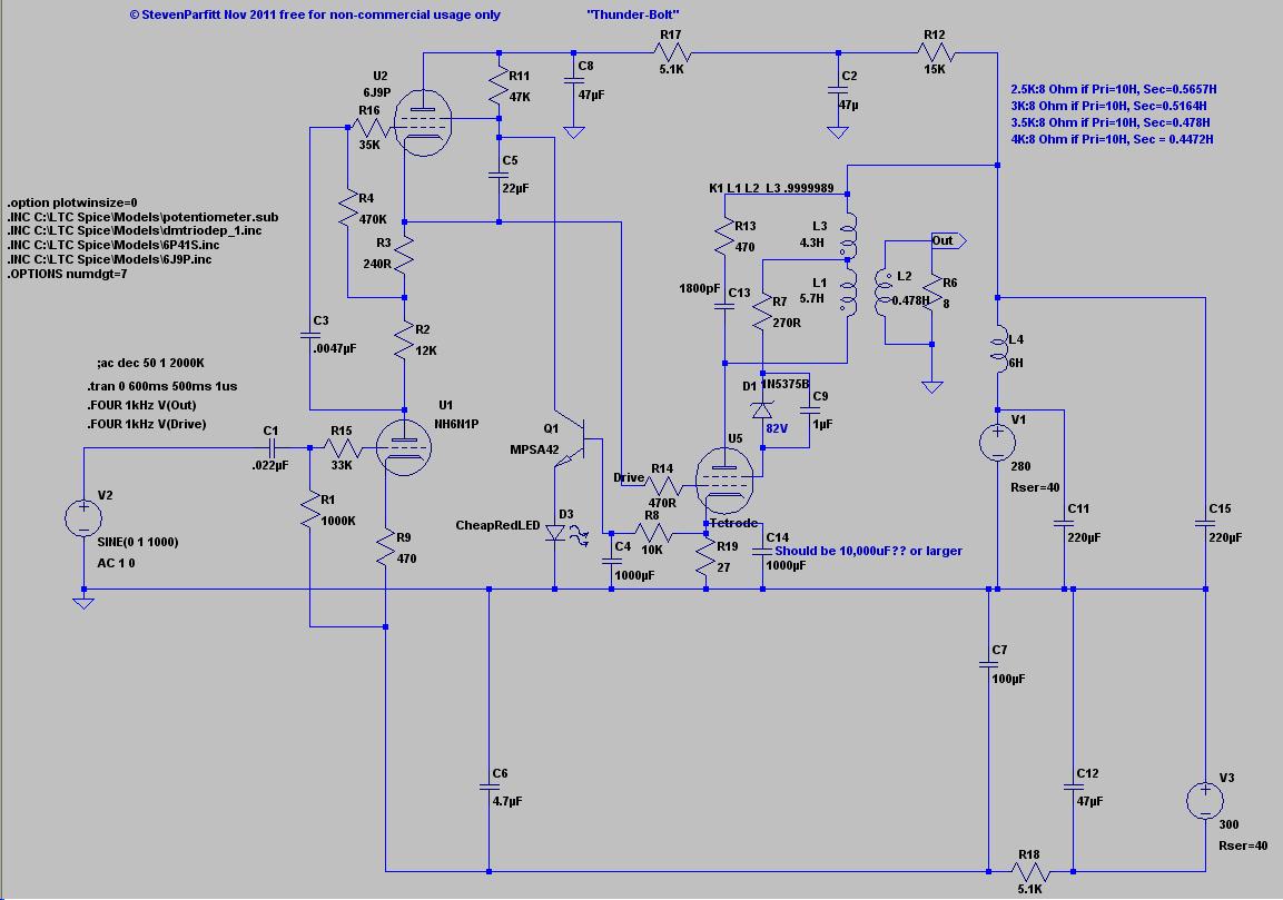

I haven't had a chance to breadboard it yet, but simulations show greater distortion with the screen controlled servo amp than the cathode controlled servo amp.
Too much loop gain again. Try 10-50 ohms in series with D3.
jan didden
aeandm, the Zener diode actually works on the breadboard. It keeps VGs near 180V. Max screen voltage is specified as 170 for the 6P41S, and it I allow it to go much higher bias voltage must go much lower.
I do not understand your schematic. Am I supposed to bias the screen at a fixed level with the circuit shown?
janneman, I added 33 and eventually got it up to 51Ohms. that helps. tks.
Ask colleague Wavebourn translate: Мне не понятна схема где питание драйвера
связано с раскачкой выходного каскада, на транзисторах реализован эл. фильтр, зачем сигнал подан на него(33К) и где минус фиксированого смещения? Поэтому и предложил временно упростить, может я

This has been a rather interesting exercise. So far I've only had time to run simulations and it will probably be the weekend before I can get my tubelab back on the bench to verify the results.
Both circuits produce the same results (or so close as to be the same) given that the anode current and grid to cathode voltage are the same and the screen voltage is adjusted to produce the same cathode current. The input voltage is nearly the same to produce the same output voltage under these conditions.
Unfortunately both produce fairly high distortion (25%) at 1W, 2.8Vrms into 8 ohms.

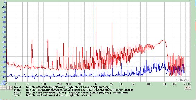

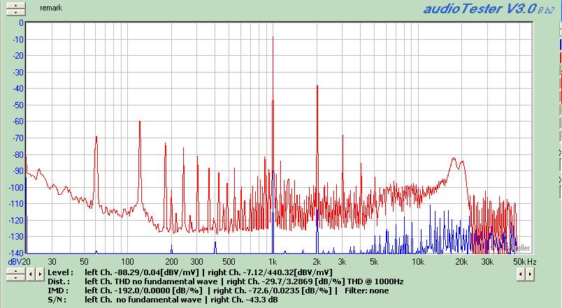

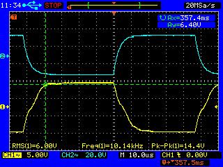

True Anatoliy, however the actual circuit is producing slightly more than 3%thd+n at just over 1W out with mostly 2nd order harmonic.
When this plot was make there was a lot of 60hz hum and harmonics, and what I believe is an oscillation up near 20KHz. The amp sounded better at 85ma than 60ma.
What would consider more optimal?
I like the screen control better as it is more elegant (simple, concise). Both methods achieved the same result, although I will concede that cathode voltage control is more of a brute force technique.

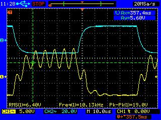

I'm using a GSXE15-8-3.5K transformer and had some issues with opt resulting in a constant oscillation around 130KHz.
A Zobel stabilized it but it is marginal as implemented. Increasing dampening results in greater roll off of high frequencies so it is a tradeoff.
There is a discontinuity at mid transition that looks like crossover distortion. However, this is a SE amp not a PP amp. This is where an oscillation initiates when no Zobel is present.
Frequency response is good, in part to use of a 15W transformer in an 8W amp.

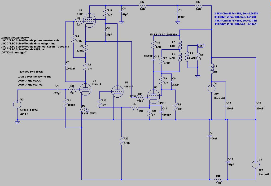

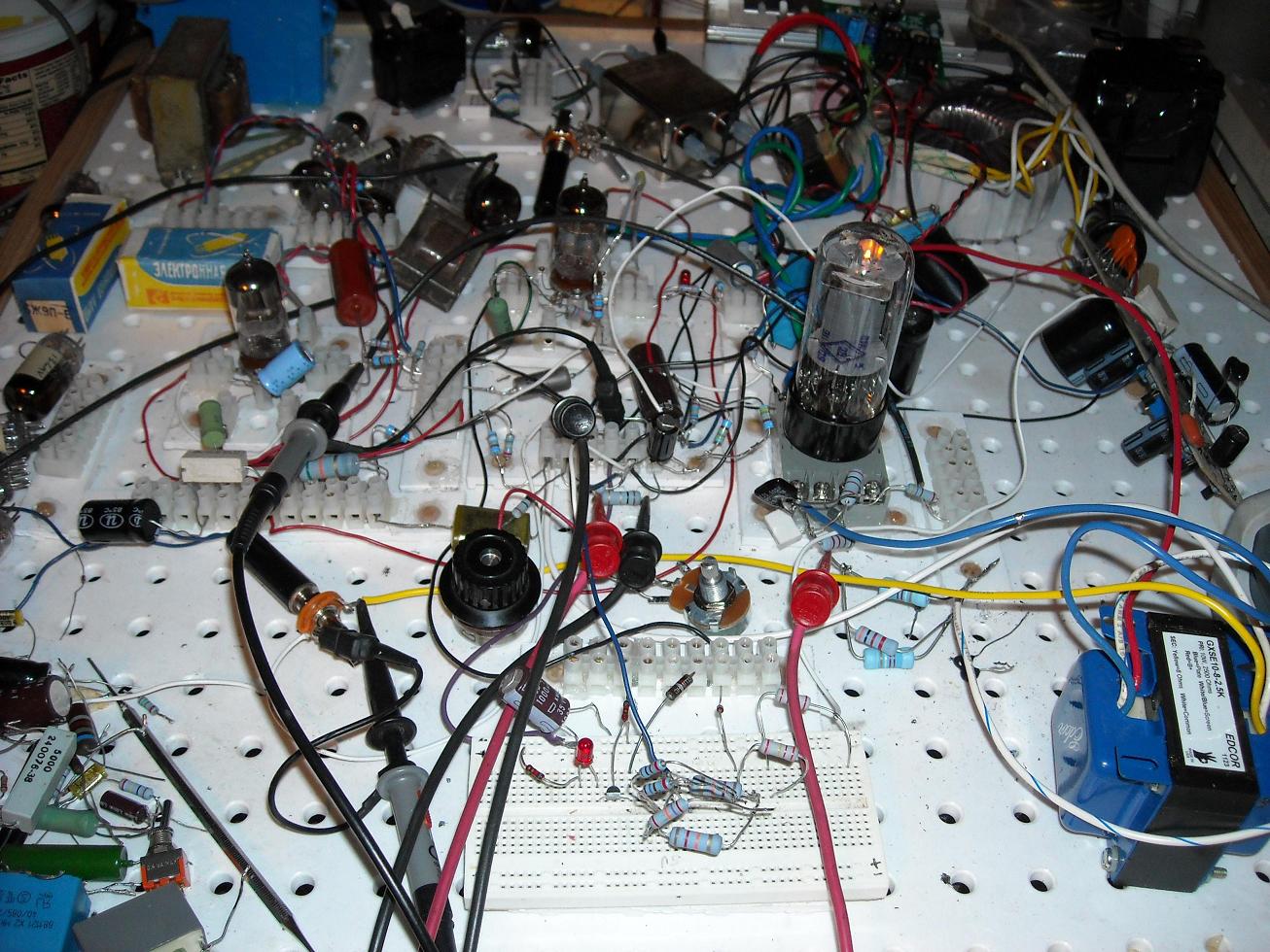

I ran into an interesting configuration tonight. Distortion is almost totally 2nd harmonic at 1W out and if I remove the 2nd harmonic from the FFT I only get .0028%thd.
Max output is near 6.8W before clipping.
Anyone care to guess how it is configured?
I've found that there is not one configuration (set of bias conditions) that result in minimization of upper harmonics, but rather it appears that there may be a curve on which this occurs. There may even be several curves or a multidimensional surface over which this occurs as I've found a large disparity in trying to plot a curve. I suspect I need to fix some variables (Va, Vg, Vs, Ik, etc) in order to minimize the variation.
It is not just that 3rd is minimized, but all the upper harmonics vary with adjustments while the second remains at virtually the same level.
Ignore C5, it was removed.

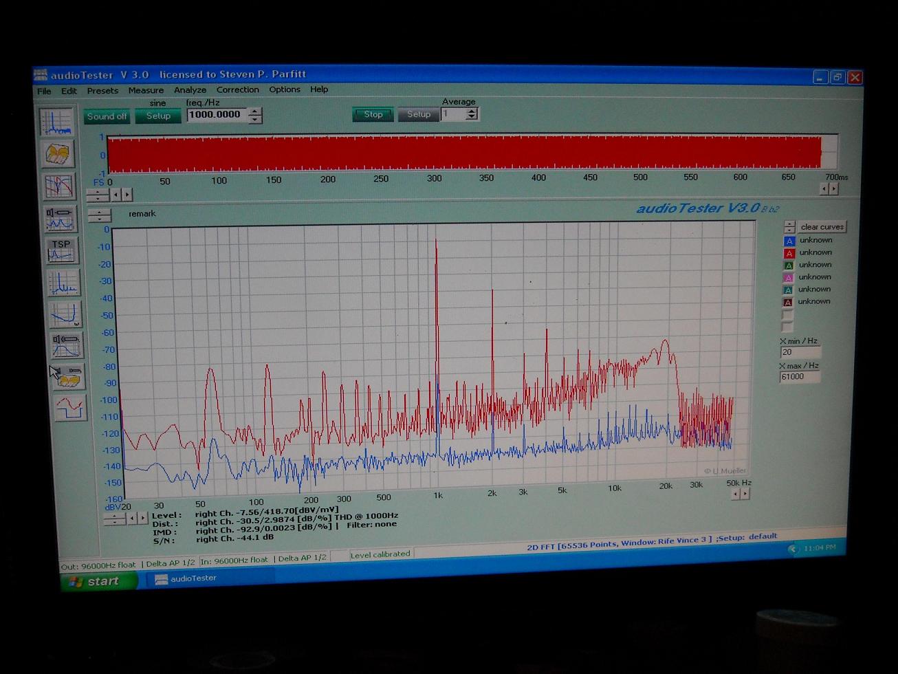

I switched to a regulated 250V supply and strapped the 6P41S in triode mode before trying the 7027A (I don't have any EL34s). I got less than 2%thd at 59mA Ik. If the second harmonic is excluded, distortion drops to less than 0.01%
The Mu-stage itself is putting out 0.33% distortion at 13Vrms drive to the 6P41S at 1W out. Minus second harmonic the remainder account for 0.05%thd from the MuStage.
I then tried the 7027A in triode mode at 250V B+ and got over 5%thd at 82mA as the best results. Again the odd harmonic distribution can be adjusted but not nearly as much as the 6P41S.
Finally I tried a 6P3S (not -E) and got 2.9%thd at 63mA. Excluding 2nd harmonic I could minimize remaining harmonics to less than 0.16%thd.
The first photo is a screen shot of the distortion with the 6P3S. Note that the 3rd, 5th and 7th harmonics are below the 2nd, 4th and 6th. This is what I find interesting. I can change the bias and they will track together while the 2nd harmonic does not change at all.
