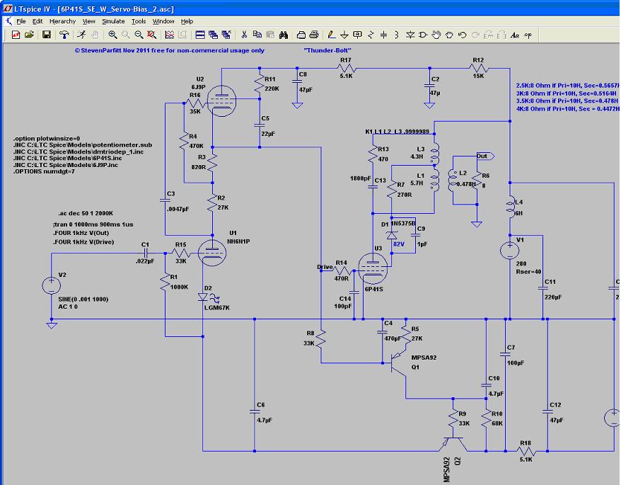

I'm still working on my 6P41S amp with a servo bias amp, but have run into a stability problem with the servo. I'm breaking the servo out as a separate issue from the 6P41S SE amp as it is my main issue and the 6P41S amp seems to be coming along fine.
My goal is to make an amp with a Mu-Stage for the input driving the 6P41S in SE mode. I will continue my observations on the 6P1S in the original thread. I am hoping to elicit discussion on servo here.
The schematics are the full amp, and the servo. The servo is sufficient for discussion (help?).
I vaguely remember stability criterion from 30 years ago in college. Regrettably I have forgotten much.
The issue is that if I increase the input capacitor (C1) above 0.047uF the system oscillates (instability). This was demonstrated in the strange plot in the original thread on the 6P41S (another SE amp)" when I changed the input cap from a 0.022 Teflon to a 0.068 PIO.
http://www.diyaudio.com/forums/tubes-valves/190797-another-se-amp-design.html
Intuitively I see that increasing C6 should make matters better rather than worse. That is, increasing it sould increase the filter capability and improve the response of the system. In reality increasing it increases lag in the system making the system less stable rather than better.
So, how do I improve the stability of the system?

It looks like it oscillates through the bias control loop. Have you tried to slow down this loop (it should be slow anyway) like putting a cap on Q1 b-c?
What's the oscillation frequency?

You need to calculate the loop gain. This is A (amp forward gain) times b (feedback circuit response). Ab, when plotted as a complex number as a function of frequency, must not loop around the (1,0) point and ideally not get too close to it either.

Oscillation frequency is 0.25Hz with the 0.068uF cap at C1. With the 0.022uF cap it does not oscillate.
I checked PCB layout. Q1 base through 33K then wire to grid resistor of 6P41S. The bias point can be adjusted by (1) adjusting R5 (acatually a pot on pwb), or (2) adjusting R11 to change current through upper pentode. The servo works and I can set the bias on the 6P41S from 50mA to 150mA, depending on the 6J9P. They seem to vary a good bit.
Your servo circuit is basically the same thing as a series regulator for power supplies. I would look into how they are made stable. My first thought would be to remove C4 and C10 and apply C10 from collector to base of Q1.
Or remove C10 and shift 2 remaining poles further from each other.

Q1 is PNP and bias is supplied from the cathode of 6J9 being more negative than ground.
Maybe using a zener instead of R5 may help things as well.

The oscillations are caused by the control loop - it's loop gain is set by the input cap, and the input source can be seen as a (low) impedance in series with the cap. The loop gain is directly proportional to that series impedance. Make C1 larger, that decreases the series impedance and that decreases the loop gain - no more oscillations. Classical.
The current position of C10 causes a lot of phase shift in the loop, exarbating the problem.
The above advice is a good start. Note that the control loop basically only needs to be a DC or very low speed loop.
You can also bang it with lots of cap at the C10 position, like 100uF or more. That'll teach it 😉
Sorry, my typo. Of course, I meant PNP. But on schematic I did not see any resistor from base to cathode, only to the anode of the preamp tube.
Anyway, 3 poles is a bit too much. I would use 2 of them with shifted from each other time constants.
The goal of the circuit is to allow me to direct couple the Mu stage output to the 6P41S.
My chain of thought was that since it is direct coupled, I can use the Mu stage to set the bias.
With the triode biased by an LED and it's anode feed from a current source it behaves like a voltage source, and it thus should be possible to control the voltage at the cathode to shift the bias to the 6P41S.
So, use the bias voltage at the 6P41S to close the loop and make it a servo.
It looks like my best approach might be to remove C10 and increase C4 to say 2200uF?
If I remove C4 and C10, what would be a good starting value for connecting from Q1b-c?

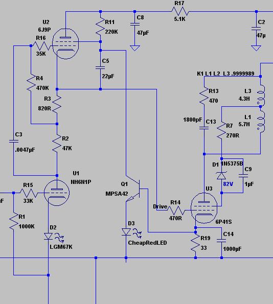

I would simplify your servo a lot, you don't need so huge OL gain; on low frequencies servo adds own distortions and instability.
Try one NPN transistor, emitter on ground, collector to screen grid of dynamic load, resistive divider from cathode of an output tube shunted by a cap to it's base.
