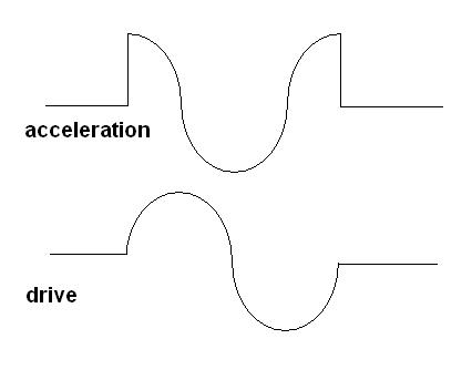

I rejected using an accelerometer for sensing because of the integration(s) required to get position.
It would be fine for sine wave vibration testing (which I did for 12 years in a test lab) but not for music! (IMHO)
I would like to see the results using a "burst" waveform using an accelerometer as feedback.
