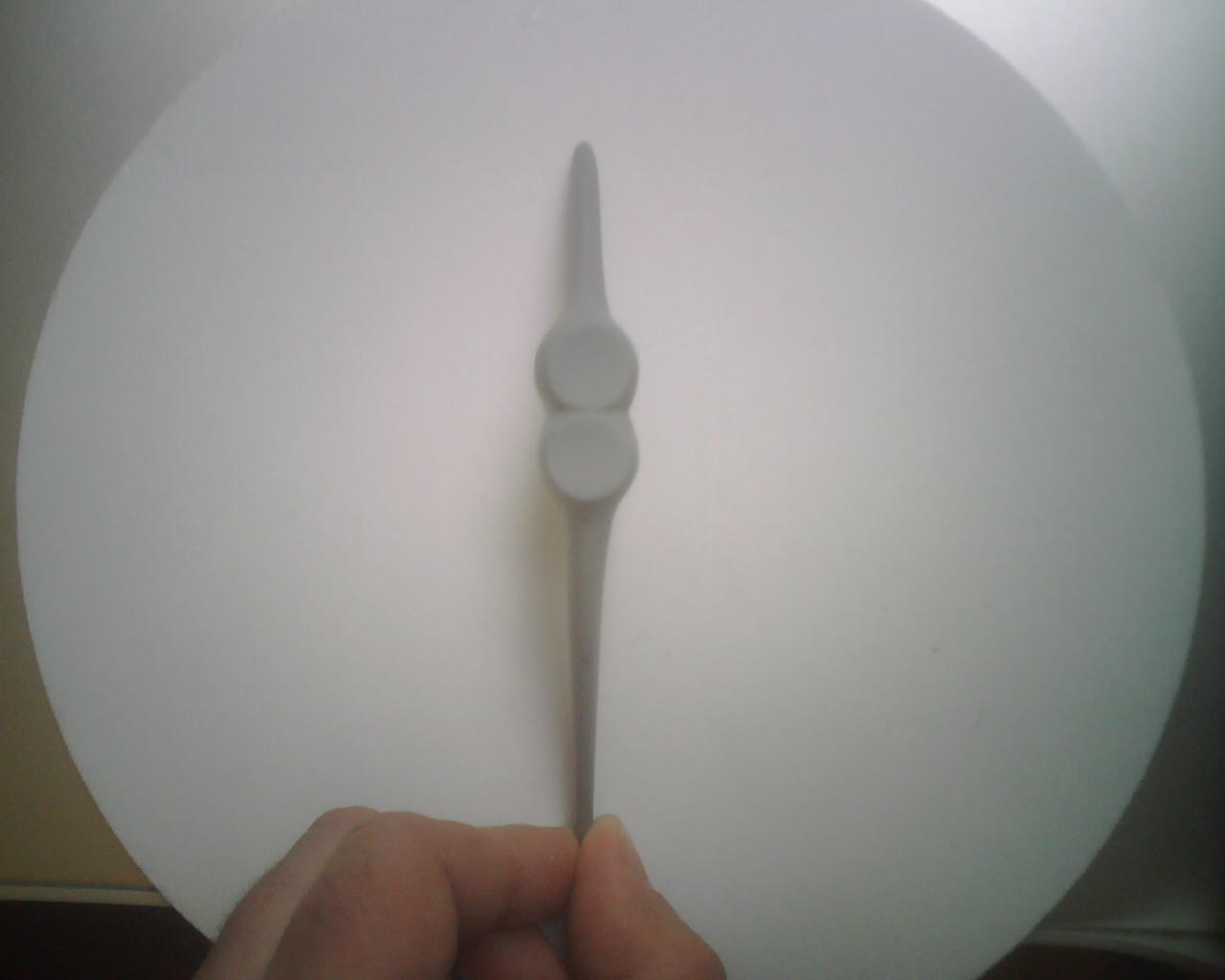

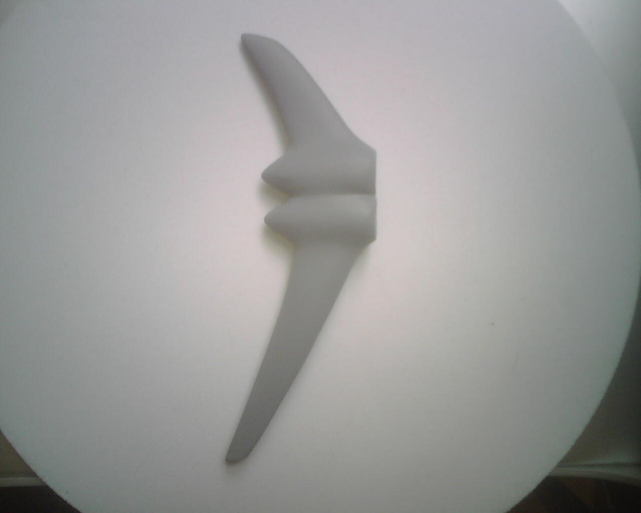

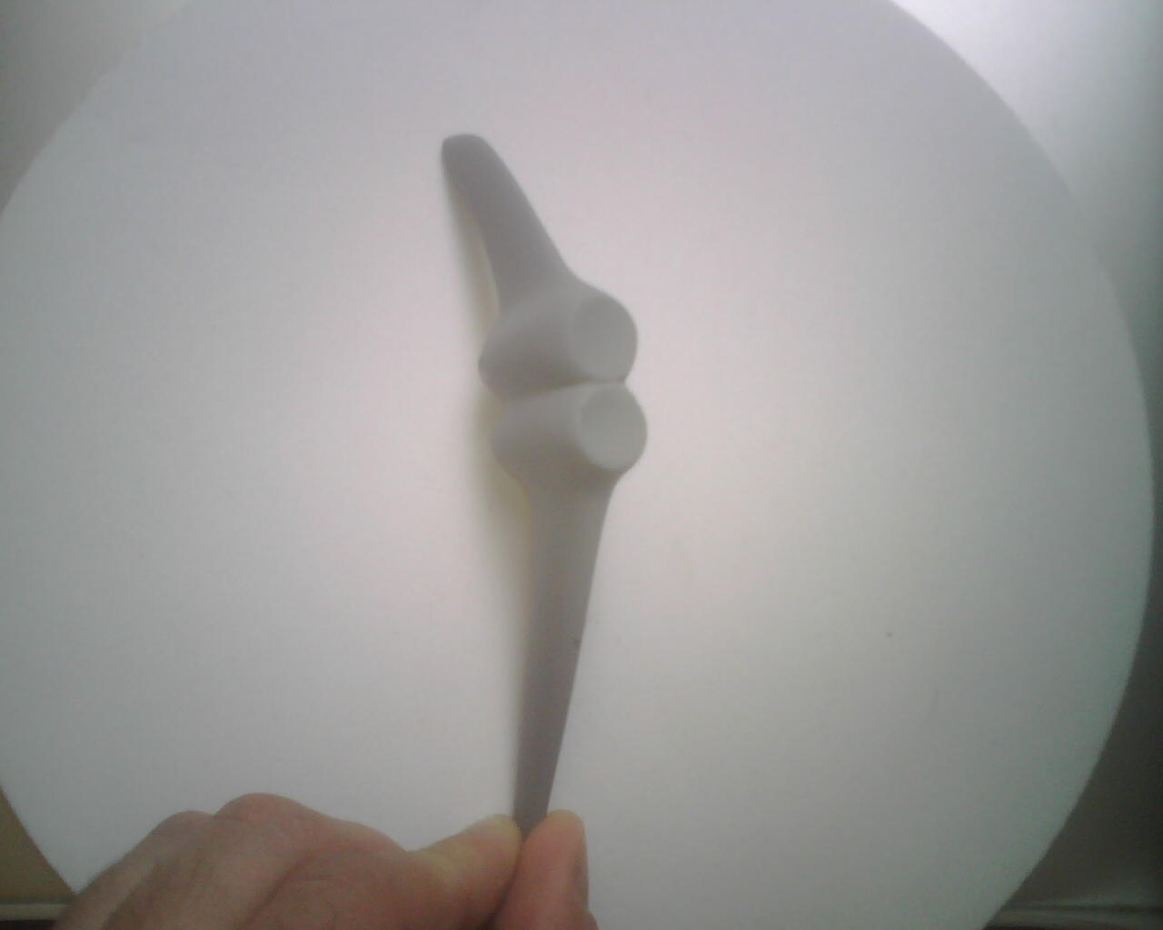

I came up with a design a few months ago(see model pics) which wd use two small FR units in a tapered double TL (and a small sub at it's base).
I wanted to use the little spiderless Jordans (which normally use a sealed box as a suspension). I am hoping a closed TL is a good solution and may also add some benefits.

It is, though as already noted it will have to be end loaded 1/2 wave (AKA plane wave tube (PWT)) to keep from having to excessively stuff it to damp its 1/4 WL resonances.
That said and without any detail technical or hands on knowledge of these drivers, IME it will damp them so well if properly designed that they may only be usable over a relatively narrow BW, requiring either a tweeter or CD horn EQ that will significantly reduce its effective efficiency.
As you increase net Vb to allow it to 'breathe', you quickly revert back to being just a near I.B. loading, so of limited use beyond cosmetic.

Hm ok, so in general closed TLs offer some benefits but are effectively narrow bandwidth, hence why the nautilus was 4 way?
The B&W would have been 4-way with or without the TL.

Net volume [Vb] determines how much output it will have and its length the tuning, so reduce Vb reduces available [mid] bass output and in general a TL's Vb needs to be anywhere from 4-10x Vas to get good bass output, so if you start at a closed point and need a 100" line, then the driver baffle area at the open end will be whatever is necessary to get the desired Vb.
IOW, if you make a TL's Vb = required for AS, then better overall to just make an AS box.
