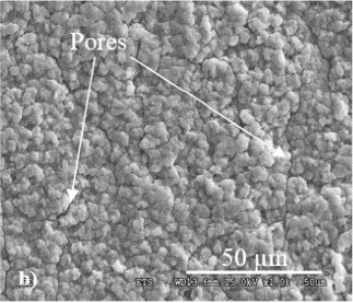

I remember one of my old physics textbooks stating that comparing the diameter of the pores in the walls of a rubber balloon to the diameter of a gas molecule was like a comparing the entrance of a road tunnel to a bee!
The temperature of a gas is a measure of the average kinetic energy (KE) of its molecules. As we all know, KE = 1/2mv^2. In order to have the same average KE as monoatomic helium, the less massive hydrogen molecules at the same temperature must be moving faster on average. Their greater speed means a greater number of hydrogen molecules will encounter and escape through the pores in the walls of a balloon in a given time. In short, the rate of diffusion has to do with the speed of movement and not the diameter of the gaseous escapee.
