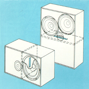

The Peter Comeau designed WD 25T EX was similar in concept to the Dynaco A35.
It's a dual chamber design where an upper chamber 'communicates' with a lower chamber via an aperiodic vent.
The key to keeping the bass tightly controlled and free of resonant booming was to adjust the aperiodic foam loading in the vent to reduce the bass resonance peak as much as possible, and use just enough fibre filling in each chamber to absorb internal reflections.

George Short, of the no-longer-existing North Creek Music Loudspeakers, researched/tested an aperiodic dual chamber system. He titled the system loading as Multichamber Aperiodic Progressive Damping (MAPD). See Post #7 in the thread below:
