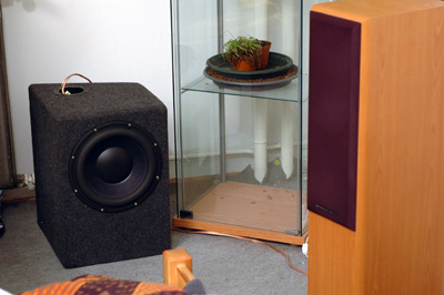

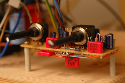

Hi guys,
I have finished my amp and sub (at least so far🙂.
It has high level inputs from my (Gainclone) stereo channels, an input buffer, a Linkwitz-transform, a low pass filter, and the signal is fed into a 250W mosfet amp. The amp is used by my band as a vocal monitor amp, so it's not hifi, and not dead-quiet, but I just wanted to try it so it will be replaced later. The box is closed, with the Peerless xls10 driver, the resonance frequency I measured was perfectly as calculated, 43 Hz. I have ordered a Behringer Feedback Destroyer which I will use as a digital eq for taming my worst room mode at 61 Hz (and maybe some others also). This 61 Hz boom is most probably coming from the longest distance in the room which is 5m 55cm. I already tried to dampen one of the walls at the end of this longest distance which helped a lot. Now if I go to the corner and listen to the bass then I can hear that the boomy sound is not there (as it was before, but just in the corner). I think this step will make the eqing also easier in the future.
Placing the sub was done with the method when you put the sub in the listening position and search for a good bass around the room. I also used the room060d.xls, and found that the place picked by ear is also reported to be a good place by the xls file.
Now the only problem I have is that the bass is best at a position other than the listening position. It's a pain to see that the spot where the main speakers sound the best is not the one where the cleanes, deepest bass can be heard. Other than this, the bass sound is far better than anything I heard before. It's not delayed, the kick drum sound comes right when it comes from the main speakers. The sub doesn't mess up the bass guitar (mid low) sounds, only adds the lower register which was missing. Stereo imaging was not hurt at all (I haven't noticed so far at least).
What I don't know is how to get the best bass sound at the same place where the best stereo (main spkrs) sound can be heard. And another thing, I'd like to get a Radio Shack digital spl-meter but Radio Shack is not taking international orders from Europe and nobody sells their products over here. I have run a search at e-bay also, found nothing but test-tone cds. Any ideas?

You don't need the subs to be right next to the mains, you can try moving them around a bit. I've experimented with using digital delay when placing the subs close, but it's really difficult to determine if it actually makes a perceivable difference. If I give the subs 100m delay it's weird and obvious, but with just 2m I can't really tell. Ideally you would have the subs located so you can't localise them as well.

Localising the sub's sound is not a problem, because now it cannot be localised 🙂
At least not by ear. By eye it's okay. 🙂
Even those sounds having particles in both the main channels and the sub (like kick drums) sound as they were sent only from the mains. The bassdrum sounds right from the middle of the stage. And of course those crazy low frequency pards added... Hmmm... 🙂
The location of the sub now is on the far left, 1.5 m from the left main speaker, next to the front left corner (from the listening position). It's not really in the corner, its distance from the front wall is 90 cm. (Now I call a 'front wall' the wall behind the main speakers, so the wall you look at when listening).

I've tried subs either side of the couch. I liked it at first as the response was much smoother that way. However, it also made the whole couch into a large tactile transducer, sounded as if the bass was coming from inside my head at times. So far I'm happier with the subs with the mains at the moment. I'd like to try it again but I don't think I can get it to work in a way I'm totally satisfied. I get more output with them close 🙁
what do you mean by "subs with the mains"? How close they are to each other? Are the subs between the fronts?
I haven't tried this sub position by the couch yet, but I will give it a try. It will look odd since I do not have stereo subs. I have only one.
The other thing that keeps me wondering is how I could make to sound my sub the best at the listening position, not anywhere else. Now my sub fires accross the room, from the left to the right, and its line is only 1,5 m in front of the listening position. If I move forward (closer to the front speakers) then the bass is deeper, cleaner and its volume can be decreased for the same feeling. (Of course stereo image is worse there). Now I'm thinking about moving my sub somewhere so as its "sweet spot" is at least near to that of the front speakers. I also heard that its not a good solution to use the sub firing crosswise in front of the main speakers but I don't know why. I don't have a problem with it.
My mains are set in from the front walls by a metre, 0.7m on the left and more on the right. The subs are against the side walls, in line with them along the length of the room. The path difference is negligable.
Couchside sub could look just like a coffee table. I had mine like that and I used it as a table for a while, although my drink did move at times!
Subs are pretty much omnidirectional - which way it faces is for the most part irrelevant. Out of band harmonic distortion products from the front of the cone would have a higher frequency content. They are often the cause of localisation, and the reason subs don't always quite perform the disappearing act they ideally should. This is one reason to try to keep them fairly close to the mains. Avalanche claim their subs don't have this problem due to low distortion, and my experience seems to agree with this. I have heard an M&K sub placed in a position you would expect to hear it (rear), but you even if you are right up close to it. It was the top of the range model, with two drivers push pull mounted.

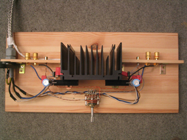

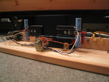

Some pics I took yesterday.
This is how my gainclone looked at before adding the sub to the system.
