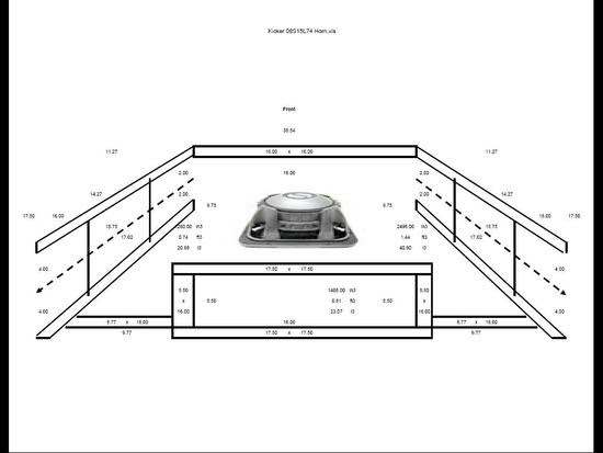

here's an image which I bumped into at Pininterest
