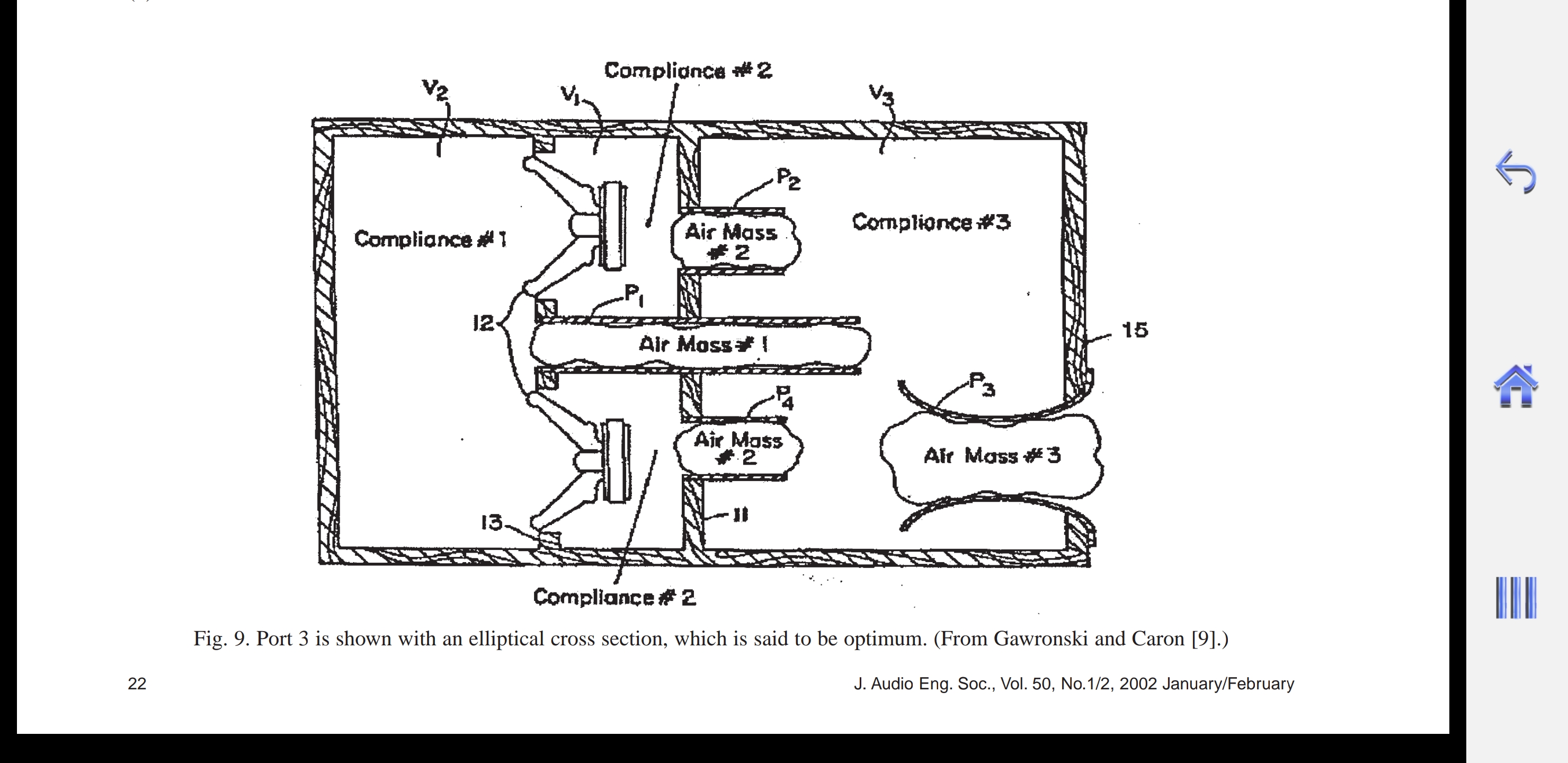

"port rectifcation" is mentioned in this paper
http://mariobon.com/Articoli_storici_AES/jbl/JBL_2002_AES_Reflex_Ports.pdf
Wow, this seems to be a really interesting paper, thank you Freddi ! Lot of thing well explained and not a lot too hard to understand for me. Two port with inverse flare in/out shape can make a thermal circuit, i wouldn't have imagined it.
This enclosure looks VERY interesting!
That's basically what the Bose AM5 Series II bass module looks like inside.
I see why they call it a bass module instead of subwoofer. It would be interesting to see like a 12" version with an F3 of 20-30hz. I can't believe those 5.25's handled 790 watts without bottoming out.

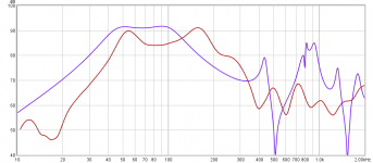

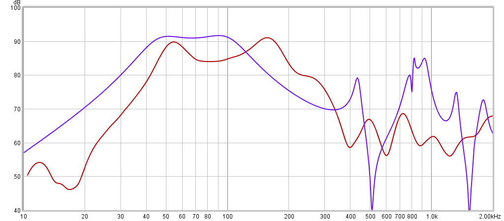

BTW, SR's quoted response for the AM module seems very similar to what I measured. "There were two points of maximum output in the range of the bass module, at 120 and 55 Hz. Between 50 and 250 Hz the output varied only ± 3 dB. It fell off at about 24 dB per octave below 50 Hz and at a remarkable 50 dB per octave from 250 to 330 Hz. "
In red is the measured response of the Bose AM7 module, and in blue is the predicted response of "Enigma 2", my intended rebuild.
