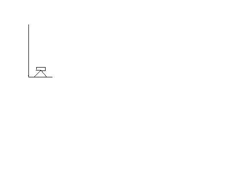

Thanks to that amazing piece of software 'The Edge' I've made a simple Q&D OB. The Edge had the driver placed closed to one edge of the baffle, & although I was sceptical about this I tried it, and it worked amazingly well.
Now I want to know why I can't make the baffle like this?:
after...
Immediately noticed an 'enclosed' feeling to the sound, not as good as the flat baffle (need to do more listening). Ameliorated a little by turning the corner to the front. Tried swapping L & R sides - immediately noticed an improvement in low end; so my time wasn't wasted. So for asymmetrical baffles, the long side should be on the inside?

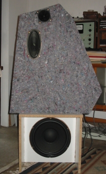

...the result...
added a piezo for some sparkle, & xo'ed (6dB/oct) at ~130Hz to a Hi-Q (Qts = 1.46) woofer, using the loudness switch on my amp for EQ.
Only prob is that the Sony (#125-11) can only handle 4W, so breaks up a bit if I push the low mids, might try a higher Xover
Initial impressions - very natural balance on jazz, I like it. Gonna try something similar with my Peerless drivers.

yep,
Hi Dave,
I'm using 115uF, might cut it back to 68.
On further listening, I'm still very happy with the balance, although the Kick drum doesn't hit you in the 'nads, the speaker has a very even sound, particularly for Bass, all the way down. Fs of the woofer is 33Hz. I'm amazed by the naturalness of the piezo too.
