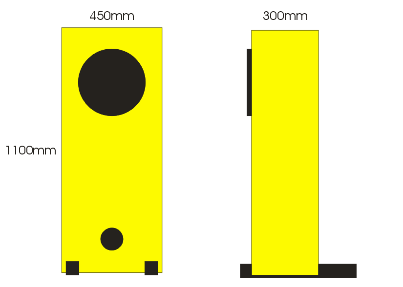

Hi, that's very good looking speakers and I don't blame you wanting it cloned. Still, the bass otput of a Qts =0,48 unit in an OB won't be spectacular and will roll off early without active EQ. If I were to do it, I'd consider building a vented box version with one beta 12cx driver and a solid compression driver, put in about 4 cuft and match the aesthetics to Spatial product. The crossover shuld not be a problem if you apply the usual design rules that have been discussed here thousand times. Without measurement there is no point to build anything, imo.
I won´t do this with two of the Beta-12CX. If you want to go in 12" and Eminence choose 1 Beta12Cx on Top and the Alpha12A for Bass, crossed at 100Hz and 2500Hz. This might be a better solution.
Hi, my name is Marco from Verona Italy.
I have bought the speakers for cloning M4:
1 Beta 12cx and 1 beta 12A2 at this point the problem is "crossover", any suggestion or help? Thanks
