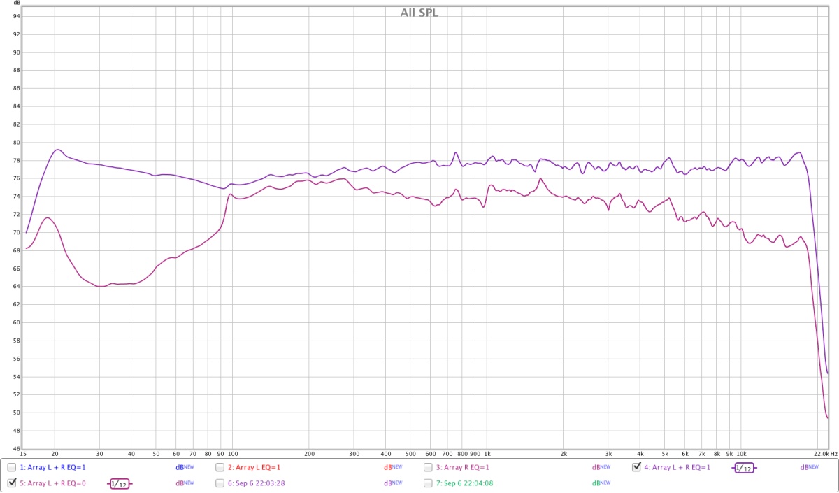

So far, I have hooked up the iNUKE 3000 dsp to a zone 2 preout on my current denon-X2100W (Ended up going with a Denon-X3300W which comes tomorrow rather than the Marantz SR6010). I have a UMIK-1 mic from minidsp and using REW for frequency response curves.
I was able to get a fairly decent curve with the iNUKE EQ. However, with the heavy bass boost (+15 db between 30-40Hz) the lights on the iNUKE light up at a decent listening level (85 db maybe?). My wiring is set up for a system load of 12 ohms. At this level, the iNUKE can produce about 210W RMS. If I wire them for a 3 ohm load then the iNUKE can produce about 850 W RMS. From a power standpoint, the 4x wattage will get me 6 db more in terms of output, but will the impedance change also net me 5 db more from sensitivity gain? or is that just allowing the amp to pump more power and only get 6 db more? I also hope that using the main zone preouts on the new receiver will output a higher voltage that the current zone 2 ones, and I am guessing that would require less amplification. How much? I do not know...
I have not measured any impedance curves yet (still have to try and figure that one out). How would the added fiberglass insulation (I assume the 3-4 inch stuff that goes in your typical wall) affect bass response? Less/More boost needed?

The change in impedance will only affect the load on the amp and the power it can produce into that load. The sensitivity remains the same.
Most receivers and line level devices work on fixed voltages. Most DAC's and CD players put out 2V for a full scale signal on unbalanced lines. Balanced connections can be double or more. Some cheaper consumer devices are only 1V though. Check the manual for your receiver and the one you are looking at, chances are the line level will be the same.
Check to see if there is a specification for sensitivity of the amplifier as this will tell you how much voltage you need for maximum power. The higher the input voltage the less it will need to be amplified but there are limits to this and too much could clip the input stage and may well make the dsp section clip as well.
The more boost you apply in DSP the more you reduce headroom in the amplifier and clipping will occur that much sooner. Hardware DSP's need more careful gain control as they don't always use as many bits for the calculations as software, limiting the internal digital headroom.
Be careful if you rewire for 3ohms because you will then be able to turn the volume up on your amp much more. As I said in other threads with a lot of amplifier power available it is possible to go over the thermal limit of the driver. Heavy EQ boost soaks up power and reduces overall spl. You can increase spl by adding more and more power but only up to a point. The curve is exponential and to get 3dB more output power is doubled and before long you have cooked the drivers and it still isn't as loud as you want and your amp might not have clipped either. To get that 15dB back it takes 32 times the power.
You will benefit a lot from fully stuffing the cabinet. The damping material will make the enclosure seem bigger and will make the cabinet more efficient which gives you some of that headroom back. The damping will also help to reduce standing waves and reflections in the cabinet internals. The type of damping you have used is more suitable for a reflex enclosure.
I posted quite a few graphs in the "wall integrated" thread that will show what to expect from a change in effective enclosure volume.
