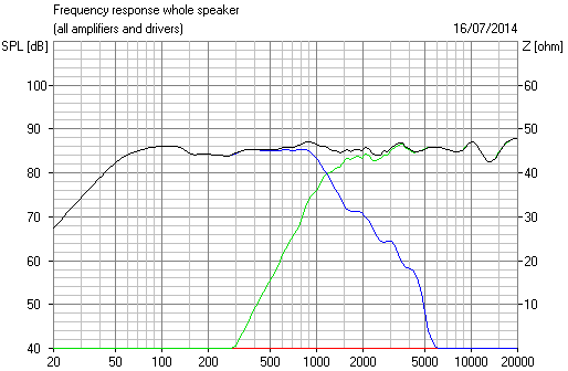

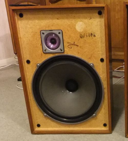

12" bass plus tweeter is actually a rather good design. It's also quite hard in some respects because of the low crossover required, which makes demands on the tweeter and it has a lowish impedance on 8 ohm drive units. The 1969 LEAK Sandwich was a design of this ilk. It's frequency response is simulated below. Dispersion and phase is actually rather good, which is a surprise. 🙂
The Wharfedale Melton 2 was similar, and had a good sound too. Definitely not garbage! 😛

12" plus tweeter does tend to blow the tweeter though. The 12" is very loud, and not many HF units or 3" fullrangers can keep up with it. Wharfedale tweeters were notorious for frying.
A better approach is to wire two mids in series for 16 ohms, and add a tweeter to help the top end dispersion above 5kHz.
Which is near to what the very lively late 1970's Wharfedale E70 did. A speaker that many people admire.
Is that a two way improved, or a three way? It IS second order electrical filters. 🙂

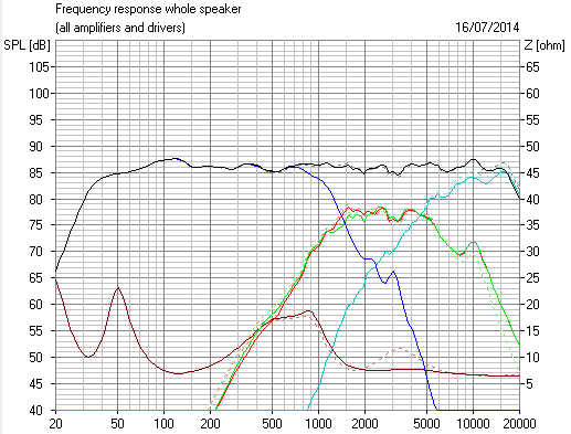

Thing is, if you sim it, it works out better than any other three way I can think of! Power handling is excellent. Even phase and impedance is exceptional. All on a simple crossover. My flatmate had some, and I gotta be honest, they blew the socks off my 3-way BBC monitors. 😀

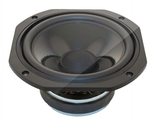

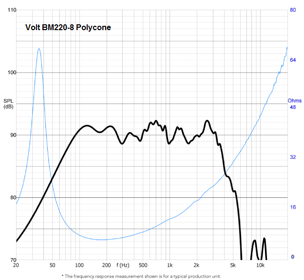

As it goes, Graham are doing a good job on an LS5/9 with a smaller Volt 8" polycone and the Audax TW034 tweeter. A lot of equalising needed though.
But I see no reason why you can't use an 8" or 10" or 12" paper bass. It might be a lot simpler filter really. Most of them are quite well behaved. 🙂
