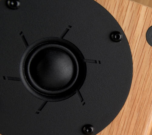

It looks as if they (PMC) have made some kind of custom faceplate that they mount over the top of the tweeter. It is marketing BS, something to cover up the identity or mounting hardware, or some attempt at controlling diffraction effects - I don't know.

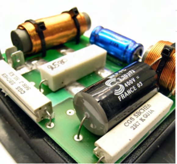

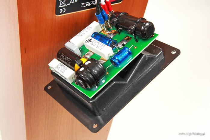

I've found two images of interest. The first is the FB1i XO extracted from a PMC brochure. The second is a GB1i XO from a review site, a similar speaker in that it's a two-way with the same XO frequency and uses the same tweeter.

I suspect the answer is as simple as that. They haven't changed the size of the pcb between the FB1, the FB1+ and FB1i so that's one clue. And if the main change is really to have lowered the XO from 3kHz to 2kHz then there's not a huge amount that will have needed to change. The L-pad may well have been adjusted to match any changes in sensitivity between the tweeters of course.

I took a look at the XO in the back of my FB1. I can confirm that it's an electrical 2nd order XO on both drivers.
Tweeter: input filter is 3.0uF, 0.74mH 0R63 coil, then a 2R7 series pad to the tweeter
Woofer: input filter is 1.27mH 0R6 coil, 20uF, with a 6R8 in series with the cap.
The coils were not laminated (ferrite ?) and I measured them with a hand-held meter in-circuit.
The pcb looks the same as in brochure photos of the FB1i except for an additional resistor (my pcb has extra holes that are unused so it must be a somewhat generic pcb they designed). The size of the inductors in the photo of the FB1i XO look very similar too but the film capacitor looks slightly larger - in the photo it looks like 3.3uF whereas mine is 3.0uF but it's not easy to read from the photo.

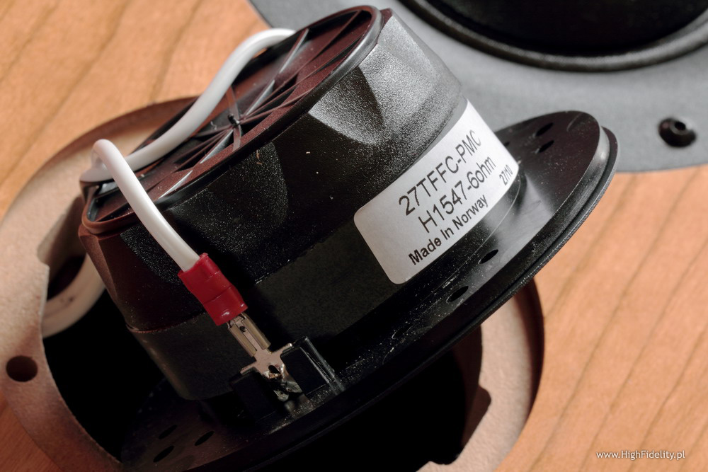

Price isn't everything. The 27TFFC is an excellent tweeter that gives many far more expensive units a run for their money and it has been highly regarded for years. However -it does have some rising HD2 around 6KHz - 7KHz IIRC which may be why some like it & others find something a little off kilter. In which case you may wish to consider an alternative which doesn't have this characteristic.
Price seems to be a very poor indicator of performance when it comes to tweeters.
The the overall best tweeter Zaph has ever measured when he was still publishing his tests was the Vifa D26 which costs under £40.
Everywhere where it counts it outperformed all comers from $200+ domes to ribbons.
To their credit ATC know a good tweeter when they see one and used it in their SCM25.
When I found out the surprisingly cheap tweeters used in many pro monitors I had a closer look at them and what I found is that the one thing they have in common is an exceptionally clean CSD.
