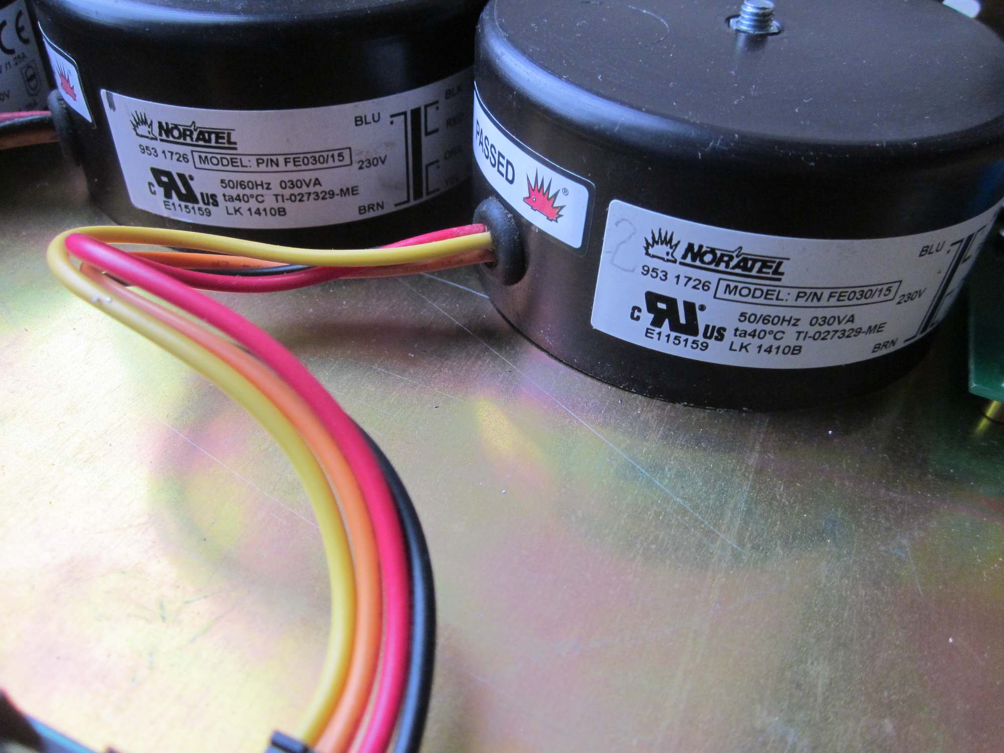

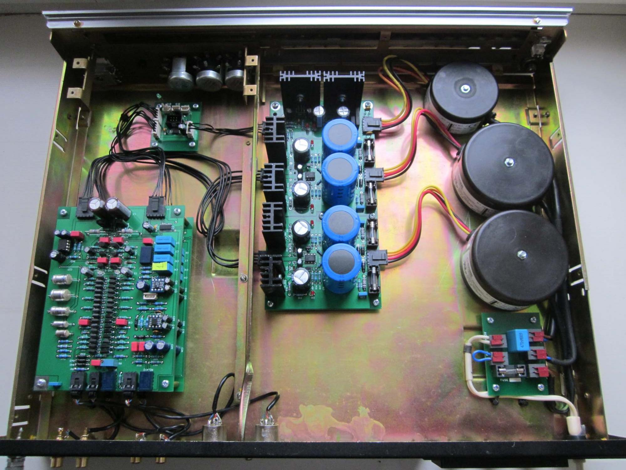

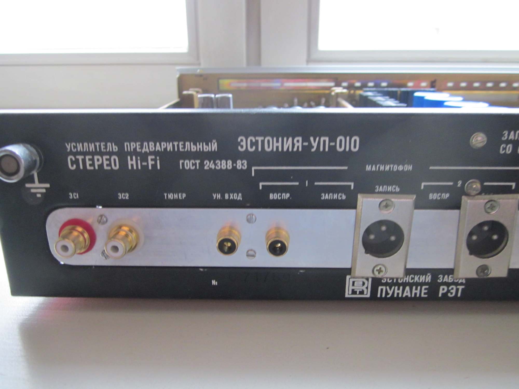

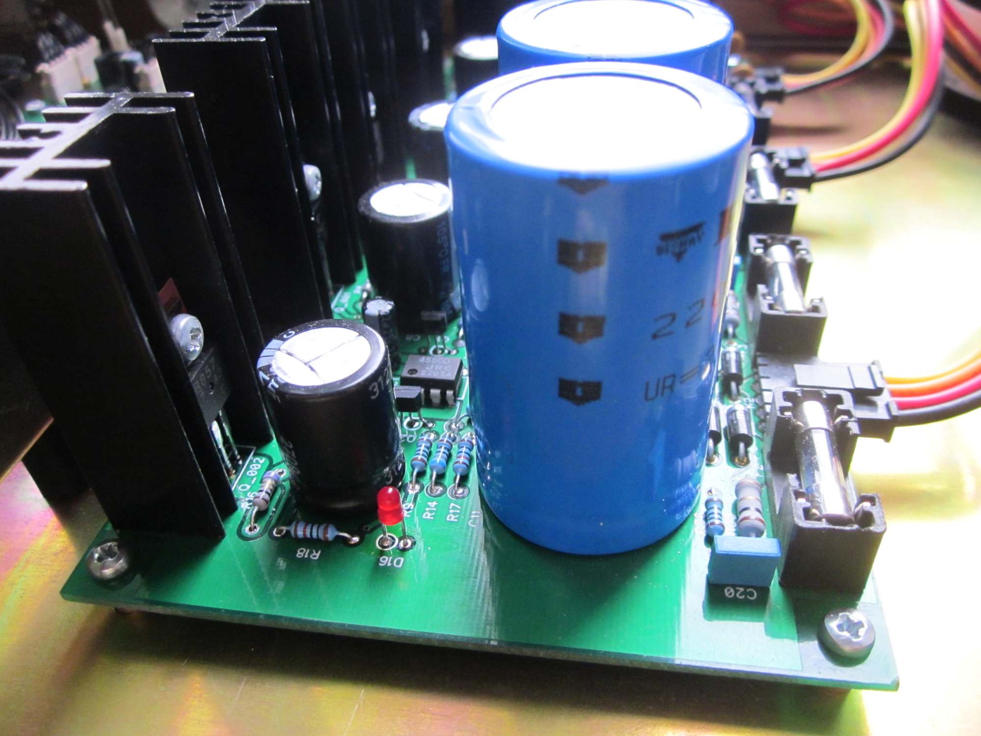

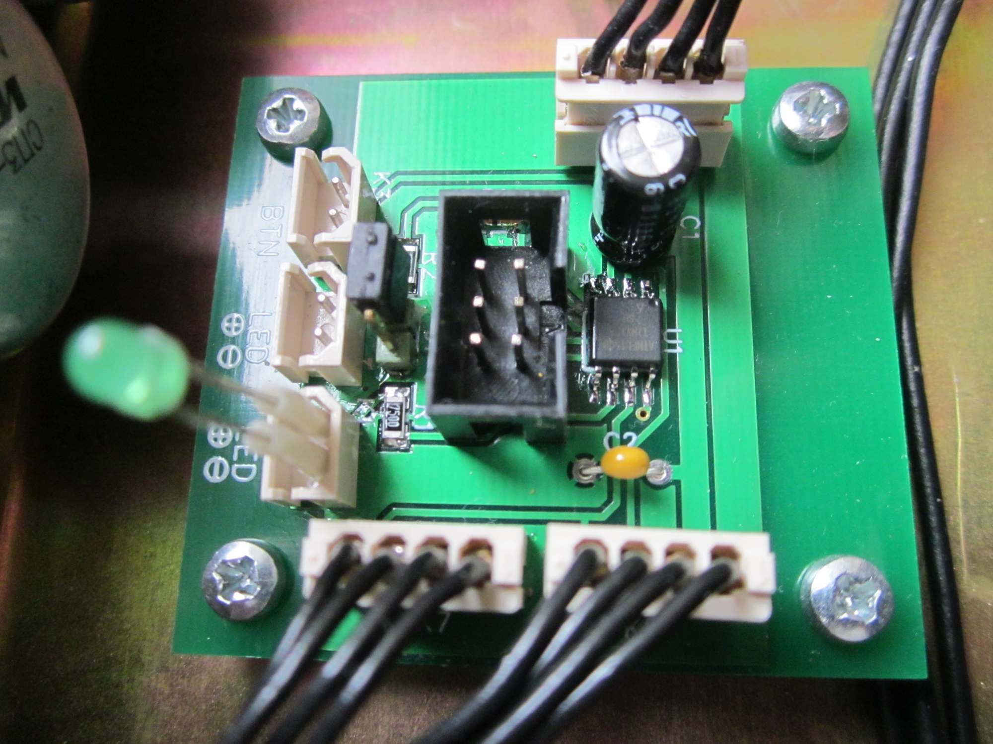

just photos of my implementation of great Accuphase phone-stage C-27. I call it Project C-28 because it has only MC-section and there are some small changes in schematics compared with the original one. As for the sound - it`s great! Really.
I hope this may encourage someone uncertain in his forces in repeating the project and enjoy the great variety of music 🙂

1. I had to make PCBs myself because I use only MC-section of the preamp. It`s quite hard for the beginner as I am to repeat the full preamp. Yet I don`t need MM-section.
2. I can share them without any restrictions, need only to find them on my PC. As for the BOM I don`t promise it cos don`t have all in a single file, but will give references to very specific components. Guess this is not the main difficulty. Anyway ask your question here.

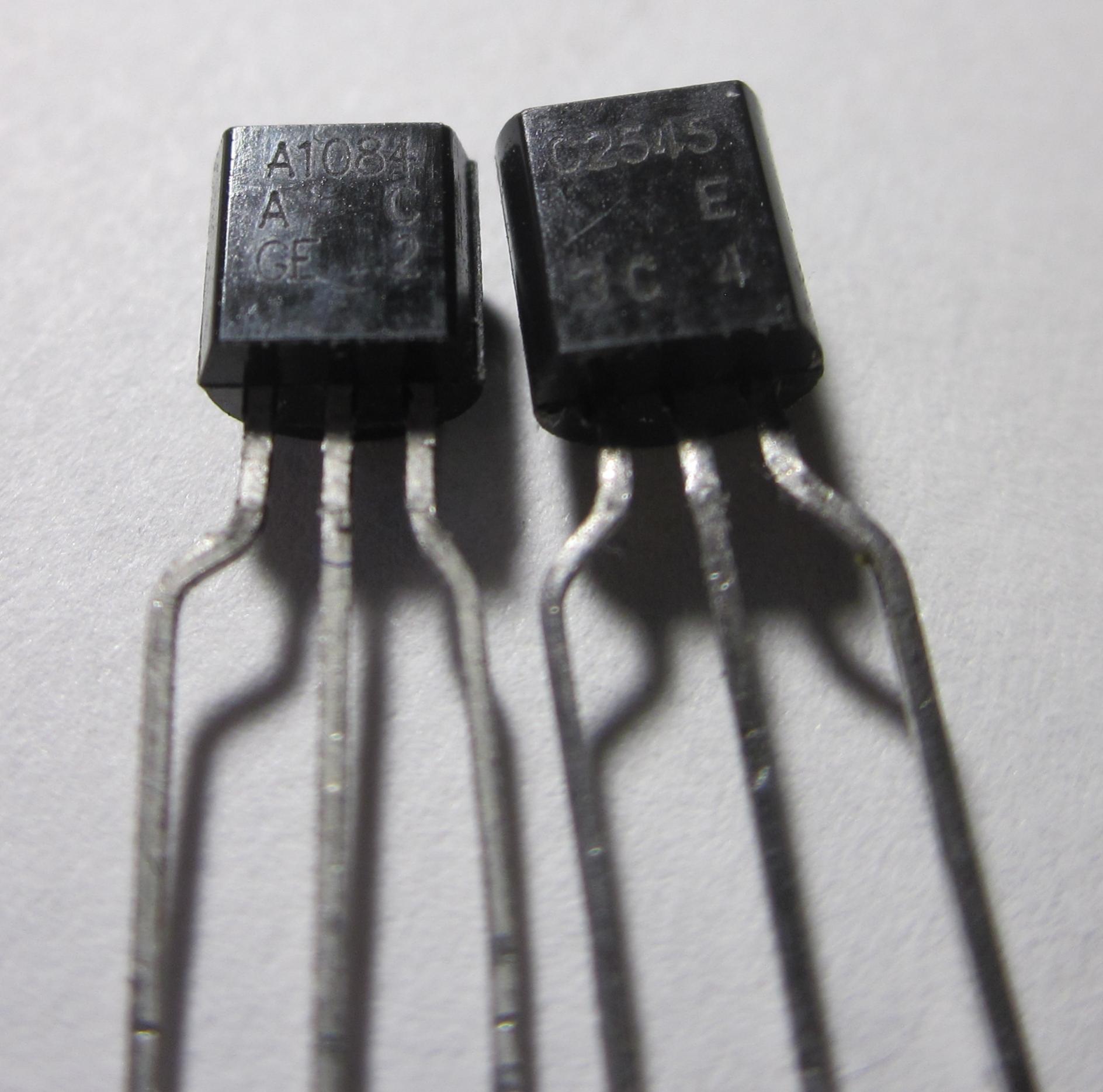

They are still available from Futurlec, I bought them and some others namely there.Very interesting voltage regulators. Low noise transistors are out of production.
Which gain group? How do you know they are no fake?They are still available from Futurlec, I bought them and some others namely there.
I never claimed they are not fake. But I hope they are not. See the photo.Which gain group? How do you know they are no fake?
