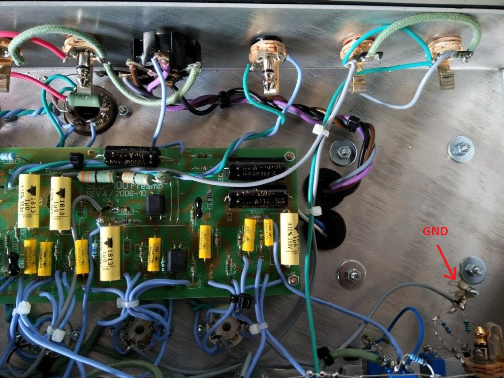

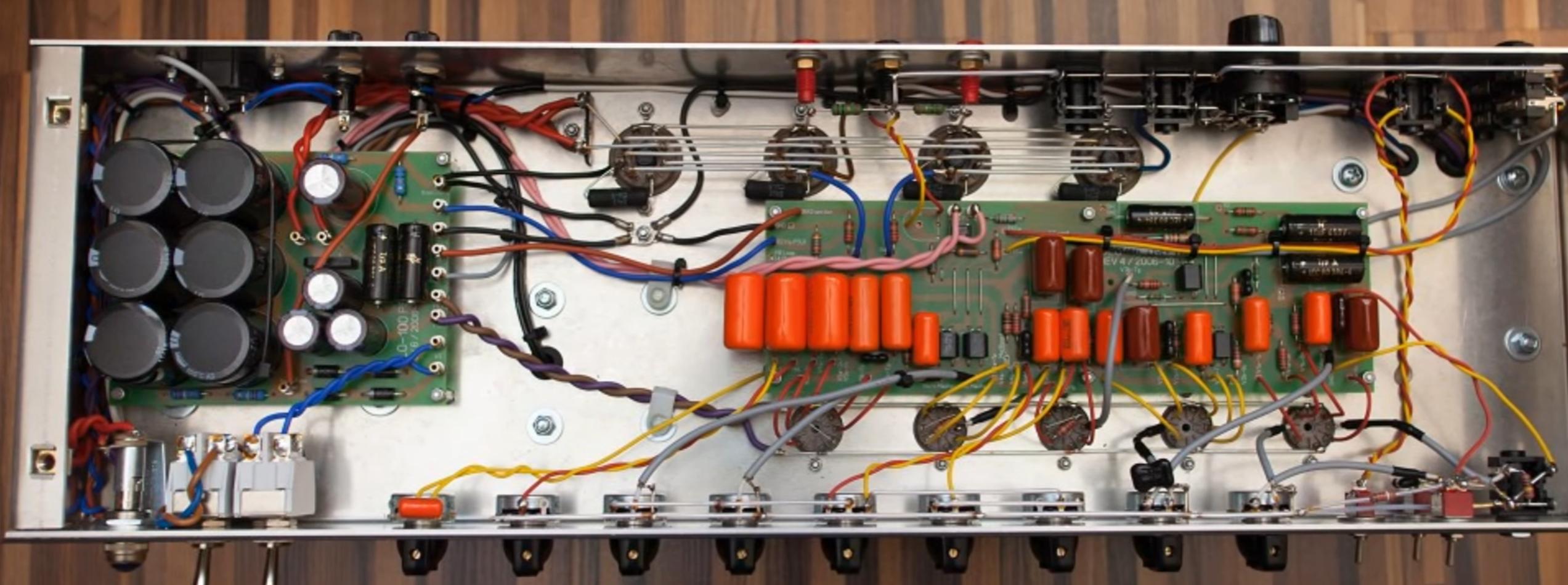

Soldano SLO100 - Overdrive
I built a Soldano SLO100 replica based on the circuit attached. I used a Tube Town PCB for the circuit.

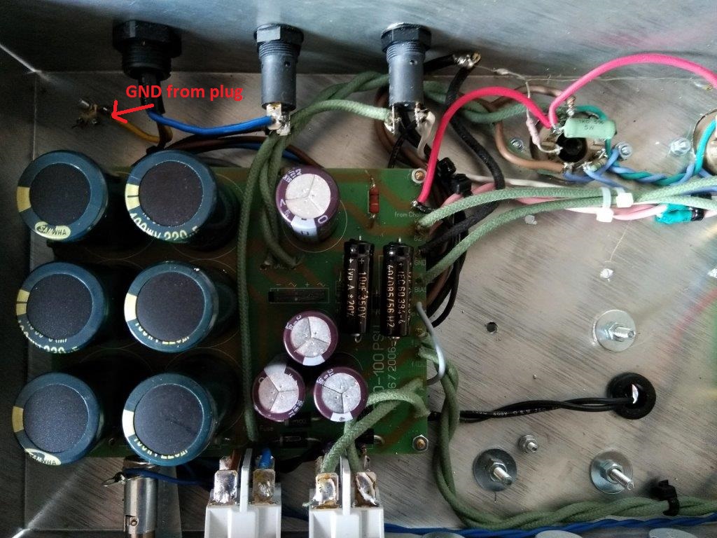

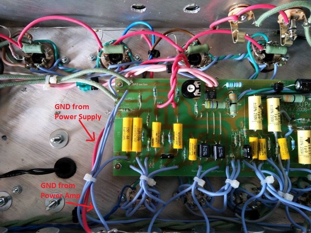

I also followed some tips regarding grounding. There are two points attached to the chassis
1.- GND from power cord
2.- Circuit GND. This one is as closed as possible to the Input Jack. I used a bare cable to attach the different grounds from the circuit. I putted the Power Supply GND at the end of the bare cable, together with the Power Amp section
The amp works perfect, when I play NORMAL the sound is very clean and the hum is incredible low.
If I put the PRE-AMP OVERDRIVE Knob on maximum and I start to increase the MASTER OVERDRIVE, at some point there is a huge distortion noise coming from the amp. This is without the guitar connected.
When the guitar is connected, there is a feedback when I start to increase the MASTER OVERDRIVE.
I know this is a high gain amplifier, but I was not expecting all this noise coming from the amp.
There is anything that I'm missing from the built? Has anyone built a similar amplifier before?
Thank a lot, any help will be appreciated 🙂

Just for testing purposes, pull v2 and see what happens. I'm guessing that is where the feedback is coming from given the symptom description. If you have any, try a few lower gain tubes (12au7, 12at7) in that socket. There are a whole lot of places for signals to weasel their ways back into that spot. Lead dress and layout are super susceptible also.
